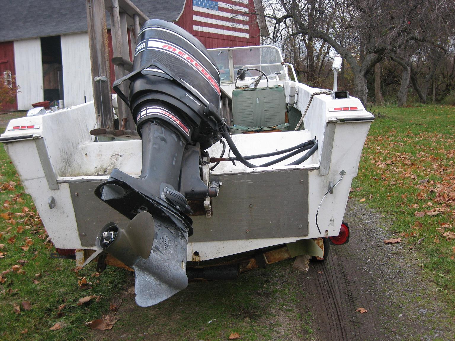

I did pick up the merc I was after, It was on a 1969 Renken Tri Hull and had two 23 pich two blade brass props with it. I am fairly new to this and I was wondering if these are props you would usually run on a boat like that?

. I would say the 23 " props were too much pitch for a tri hull boat. Just some thing the prior owner got from a seller. Nice for show to polish up . "Chinewalker" up in the 1000 island area, believe had a comment on the older Mercs that Daily use of a heavy brass prop adds vibration to the lower bearing / seals.? May just use for special occasions. The boat should always have interest to local fisherman / teenagers on cheaper budjet. Some other speedster will come along for ya... Not to stir a old pot , BUT if Frank / Brian still have the Custom Craft Manta Ray project hull ,This would make a SWEET show / club package. I had a interest a few years back.

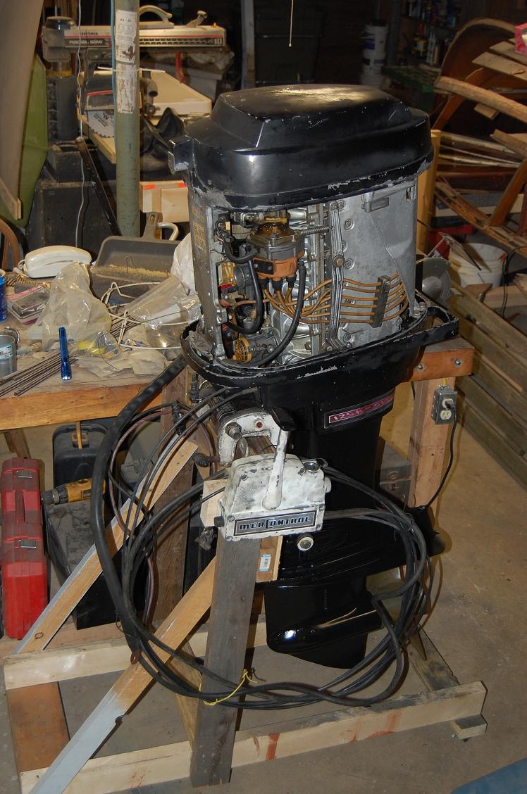

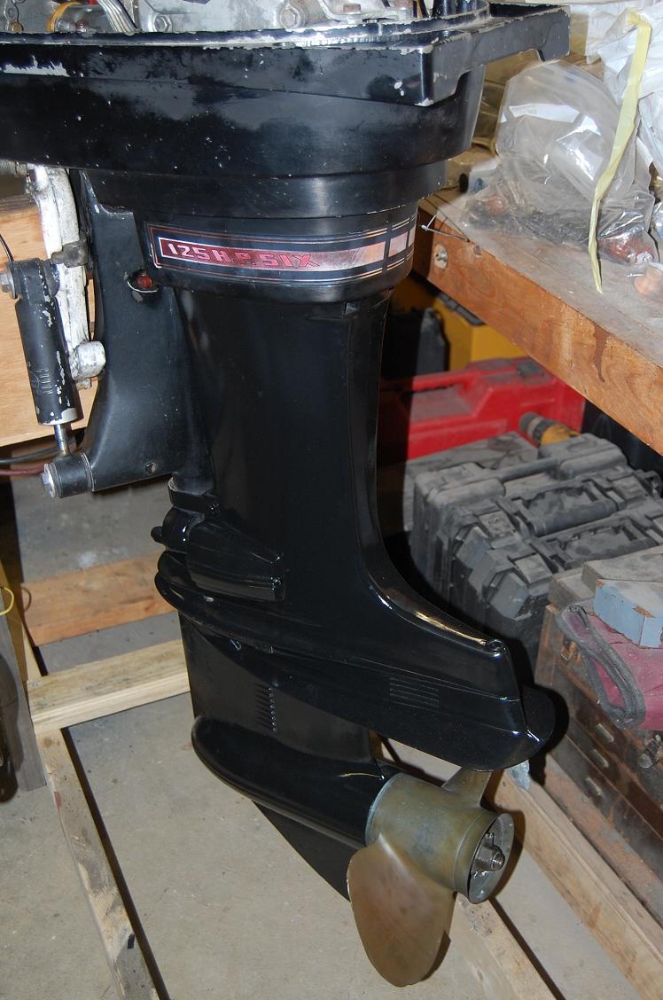

Well its been a while but I got the 1250 controlls all rewired with a new ignition switch and finnaly gave it a compression test yesterday 122 PSI -> 125 PSI on all cylinders. Gave it a new waterpump and some paint ( last couple Months) and fired it up. Sprang to life with a nice stron Tell tale and sounded good. ... Painted the lower unit now I need to make the rest match...

Motor is looking good! A curious thing about the 1250's is the WOT timing actually get's slightly retarded if you are not careful how it is set up. 1250 is the only model/year with that linkage to the distributor along with a factory tension spring on the side. So be careful setting it up.

Looks like a pretty hefty tri-hull. I'd start with a 19 pitch 3 blade aluminum and take a tach reading at WOT. Looks like a 40 mph rig.

Rattle Can wonder Rustoleum..!.. I hope it holds up ok if not I will get better paint and redo it with my sprayer. too cold out in the barn for that now though..

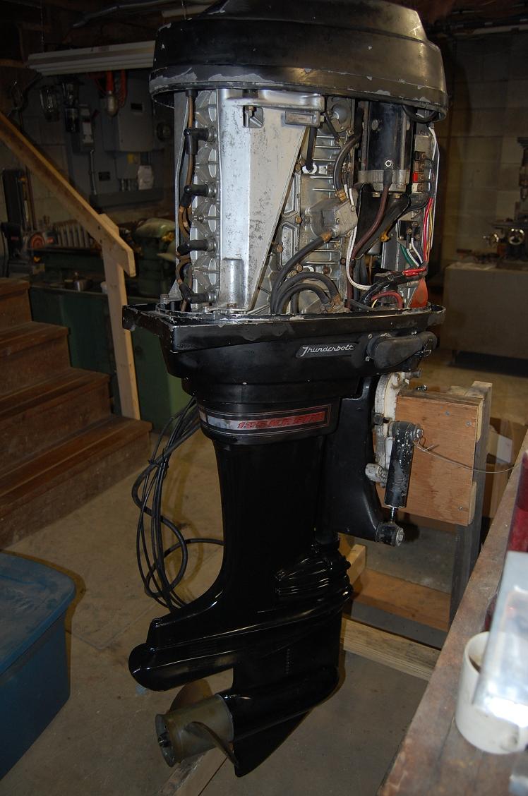

1968 Merc 1250 Tower Running and some questions. 15 years 7 months ago #27472

Ok this is my first Attempt at a you-tube video or uploading one on here. I am uploading this because I am curious if anyone has an idea why it is blowing a mist of water and oil from the ... Leg? mounts. forward to the transom mount. Otherwise it seems ok, I had too much oil in the mixture for sure having it was the second run after sitting for 10+ years. On the compression test all cylinders were 122 or above. so yeah thats it really... Any ideas on the misting would be great.
Re: 1968 Merc 1250 Tower Running and some questions. 15 years 7 months ago #27476
There are rubber seals on the upper two mounts. They are old and leaking. You have to pull the power head to get at them. It really does not affect things, but will mess up a clean motor over time.
