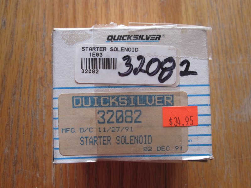

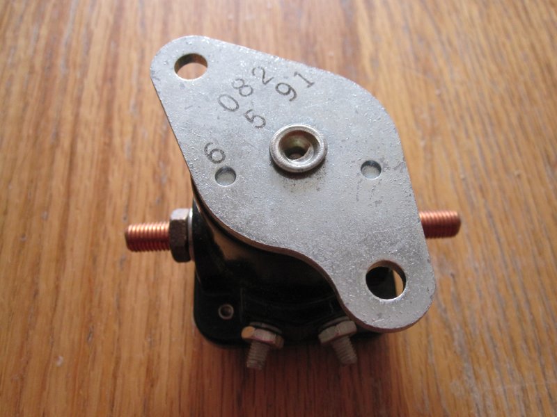

My new oem solenoid should be in today, and I ordered a brand new voltage regulator, per Doc Frankenmerc's suggestion. NAPA had them in their Sierra line, so got one coming out of Syracuse, should be here today or tomorrow.

New solenoid arrived while I was typing this!
