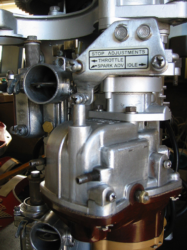

However, I do need to lower the idle a bit. Can anyone tell me how to adjust the idle down?

7/16 wrench & phillips screwdriver to make the adjustment while running in forward gear
I have reproduced the Mercury stop adjustment decals in photoshop
if you need to replace yours
download a copy and instructions here:
http://www.pfs-ware.com/WhitePapers/pdf/MercuryStopAdjustmentDecals.pdf
Re:Idle adjustment mark 35a 16 years 1 month ago #17235
you might have to adjust the throttle cable also.
