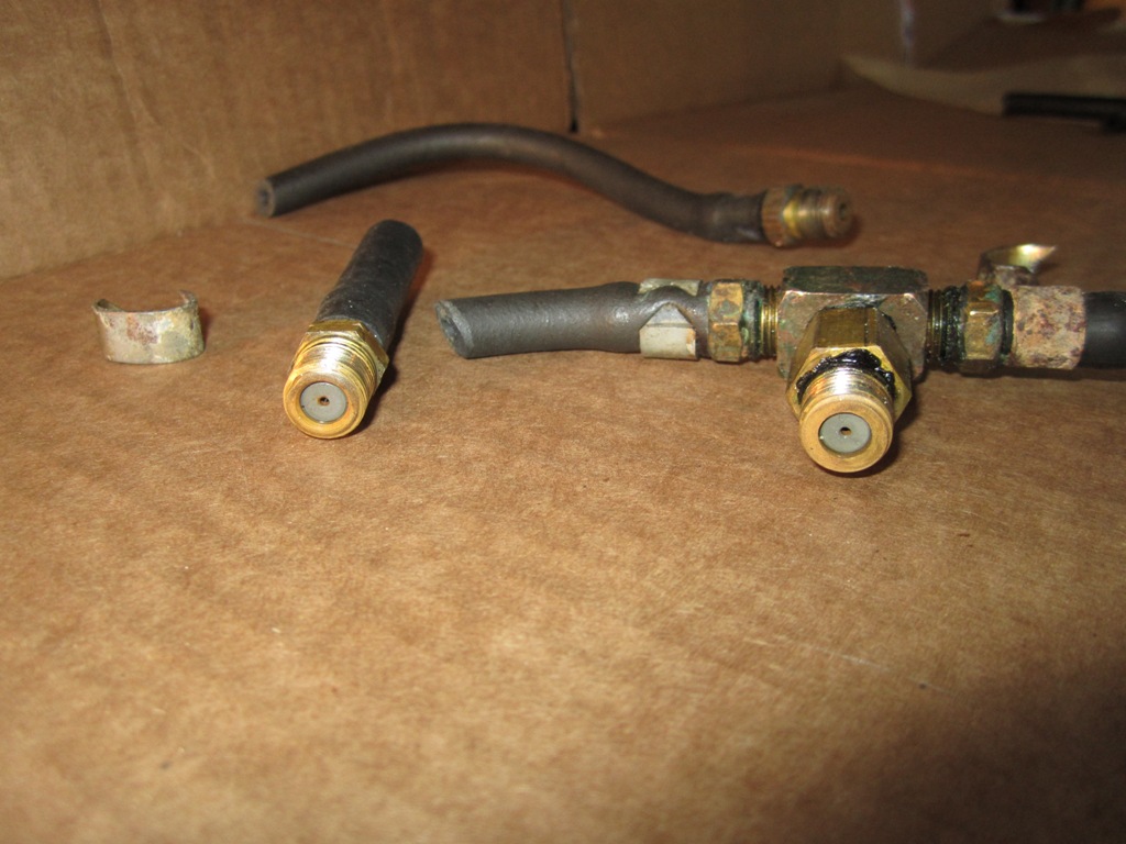

I have a 1961Mercury 800EL w/full shift and have had 2-failures of the cylinder bleed check valves.
Last Fall the motor would not idle and I found the cylinder #3 & 4 check valve seat loose and floating around in the tee connection. Put in a replacement from another motor and had no problems for a year.
Last weekend the same problem occured while I was out on the lake where she would start and run at high idle but dies at low idle and as soon as I put it in gear.
This time I checked them and found the cylinder #1 & 2 check valve apparently leaking through. I took one off another motor and it seems to run fine now although I have not checked it out on the water.

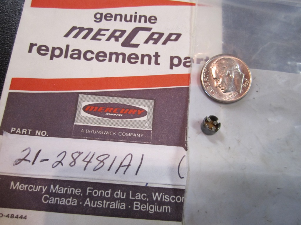

These are the valves.
Terry

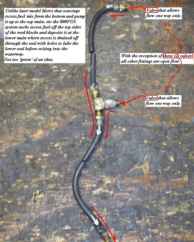

I was of the opinion shared by Peter in how the system should work, but I have discovered that the 800FGS way of doing thisngs is virtually opposite most other Mercs.
How crazy is that!
Anyway,...See the attached for 800FGS details.
I stripped the pieces in question off an original 800FGS block today.
With review of all this and to bounce back to the original question of can this system simply be blocked off - I would not.
Primarily because the 800FGS does not have a separate crankcase pressure balance system and this system doubles in that assignment.
Should there be any reason for this system to affect idle quality?
I'm with Peter in that I don't see how it would.
