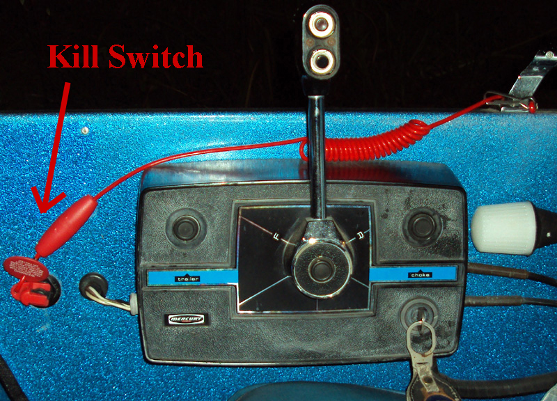

Get one of those switches with the RED Lanyard cord and plastic clip (see pic below)
Remove the ORANGE wire from the ignition switch. Run a wire from THAT Ignition switch terminal... to the kill-switch. Run the 2nd wire from the kill switch back to the original ORANGE wire...
Without the clip in place, the motor will not start or run. You are 'supposed" to clip the lanyard to yourself- in case you exit the boat unexpectantly... :ohmy:

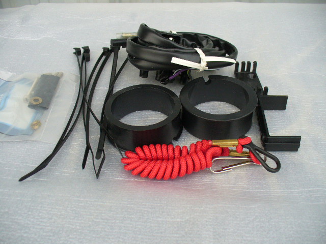

To throw our hat into the ring, we have a T-H Marine switch which flush mounts @ $24.99. This works with the second way above. Wiring to the motor from the switch must be supplied separately. We also have a Mercury Quicksilver stop switch kit @ $39.99. The switch can be surface or flush mounted (with the supplied components). A 20 foot sheaved harness is connected to the switch to reach the outboard. This switch can be employed with either connection way above.
Many stop switches, including both of the above, utilize a toggle switch installed to a plate which has an open end box. When the toggle paddle is down (activated), the plastic loop on the lanyard, can fall off. To connect the lanyard to the switch, place the loop on the toggle paddle, and push the toggle paddle up enclosing it into the box. The box retains the loop to the toggle paddle for proper motor operation.

Re:How to hook a kill switch to an old Merc? 16 years 1 month ago #16667
What's the pic of Joe, the T-H, or Merc? I like the idea, and once I get my new prop paid off will see what we can do.
