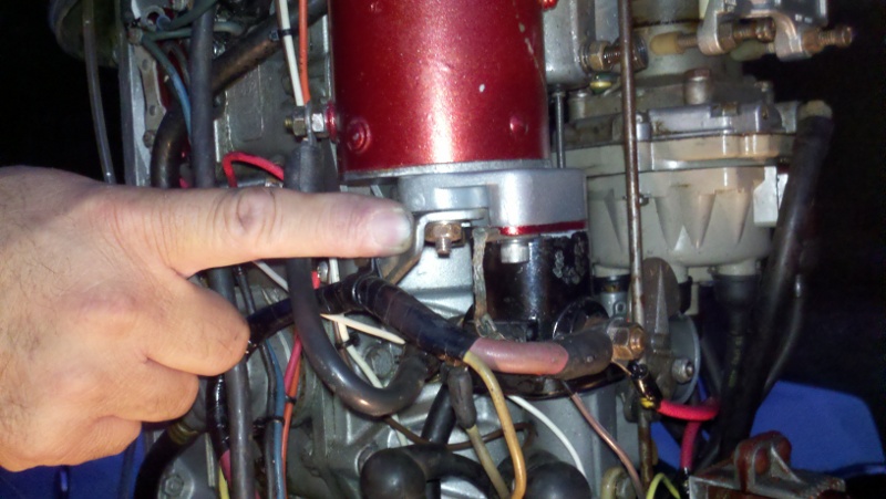

My solenoid is loose because I can't tighten this nut. I believe it is just turning the threaded rod it mounts on somewhere inside the starter. Short of pulling the starter apart (and then what?), any suggestions for how to tighten this nut?

Re: Starter nut tightening problem 16 years 1 month ago #16370
look up thru is there a screwdriver slot on the other end ?
Re: Starter nut tightening problem 16 years 1 month ago #16376
Push a small flat screwdriver blade above the wire connector so it "pulls" the stud down while tightening. You may be avle to get the stud to catch enough (inside the starter) to tighten the nut.
Next is to grab the exposed stud with diagonal side-cutter pliers, and use an open end wrench on the nut.
OR- Remove the nut if possible.. so you can get the wire connector OFF. Then re-install the nut and tighten it as indicated above until it bottoms- securing the stud so it no longer spins. Then you can use a 2nd nut to hold the wire connector.

Re: Starter nut tightening problem 16 years 1 month ago #16383
There is no wire connector on this nut. The nut is almost tight, no room to get a screwdriver in.
I'll probably try to grab the end of the stud as you suggest and see if I can hold it tight enough to turn the nut. Then I'll see if that works!
Thanks!
Frank
Re:Starter nut tightening problem 16 years 1 month ago #16752
Long bolt/screw Frank, check the other end.......
Re:Starter nut tightening problem 16 years 1 month ago #16755
Yes Jim, I know, but I can't see the top of the stud. I'm gonna limp by until I pull the motor for the winter, then take the starter/solenoid unit off and go at it. In the meantime I need to run an auxiliary ground wire.
Frank
Re:Starter nut tightening problem 16 years 1 month ago #16758
  • Neil
  • Neil's Avatar
  • Posts: 1997
  • Karma: 65
Is there any way to get a hacksaw blade in there to split the nut?
I wouldn't try a chisel for fear of damage from pounding, but cutting parallel with the stud may get it off.

Re:Starter nut tightening problem 16 years 1 month ago #16781
I carefully gripped the end of the stud and the nut just turns in place. It's stripped obviously. I will disassemble it over the winter and fix it. I have a back up starter to rob or use if need be too.
