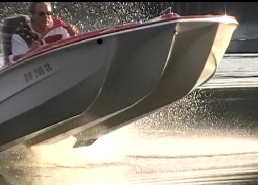

Last night we were out doing pictures and videos of Brian (crosbyboat) Lawson's Glen-L Missile with his short shaft 1350 and me with my Power Cat and standard shaft 1000. Boat ran great, but I made two mistakes - #1, I turned the boat off in the middle of the Hudson River, and #2 I didn't have any tools on board. When I turned the motor off, I couldn't get it to start again. You could hear the solenoid click, but that was it. My 1st thought was I had a bad solenoid. Brian towed us back to the launch, and we got home in the dark, so I left it till this morning.

P.S. the boat looks OUTSTANDING in action!!!!! Love it!!!!!!
