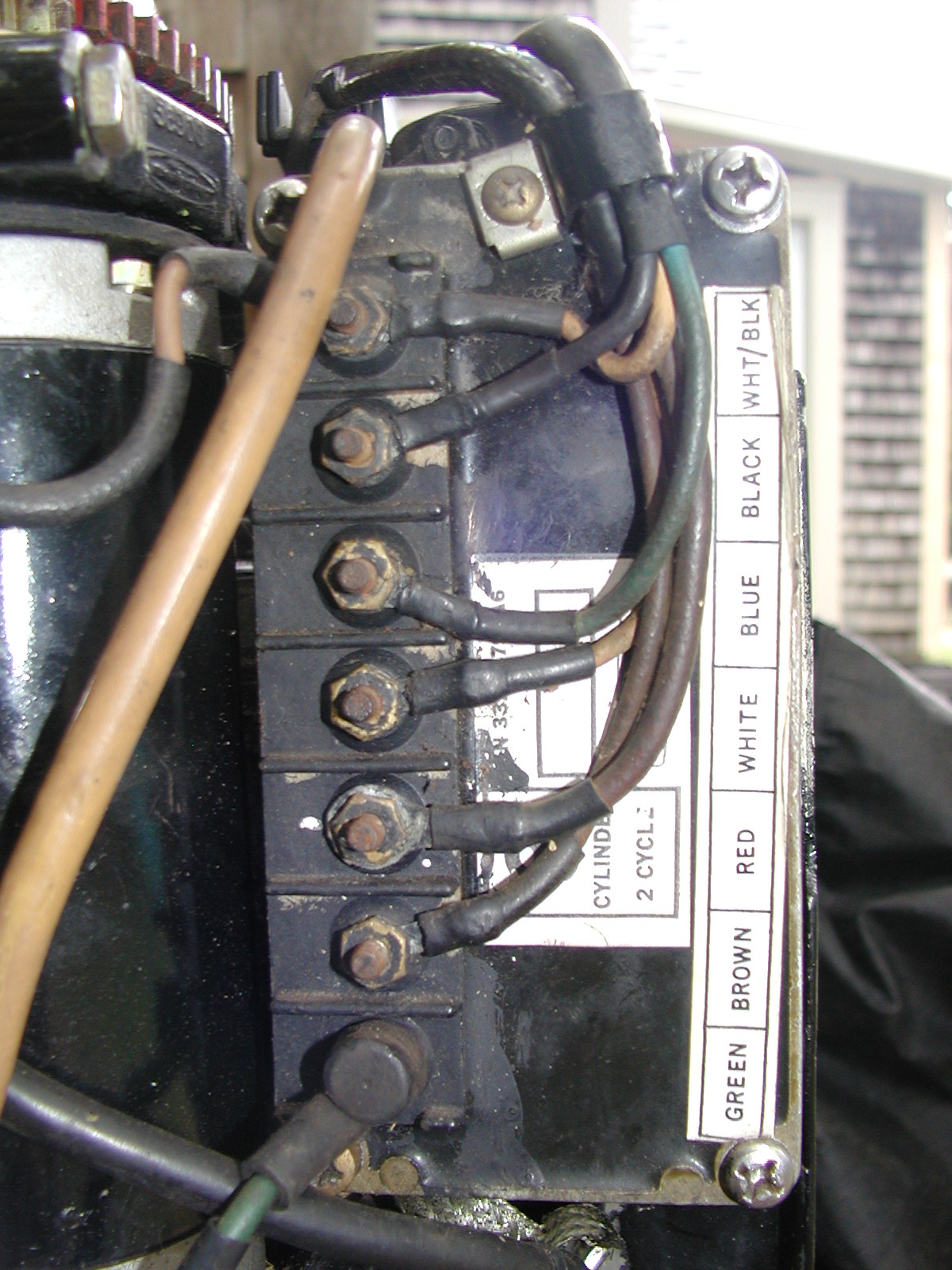

hi i just picked a 65 merc, the control box was cut from the wire but it is complete otherwise.i would like to "hot wire" it to see if it will fire,i have enclosed a picture of the switchbox,any help would be appreciated.
thanks
steve d.

You shouldn't need a control box at all to hotwire it. If you hook up some battery cables to the motor and jump the solenoid you should get spark... Not having battery cables hooked up will result in the rectifier popping...
If I'm not mistake, that motor has the funky plastic plug on the side of the motor, under the cowling, does it not? I don't think they used them for long before going to the more common cannon plug...
- Scott

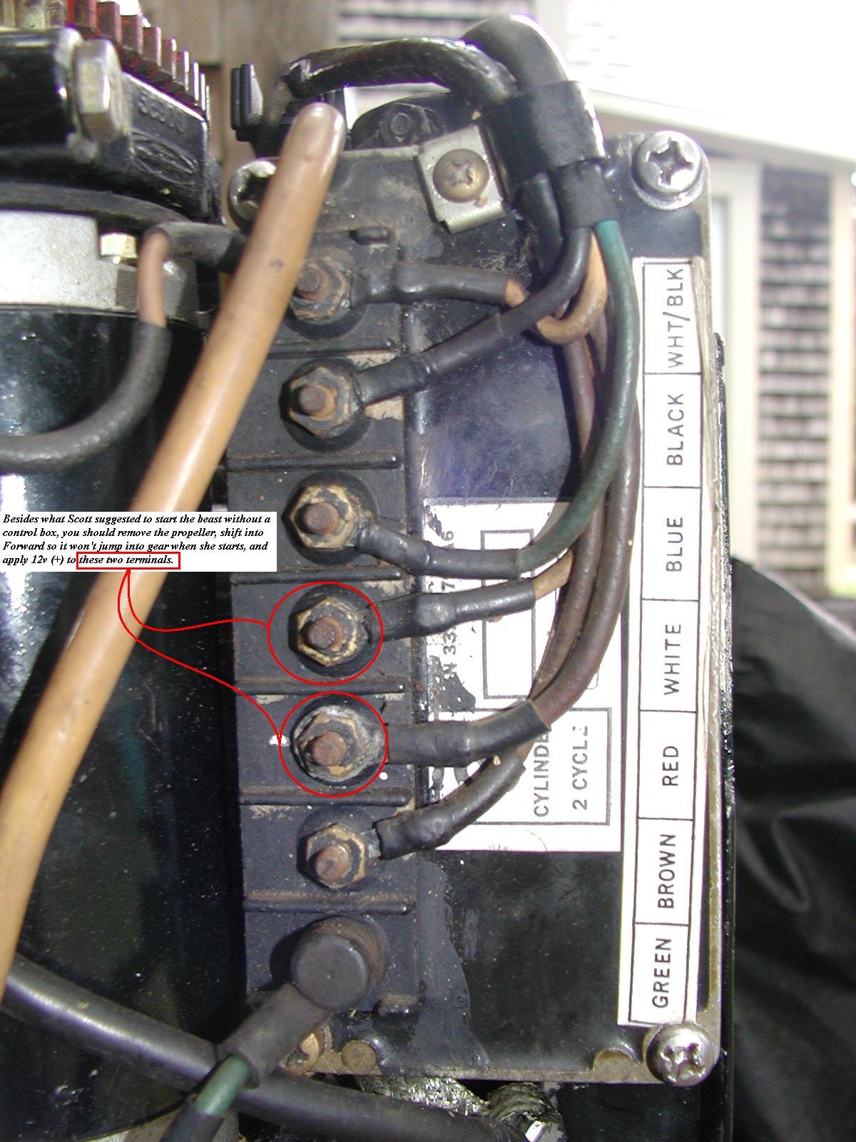

Steve,
See attached photo for details.
Thom

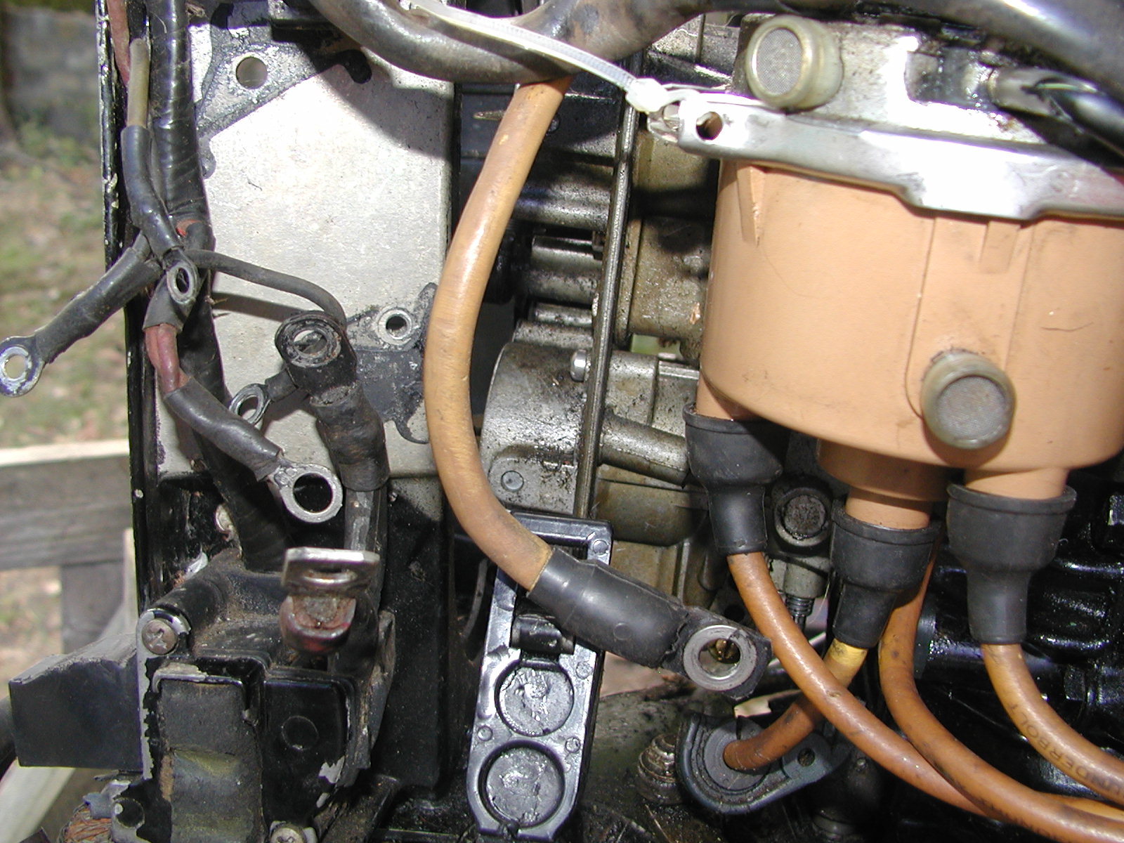

thanks for the replies and yes that does have the oddball plug on it. when i got home from work this morning i looked a little closer at the engine and i found some wires hanging near the distributor, looks like there should be a little box mounted there.i did turn the motor over by hand and it the top cylinder has no compression and it binds slightly when it reaches tdc on that cylinder.which cover should i remove to take a look at the piston, i'm wondering if it is something i can fix.
