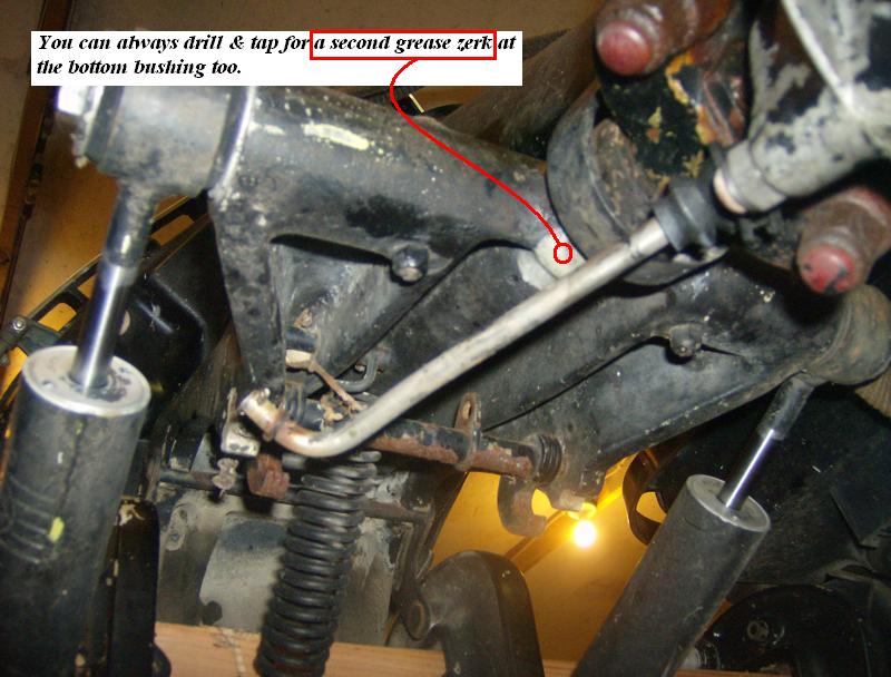

Re:won't swivel.....Merc 1000 16 years 2 months ago #14773
Matt,
You can also drill and tap a new hole for a second zerk at the bottom bushing.
Drill through the aluminum and through the bronze bushing (if it has one - some didn't) and 'dimple into the steel steering rod, but do NOT penetrate it.
Then tap with 1/8" NPT and install a second zerk.
There is no steering arm on your Merc so you will have to be careful just where you 'push-n-pull when trying to get her to swivel so you don't thrash the rubber mounts.
Thom

For those suggesting to disassemble...the motor is locked to one of the steer stops...so I can not get to one of the top nuts.
I thought about your idea but not going to work very well since I can't get to that one nut on top.
Thom I believe your idea may be my next step...for what I paid for this Merc....I have more time in it already....

Thom suggested me drilling and taping a zerk at the backside of motor? i want this to be last step.....

There is a pic here in this thread that Thom was pointing out where to put a grease zerk.
