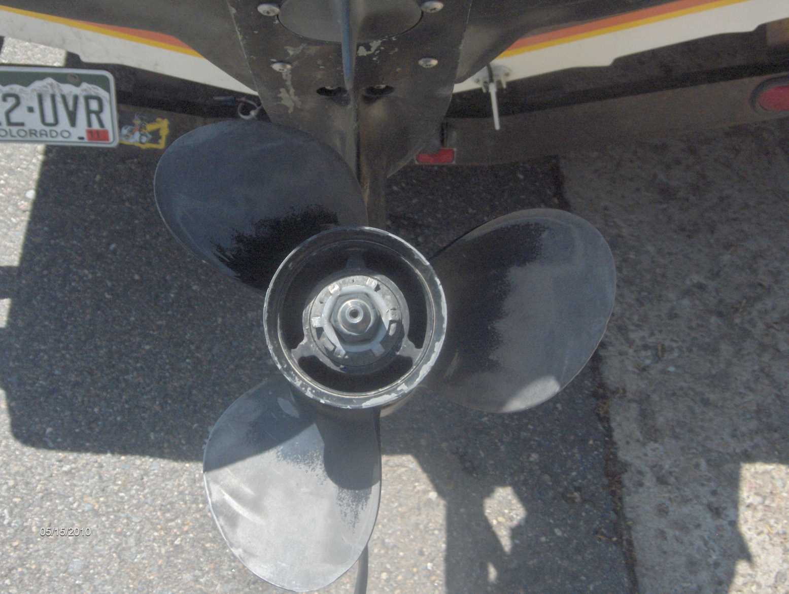

Thanks for the detailed responses. Here is a pic of the prop, I don't know what cupped means... taken in context I presume it means that the prop is curved in such a way as to scoop more water.
Its been repaired, and it looks like a few notches in it were patched.
Re:Prop Pitch and the Tower of Power 16 years 2 months ago #14451
Yes it is cupped as far as I can tell. Cupping is when the trailing edges of the blades around the tip are cupped upwards as you look at it here. It improve bite & can reduce cavitation on cornering. As Frank says there is a whole science out there on its own concerning props, but all the advice above is sound.
