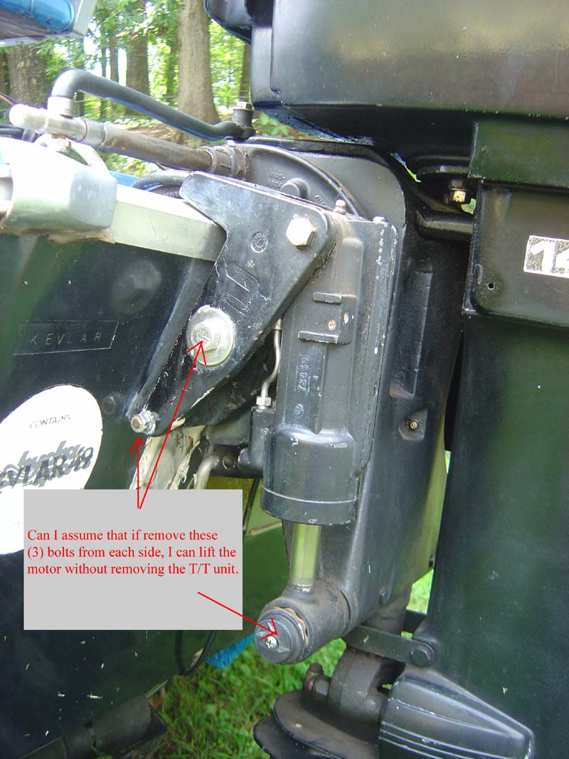

Back to the T/T unit... I got a chance to look at it in the daylight (home for lunch). See photo below...

In response to your question, yes, but is that bottom most bolt a thru bolt from one side to the other? Mine is.
Frank
Re:Lifting the motor from transom 16 years 2 months ago #13883
yes it is but it does not have to come out of the motor just the cyl brackets have to silde off.
