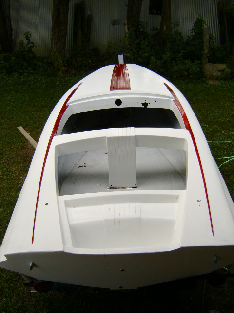

I need an engine to put on Ugly Peg,she is an overbuilt 60 G3. And she is real ugly. I have on hand a 66 merc 650 short in, well poor cond its been sitting for 20+ years, no lower unit, mag ign. I have a 69 long merc 1000, and a 72 merc 140. and 1 short lower unit I just got off of ebay. I think the 1000 pwr head will fit but will the 72 140?

Peg started this time with a 23" and I whittleteld her down to 19.5 to fit the McCulloch 75hp. Ive since sold the Mc so now Im needing another shorty to fit.
