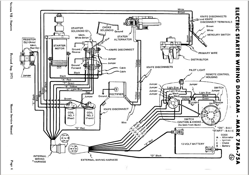

Yeah, can't believe it doesn't come with controls, those engines are pretty much useless without the proper control box and harness.
I saw a few on eBay that might work, but as I recall there is some sort of difference between the earlier MK75 and the MK78 controls. Or it might have been between the very early and later models. Earlier boxes had the Forward and Reverse limit switches and adjusters inside. The later controls that definitely aren't compatible, IIRC, have the switches on the distributor and not in the boxes.
See the attached wiring diagram for MK75A - MK78A. If the MK75 you're looking at matches that configuration, then a 75/78 control box should work. The earliest boxes were green with pushbutton on top; then came black ones that were otherwise pretty much the same.
My old 700E Dockbuster had a white control box with the starter button on the underside of the control lever handrest. This engine has the limit switches on the distributor. So if you come across a white control box, it won't work on that MK75.
