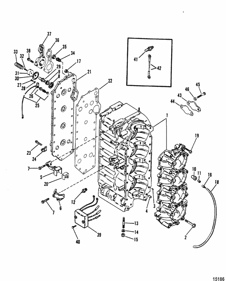

That gasket (#22) is a water jacket gasket, not a head gasket. Water can't get into the engine there. I'd remove the exhaust cover gaskets & look there.
moisture in number 2 cylinder. 3 years 4 months ago #148032

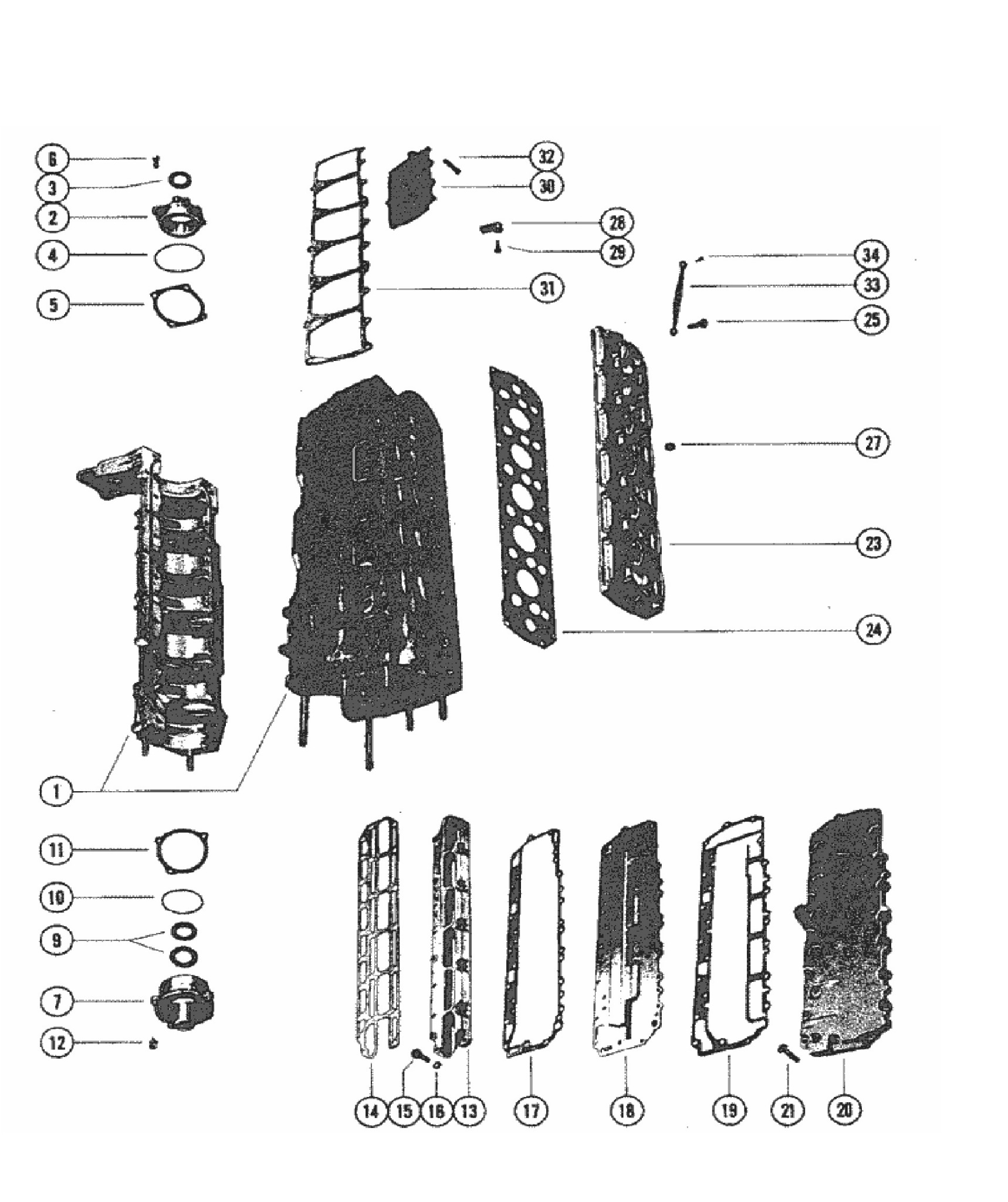

The 1979.5 115 is an inline-6,...Not related to the posted image by Jim.
Ideally, replacement of gasket 14 "might" resolve the issue, but I strongly encourage replacing 14, 17, & 19, plus insuring the "water Jacket Cover" #13, is not warped, or corroded,etc.
The "Exhaust Manifold Baffle Plate" #18, also has to be carefully inspected for corrosion pits/holes, too.
This is not an easy task, and short-cuts will commonly result in the water intrusion rearing its ugly head again.
If you see cracks between the exhaust ports, forget spending money on the beast.

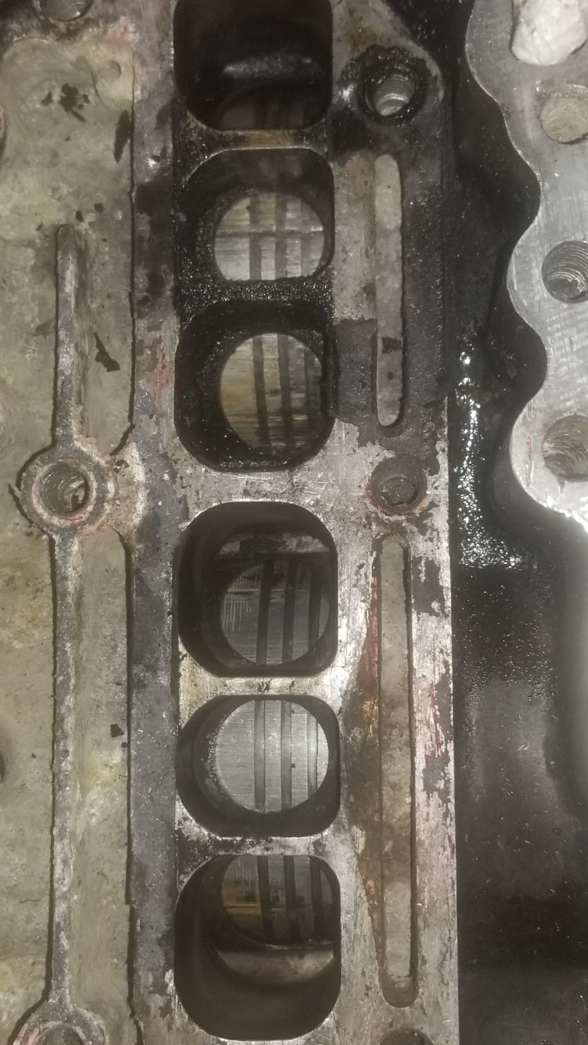

Brought a pic for ya all.
Top piston (left one in photo) has quite the gouge. Picture makes it look way larger than looking at it by eye. but maybe thats because I dont have my readers on my face when im looking at it in the garage. Number 2 has some gouging and looks like a brass color on the skirt when rotating the motor to see it. The other pistons look pretty darn good from what I can see through the exhaust ports.

That is shot. Doesn't matter what you do with the outsides, it's never gonna run right or be right without a teardown and repairs. The upper piston in the pic is really really bad, it's more-than-likely to need a bore job and oversized piston.
The one below isn't quite there yet, maybe that cyl can be ball-honed and then see if there's any significant scoring. I'd say that piston will definitely need replacing, though.

I want to agree that it is shot, I will not argue with you or anyone on that just by looking at the picture. But I still have 115psi compression in number 1 with no water intrusion on this cylinder. Also other than a little rough idle (I believe mostly from the water in number 2) she still runs like a raped ape! I am hoping to hear some options here because If new pistons and rings are not available then the only choice I see is to purchase an exhaust gasket kit, reassemble, and just go run it till she dies. I cant see her being an anchor or wall hanger. Maybe Dr_Frankenmerc has some options that will keep this 1979.5 115 walking the lakes here and terrorizing the towns folk for a long time.

Dr_Frankenmerc wrote: The 1979.5 115 is an inline-6,...Not related to the posted image by Jim.
doc
Doc, Can you share the link where you get this parts diagram please? I am having difficulty finding this as I dont find anything saying 1979 1/2 in a search. the 79s show using a distributer, while mine has the coil packs.

Very typical failure on an inline 6. any adi 1150 motor will be same block internals are the same dist or adi except there are hi dome and low dome pistons its the height of the deflector. all adi are low dome most dist models are hi dome 78 was when this change crept in. You also have the powerport hole in the piston and corresponding pp in block so youll need parts from a 1150 adi to be safe.
your pistons are toast push on the rings likey no spring back and they are stuck in the ring lands due to the smeared piston skirt. Sure you can run it but cyl wear will be fast your idle quality will deteriorate till its impractical and the block will def need a rebore. Right now a cleanup, hone and piston might save the day. so either that or id just look for a powerhead to swap on plenty come up on ebay or facebook. Unfortunately you now know compression numbers dont tell full story only a look through the ports do , exhaust side is hot so usually where damage appears first. I've got a whole right up here on correcting the weakness of the inner water jacket cover.
