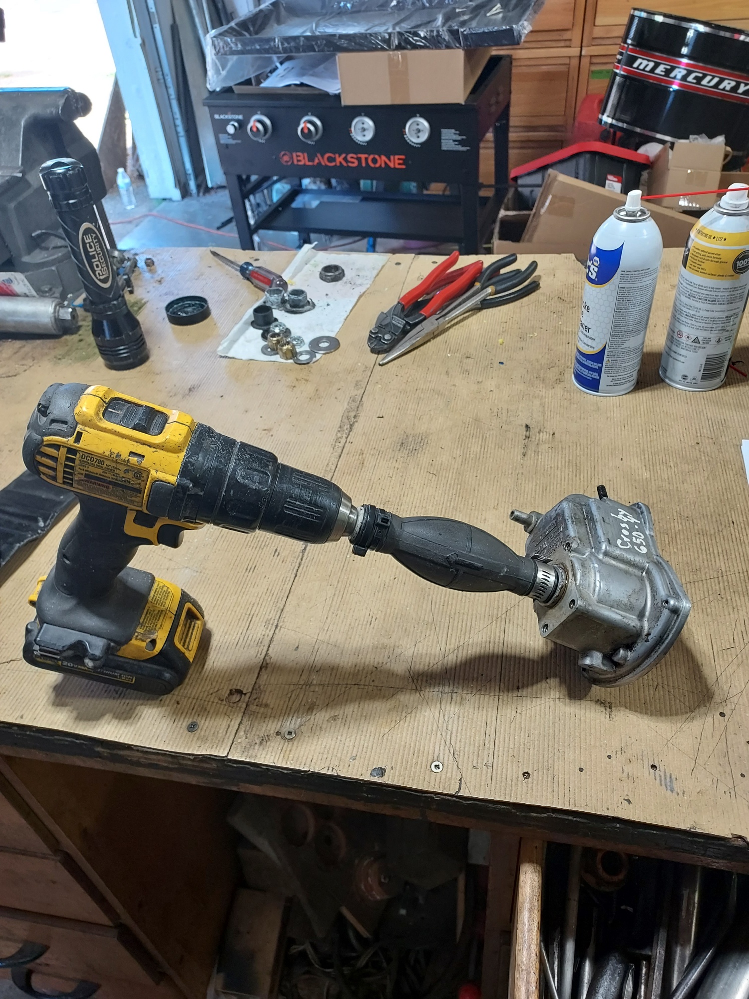

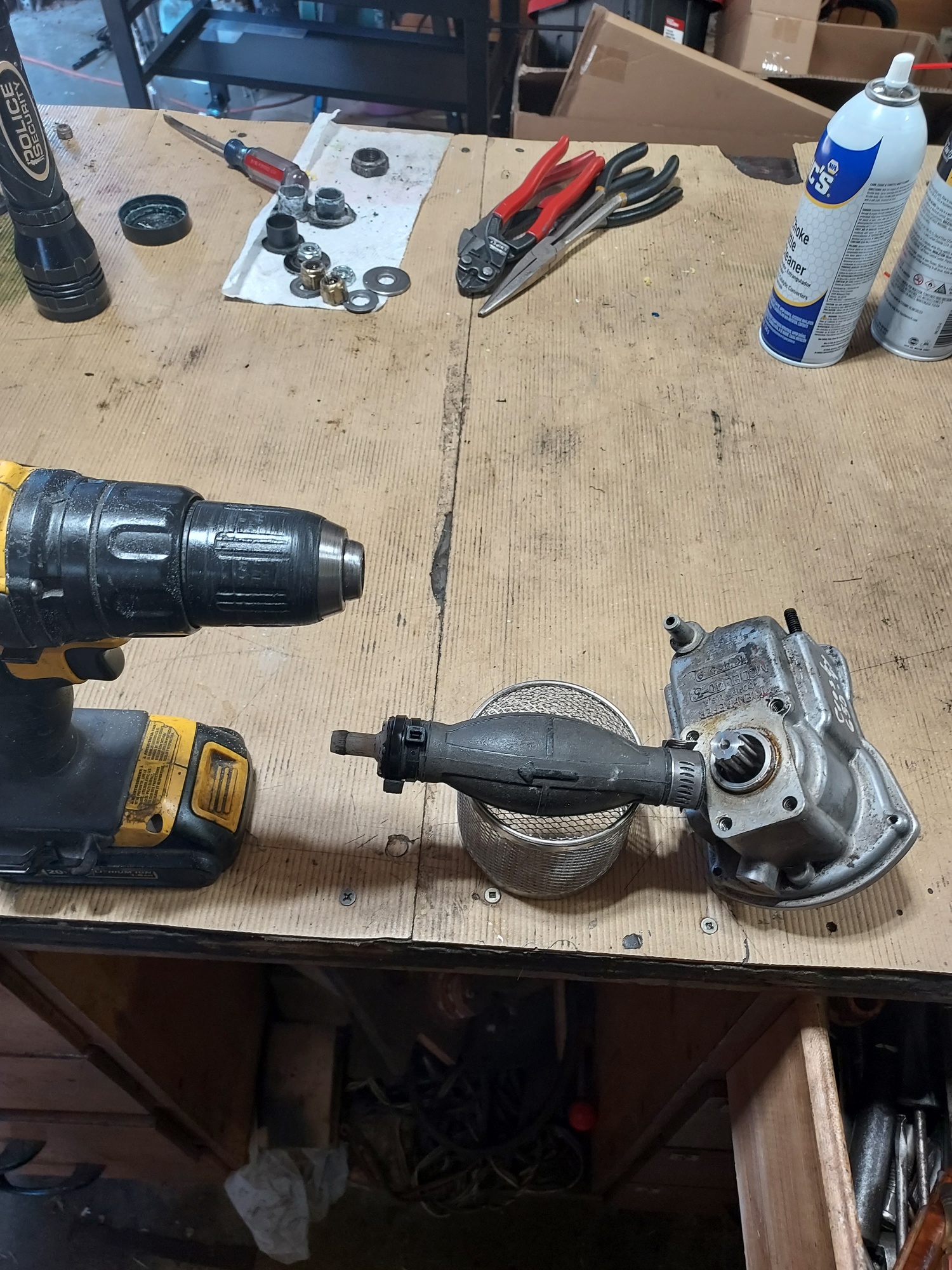

The reason you are not getting continuity to the rotor center or outer pointer, is because the rotor receives spark from the brass tab through the distributor cap. Without the distributor cap in place, there is no connection between the two places.
To test the quality of your spark, remove the rotor, set up a test gap between the brass tab and the magneto housing (ground) and spin the magneto shaft.
You should see about 3/8" of blueish white arc ideally.
I use an old fuel primer bulb to drive the magneto,...See attached.
