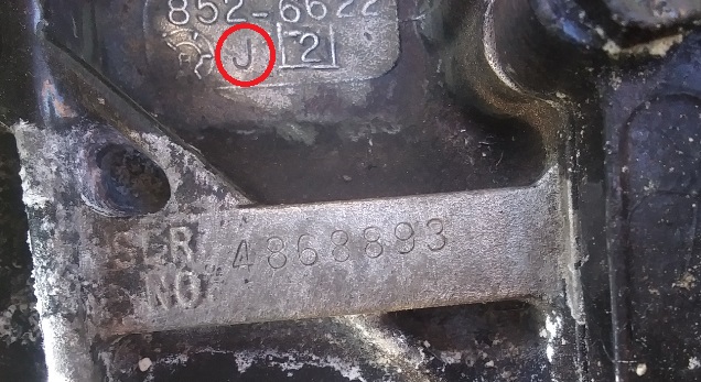

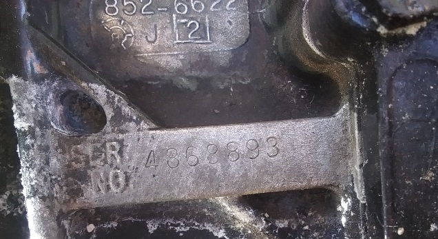

I've been looking for an old inline for my boat and finally got one this week. I wasn't particular about what I got but think I got very lucky. There are no marking on the cowl etc, I have found the serial number on the midsection to be 4749859 (hard to get a picture of) and the number on the block to be 4868893 below 852-6622 (casting not stamp). I have no interest to sell it but word was there is an ignition problem and having the motor/year would help to say the least. It has a dist with a single coil.
Did I get lucky finding this motor, help IDing 4 years 3 months ago #146973

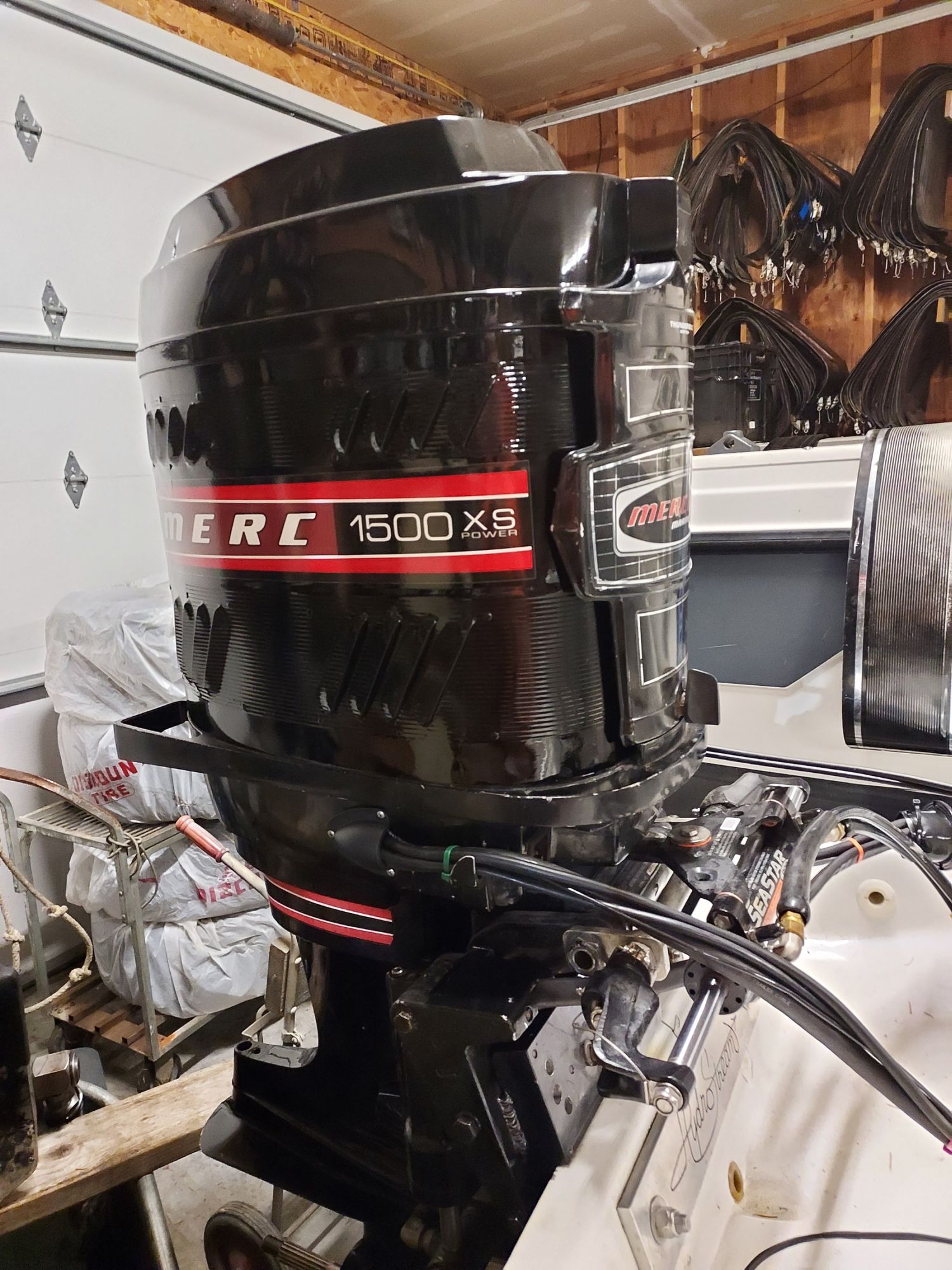

1976-77 1500xs. Very rare, Very desirable.
The 1500xs is identified by the "J" stamp I have circled in the attached picture.
It was uniquely ported by Mercury Racing for their teams in Sport J, etc.
Lot of other details to identify the beast, but typically the "J" stamp nails it as a positive find.
doc

Did I get lucky finding this motor, help IDing 4 years 3 months ago #146976
I forgot to attach the picture of the "J" stamp.
doc

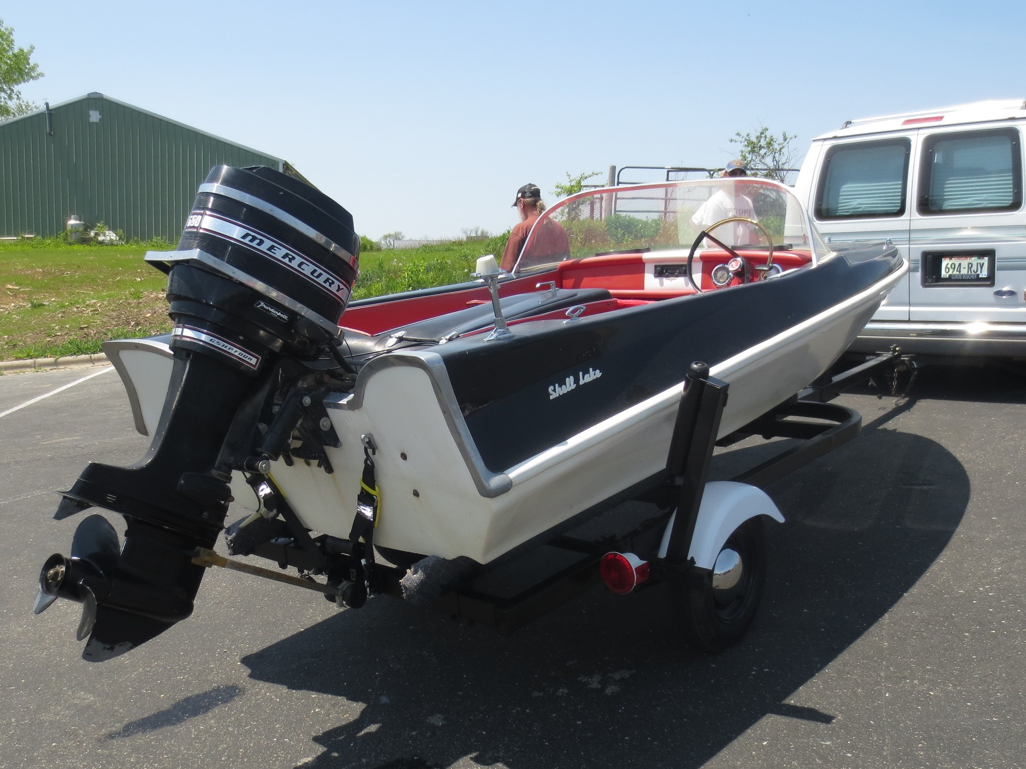

Sounds like you may have hit the jackpot. I suppose you could paint it cloud white and put on the chrome letters but how about instead an era appropriate hull for the XS. Easy for me to say and I’m sure the good Doctor can make recommendations.
The 800's and later Mark's are still out there for the 1959 Shell Lake.
Please post more pics.
Hey Doc,
Your Red Stripe 1500 XS is too pretty.
Thanks,
Terry

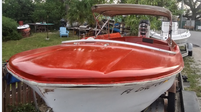

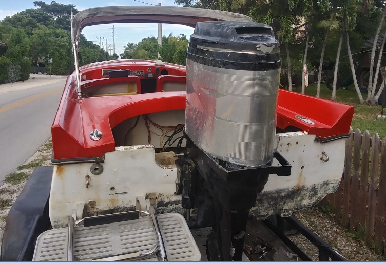

From what I can tell this block was put on the mid section, there is no louvered cowl low water pickup etc. As far as finding another boat I could understand that if it was a complete motor. The '59 is a good little boat and will go great behind my 59 tbird. The car is a little modded so a modded boat fits behind as well. The hull of the Shell Lake is a flat bottom with strengthening strips which is quite quick on the water. I do wish I still had my challenger but it wasnt a good boat for the keys. I can see people looking at the boat thinking, "wow an 80hp, I bet that flies" and I just smile . . .

Swabby
Old buddy's Shell Lake powered by Old Merc.

Did I get lucky finding this motor, help IDing 4 years 2 months ago #146996
