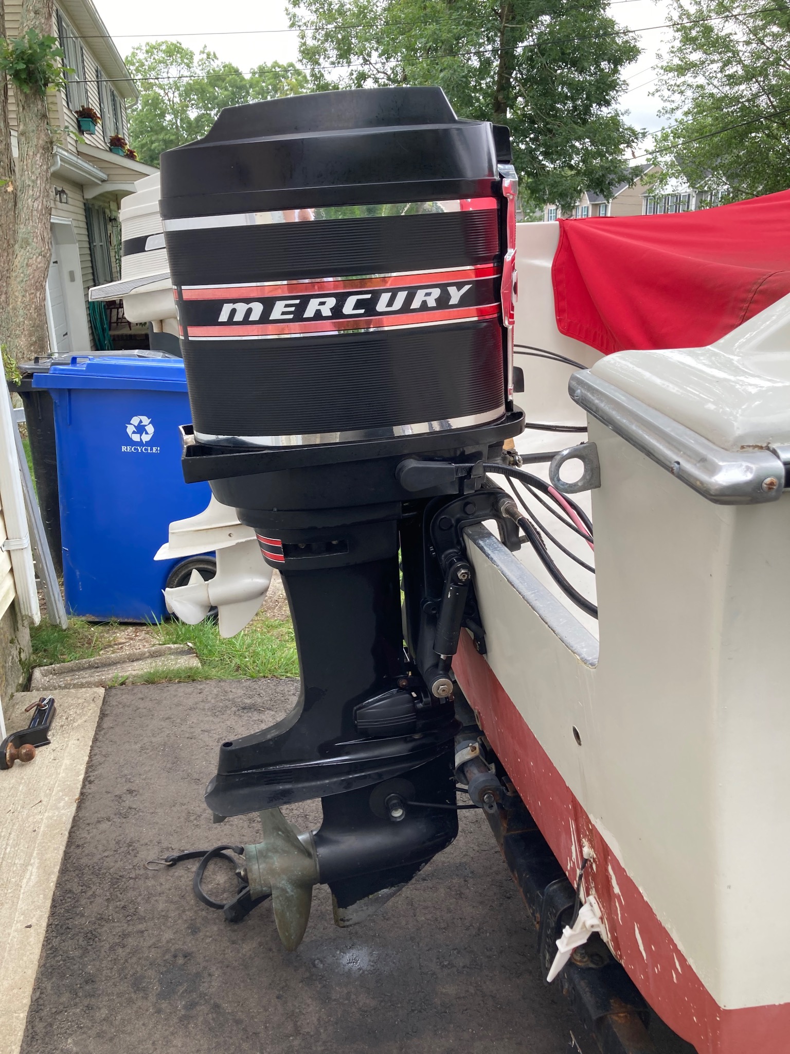

Any input would be greatly appreciated. I want to inspect the impeller on my outboard. I had a few inline 6 outboards growing up that I did maintenance on but that was about 30 years ago. What’s the correct procedure for removing the lower unit on a 1970 Merc 1350? Should the engine be in gear? Besides the bolt under the zinc is there anything hidden that I’m missing? Any YouTube channels anyone can recommend to guide me? I really don’t want to screw anything up by forgetting a step. This is a great running motor and I want to keep it that way. Thanks in advance

Hi, Chris, a nut on either side, one in the front up on top, one underneath, one under the trim tab as you mentioned, and of course the bolt from top for the trim tab itself.
Shine a flashlight down upon the trim tab's bolt head, some are 12-point heads but more likely it'll be a hex-headed bolt. If you're in a salty area and you have any stuck hardware, don't force it. Use a Propane or MAPP torch to heat the surrounding area. It'll help break the stuck parts free.
If the lower unit doesn't want to come down readily, don't pry with screwdrivers. It'll break the housing. Use wooden, metal, or plastic wedges at strategic points. If there's any salt buildup around the mounting studs, heat will help loosen that as well.
You can leave the shift in forward, it's usually the easiest. When you go to push the lower unit up, you can turn the prop slightly in the Reverse direction to get the driveshaft to turn and align its splines with the crankshaft splines. Goes without saying that you should disconnect the battery before start this work.
Use caution once the lower unit is off, to not move the shift shaft/cam from their current position. Nor move the remote control lever. Might not be a bad idea to take a picture or mark the position of the shift cam/shaft so if they get disturbed, you can realign them.
Use a good coating of water-resistant grease on all studs, etc. Use grease on the driveshaft splines but not on top of the shaft. Replace the driveshaft O-ring if your driveshaft has an O-ring groove below the splines.
Mercury Anti-Corrosion grease is very sticky and does a great job of keeping salt and other debris out of hardware. It works very well for lubricating the driveshaft splines, too. Failing that, I've used Sta-Lube blue boat bearing grease on hundreds of motors and never had an issue with it. Things always come back apart again with little fuss or muss.
When you're reinstalling, make sure you have the plastic water tube guide installed in the top of the pump, and the guide 'catches' the water tube as you're installing the L/U. A dab of grease on the bottom sides of the copper water tube helps the tube engage the rubber pump cover grommet easily.
The driveshaft engages with the crankshaft next. This is when you turn the prop just a bit to get the driveshaft splines to go up into the bottom of the crankshaft. After that, the shift shaft engages with the shift rod. That's usually the tricky one. If it just doesn't want to go, you can try wiggling the exposed portion of the upper shift rod as you're pushing up on the L/U.
In some cases there's too much preload on the shift cable, and it'll have to be undone from the motor so you can move the upper shift rod a bit to get it aligned with the shift shaft. Sometimes they go right in real slick, other times it's a bit of a fight.
