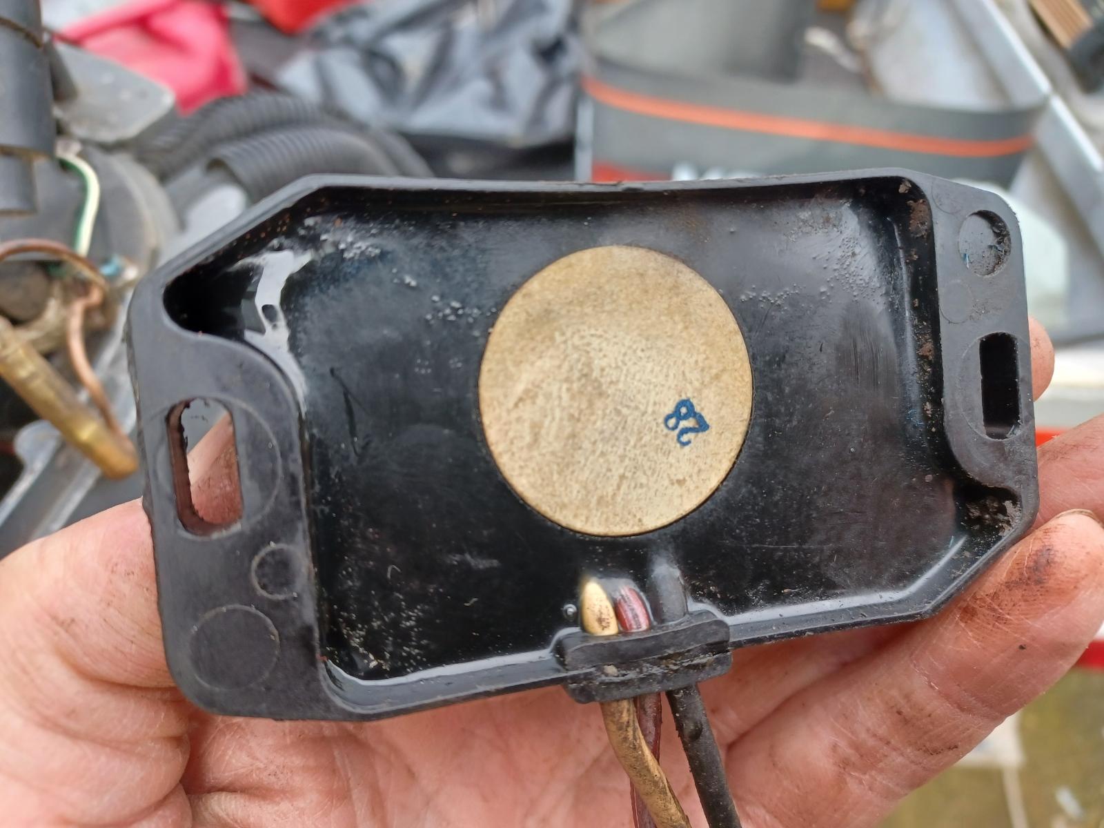

Can someone identify this electrical component on a 1985 Merc 6 cylinder 115hp for me? THX!!

4stroke wrote: Can someone identify this electrical component on a 1985 Merc 6 cylinder 115hp for me? THX!!
That's called an Idle Stabilizer and it should be disconnected and removed.
They are notorious for failing, and causing the timing to be too far advanced, which will cause detonation and ruin the pistons/rings/cylinders.
