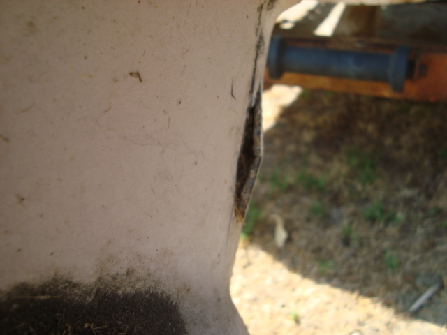

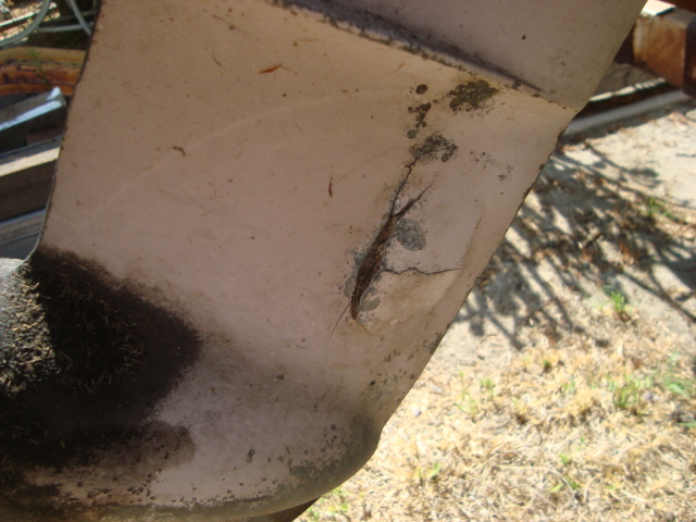

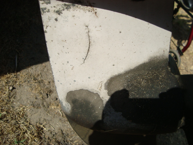

lost my post? well heres pics. port side has a slight blow out and. paint stress marks at that plug? where is the water inlet on this funny motor.

Freeze damage to the drain cavity, as Doc was saying. I have a 700-DR L/U with one side busted out of it like that.
Pull the L/U and clean out all the corrosion in the cavity. Then get the aluminum as clean as possible inside & out, remove all paint in the areas needing fixed, and have it weld-repaired. File or grind, sand, bondo, paint, it'll look like new!
Here's some good info on how to get the aluminum scrupulously clean prior to welding:
www.clintonaluminum.com/how-to-clean-and-prepare-aluminum-for-welding/
HTH........ed
