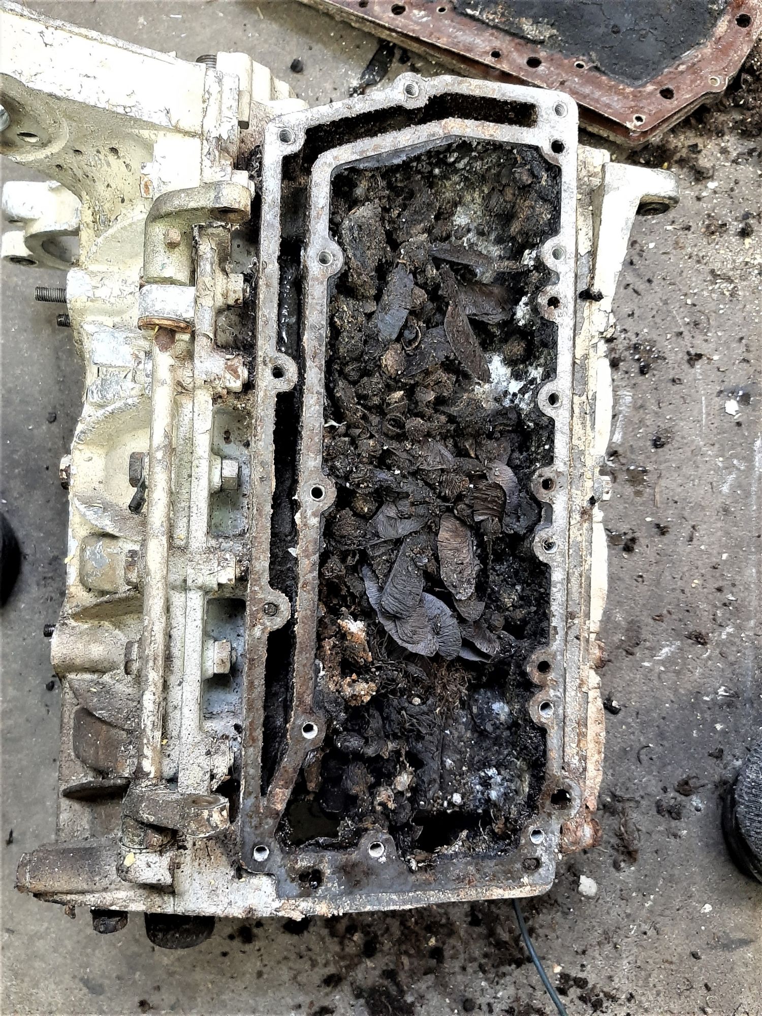

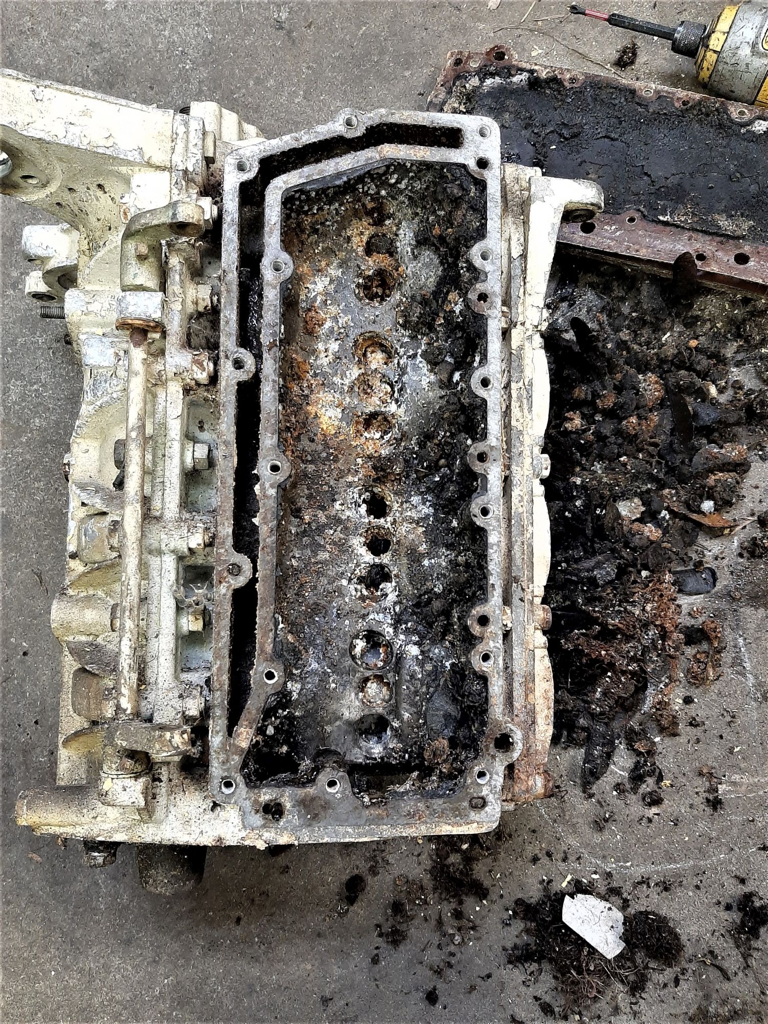

Just in case you think that Grandpa's old Mercury outboard is safe tucked away in the barn on the floor,...Think again.
Mice will climb up the exhaust, up the driveshaft housing, and into the exhaust ports, AND,...Into any cylinders that are positioned lower that the exhaust ports.
Mice and other such critters apparently pee in their nest, and consequently the ammonia created destroys the surrounding aluminum and cylinders.
I don't know how long this 1960 300-4 cylinder was resting seemingly comfortably in an old barn, but by the time I received it,...It was seriously FUBAR.
I was only able to salvage a handful of parts, but those salvaged parts are becoming increasingly rare, and a welcome addition to my pile of goodies.

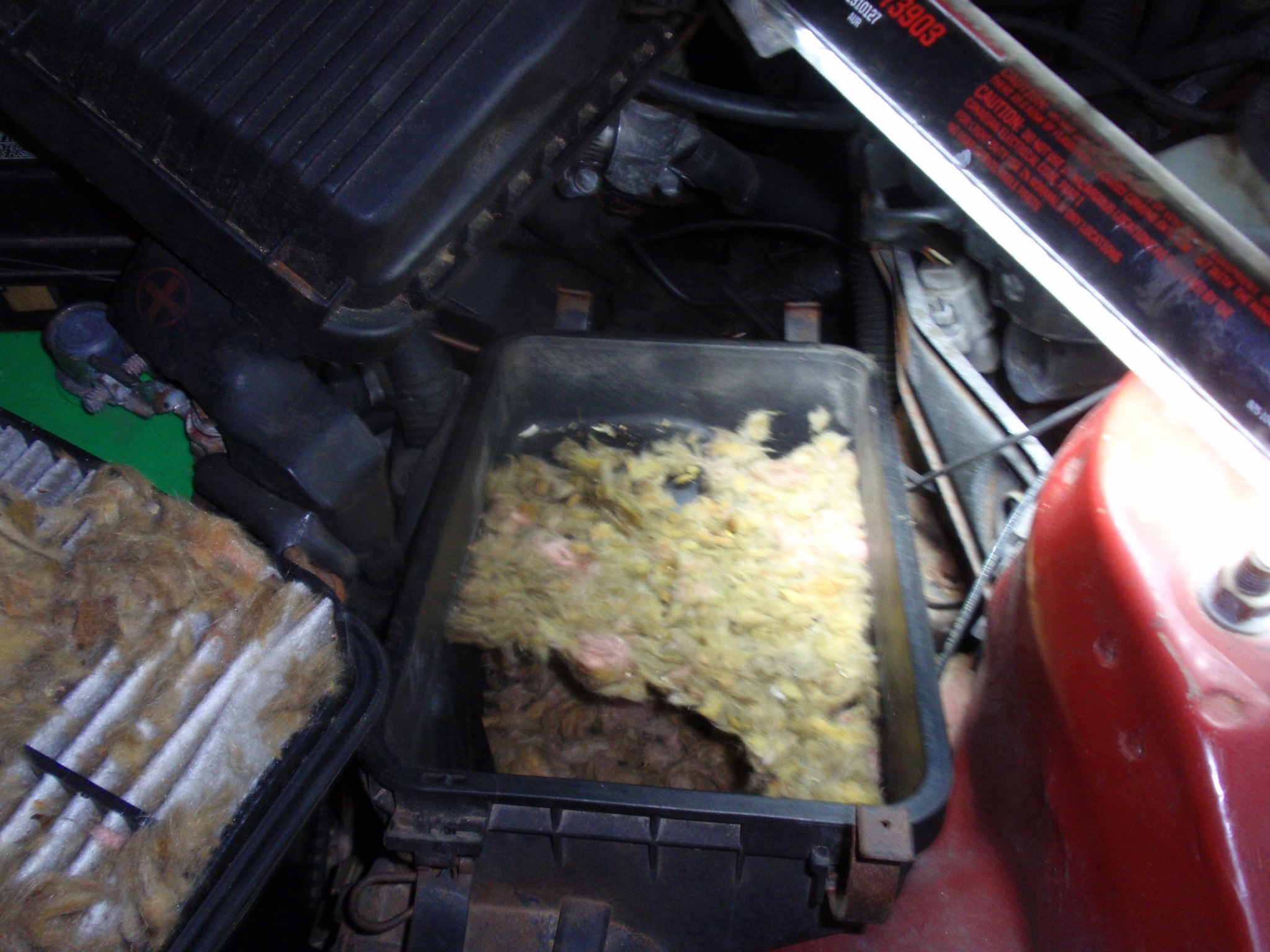

Yupper. You haven't lived until you clean out one of those rat nests. Been fortunate with my old RV, only found some celery seeds in the light globes. I know they're around, the green pellets are always gone but no bodies.
Found this in the car I'm restoring. "was stored in the barn for 5 years" All the plug wires were chewed along with some hard plastic connectors.
