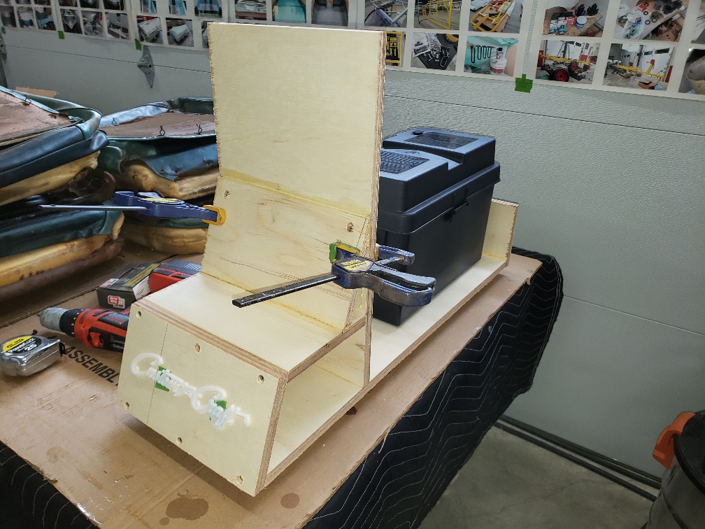

Good Morning Ike and thank you for the reply and link. Yes, I got a little input from the Merc facebook group as well and in addition to the charging sensitivity, comments stated that a voltage regulator would be needed so that the vintage alternator is not overworked and eventually fail. Sounds like I should stick with the standard lead acid type. Maybe a little vibration dampening as I would like to mount it towards the front, centered under the dash? Starting to frame up the box now. Picture attached. Cup holders on in the little shelf, light switches on upper slant, fuse box on back of vertical board and master on off on the driver side exterior. I have some thick closed cell rubber foam that I can mount under and around the base of the battery box once the sides are on.
again, thx & Happy Holidays-
Eric

As long as the battery is in a well ventilated space (they give off hydrogen gas when charging) and easily accessible so you can check the fluid levels, should be ok. The battery boxes are good. They contain any spilled electrolyte and make it easier to anchor the battery. Batteries need to be fastened down so they won't move if the boat is bouncing or rocking around. Looks good.
Peter D. Eikenberry
newboatbuilders.com

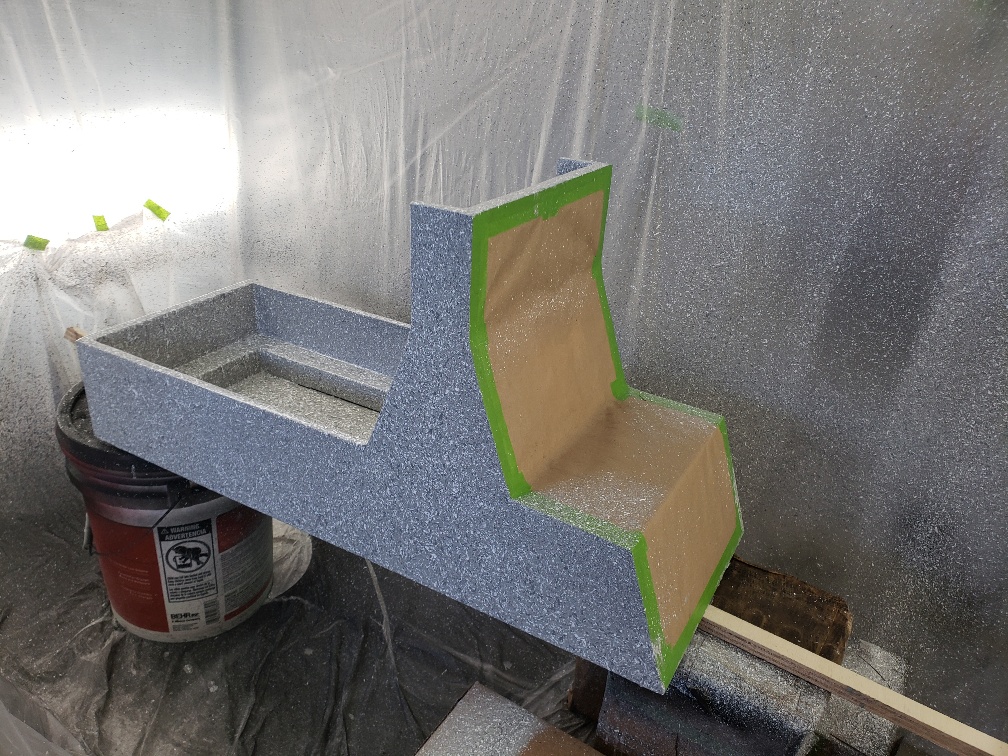

yes, there will be plenty of open space around the box under the dash. sides are now on and sprayed with Zolatone. I've got some left over closed cell foam that will go in the bottom to dampen vibration and I'll put footman's loops on the raised inner rim for the strap. I'll have additional pics under the '64 custom craft "member projects" thread when I get the cup holders and switches mounted on the face.
Thanks again for your incite !
