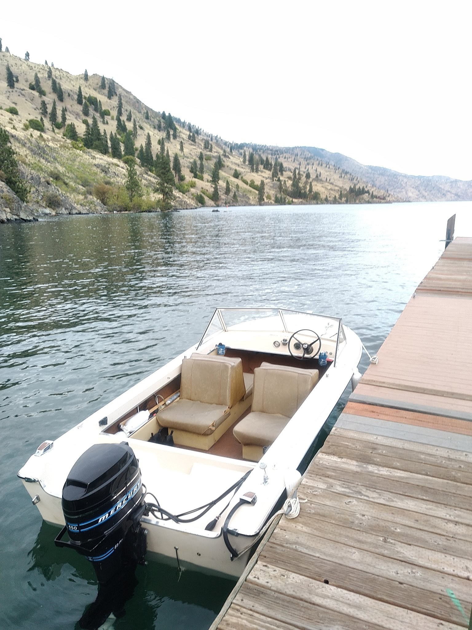

Hi all,
I have a 1970 GlasPly 16' with a (by serial number) 1971 Mercury 650 4 Cylinder, it looks 100% original but the decals look like 1972 blue band and not red band, that has me kind of confused because I thought everything was red band until 1971. maybe mercury ran out of red decals?
Additionally - my boat came with a 12.5"x19" prop, I ran it because that's what came with the boat but I always noticed a performance problem. would only hit 3800RPM and 27mph MAX with 2 adults and 2 young children onboard. Also it would struggle to get on plane and keep it there. I have a 13"x17" prop that I'm going to try out, just curious if anyone has a recommendation on prop size. Looking for 30-35MPH 4800RPM-5300RPM MAX.
Thanks,

Maybe it was a very late '71 run and they switched to blue. What's the serial number, that'll tell a lot. There's also the possibility someone updated the stripes. Does the small "horseshoe" cover around the mid-section say "650-4" or something like that?
Even with a 2.3:1 gear ratio in the lower unit, that 19"-pitch probably is way too big for a 65hp. Prop it so your WOT throttle with only the driver in the boat is around 5300, or the top of the recommended rpm range. That way it'll do better when you have a load of passengers in the boat. These engines like to be revved, they Most Definitely do not like to be lugged.
See how much the rpm jumps up with the 17" prop. Then you can extrapolate what another 2" pitch reduction will do. You may end up having to go to a 13" pitch to get the proper WOT rpm.
You'll find that she's a lot Happier and Snappier with the correct prop, and will use much less fuel to boot.
HTH...........ed
