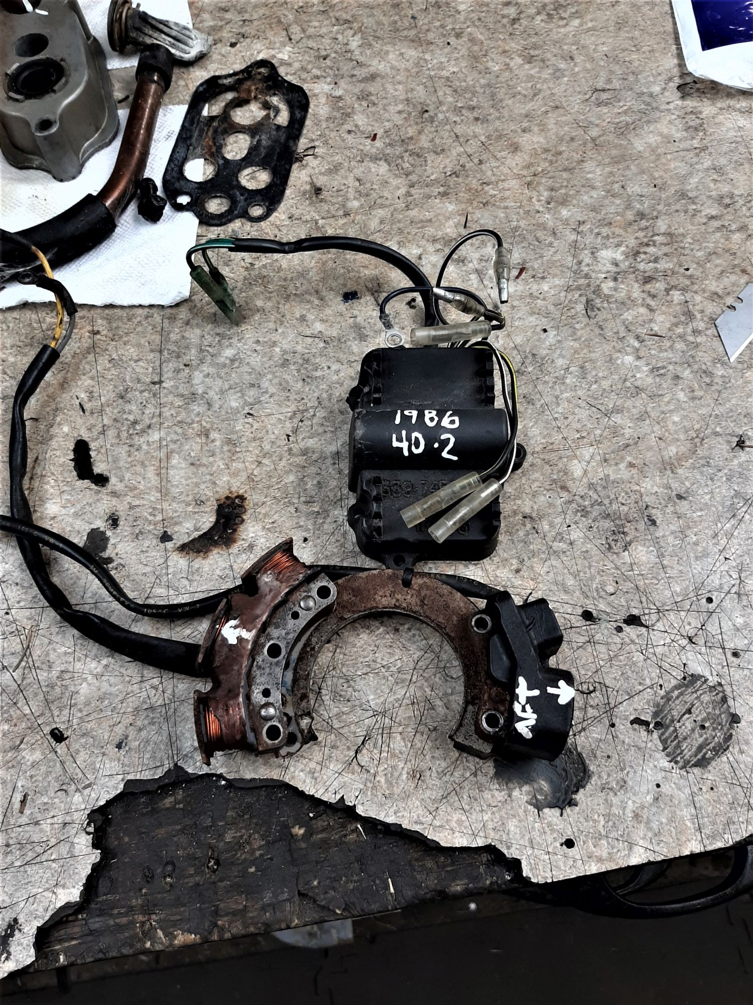

The 400 and 402 have gained infamy as a "401" due to ignition failures.
Your switch box looks like it might be the same as one I just stripped of an '85+ 40? 35? 2 cyl.
Mine might be okay, but since the motor was seized, I was unable to test it.
Post your serial number, and I'll cross the parts ith my seized one.
If my parts are the same I'll ask for a PM for your contact info, so I can determine where to ship my parts to on my dime.
If my parts resolve your problem, I will want 25% of list cost + postage.
If my parts don't resolve your problem, just throw my parts away.
doc

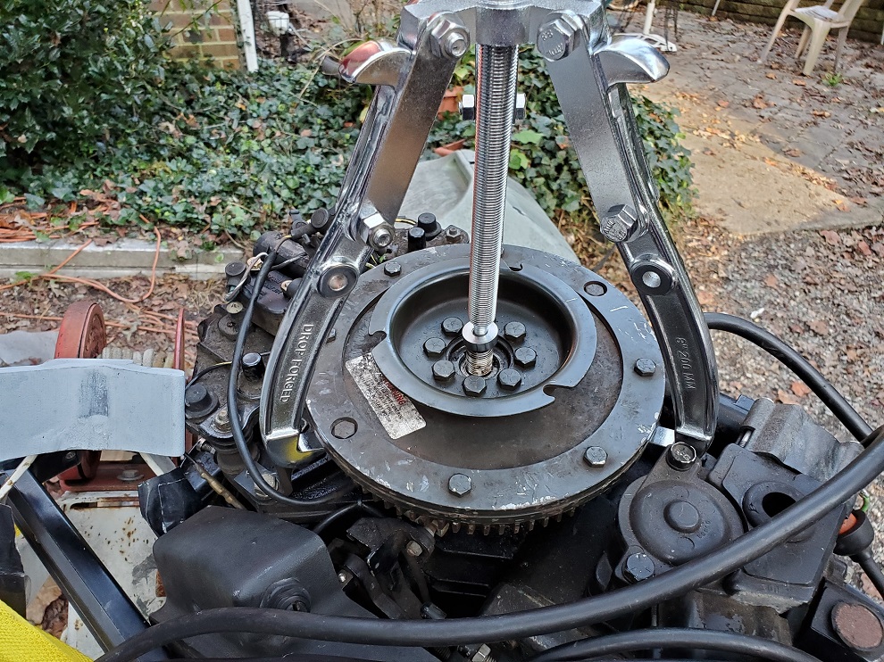

ok next step
am trying to get the flywheel off this is way way hard . I bought a puller and tightened as much as i can almost thinking things will break and fly everywhere. it does not want to budge, sprayed in lubricant also
40hp 1975 no spark to the 2ed plug Help please ! 5 years 10 months ago #143412
DONT USE THAT PULLER ! If you don't have the correct puller us a puller attached to 2 bolts removed from the center hub. using your puller can ruin or break the flywheel.
40hp 1975 no spark to the 2ed plug Help please ! 5 years 10 months ago #143415
I hear you thanks, learning as i go, it is very nice that i can post here and people will share their experience and give suggestions is this what you are suggesting

quick update i think it is the Trigger loose wire somewhere. As on a few tries ( of many many) i did get a spark to ground, from the #2 plug So, i am ordering from joe Poole, from Ferguson-Poole, marine. He has been very helpful as i try to figure things out. But i am running out of good weather to get it going
40hp 1975 no spark to the 2ed plug Help please ! 5 years 3 months ago #144534
UPDATE, Surprise Surprise, I actually got this thing running but still has issues. I did a new post in this section asking about how the motors sounded.
I got the flywheel off to replace the trigger, which i was sure had a loose wire, not reachable, because it was under the flywheel. I DID use a different type of puller as I was told that was a bad type to use.
Once the flywheel was off i realized that one of the magnets came loose, not flopping around it just slid next to the other magnet that was on the opposite side.
Thank you to Joe Poole at Ferguson Poole Marine for finding a used flywheel and got the trigger from him also.
