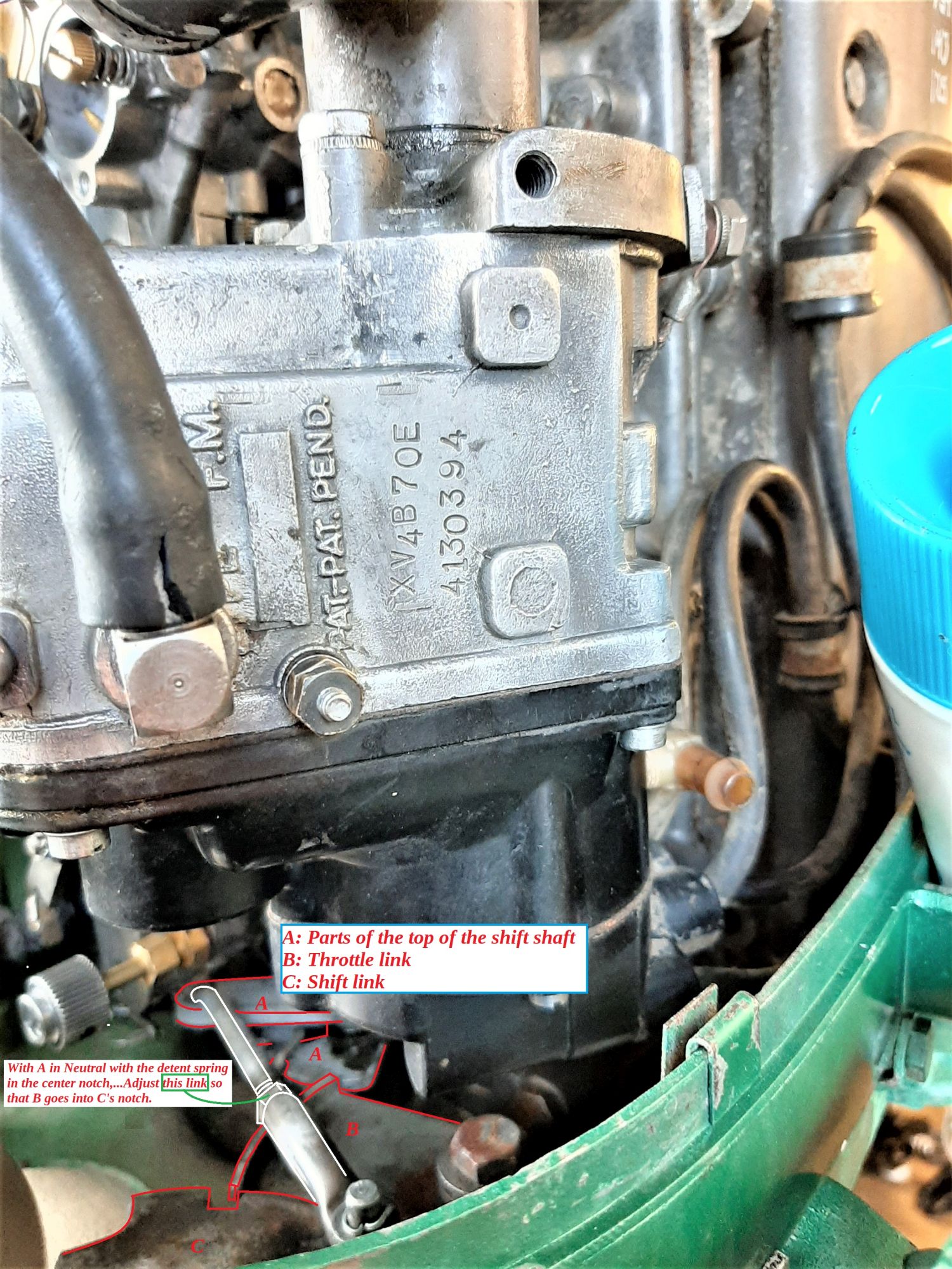

One note,,, while trying to correct shift issue, noticed "linkage" between shifter shaft and throttle control. ie. when looking below carbs can see what appears to be a notched piece that is "not quite matched up with" corresponding throttle link.interface. Someone said we need to use long screwdriver and correct this by lifting shifter shaft maybe? Did we miss something in correcting backwards shifting issue?

There is quite a bit more to the proper placement of all the shift components, but if you have the cam in the lower unit in the correct position and right-side-up, and the Reverse Lock cams orientated correctly. then your much closer, and perhaps my attached picture will help with the final external adjustments.
doc
