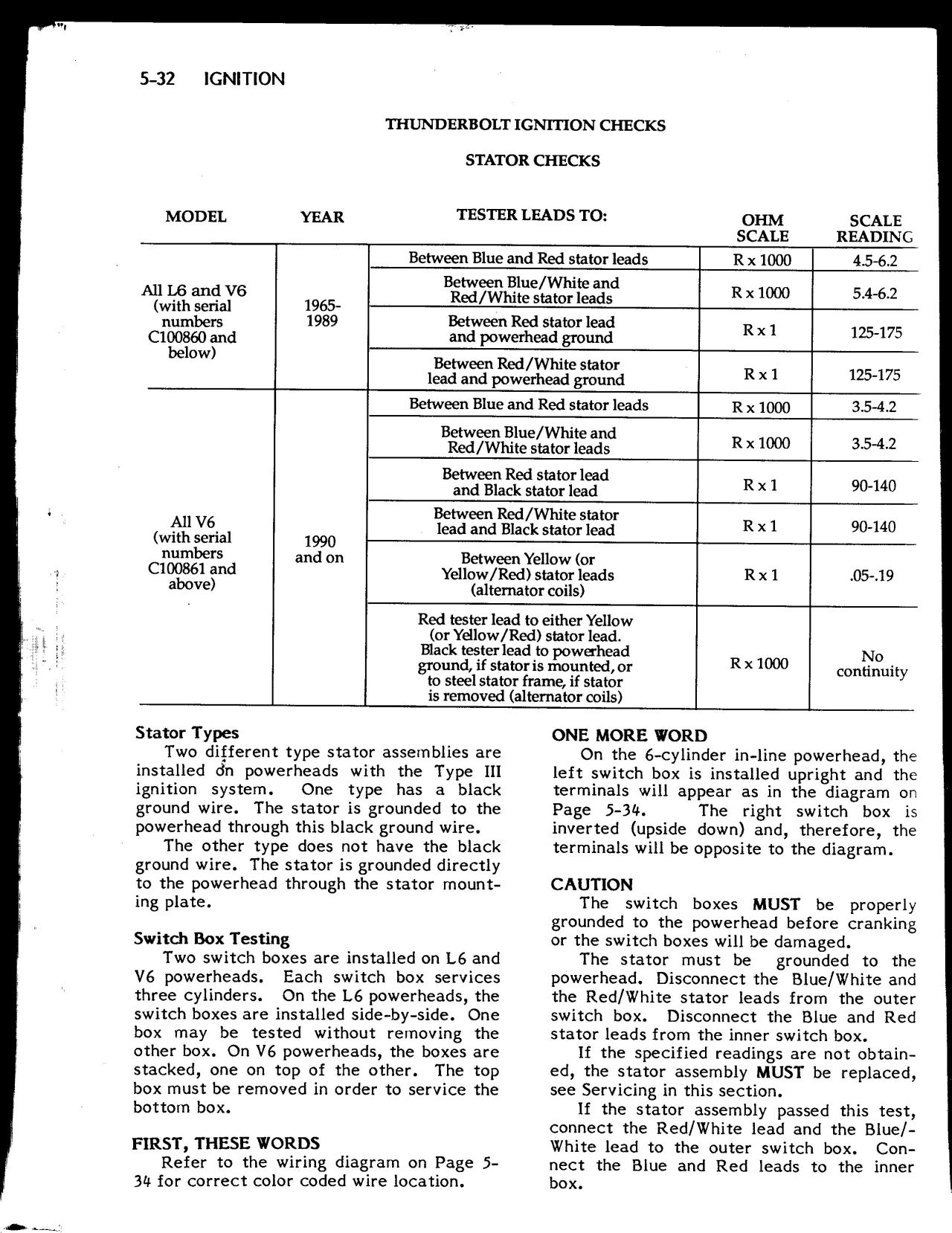

Is this an ADI motor (six separate coils, no distributor)? If so, common ADI issues are cracked coils and bad stators. Stator problems usually start out as heat-related and typically lead to total failure. If the coil is bad enough, you can hear arcing as the spark snaps to ground. Any coil with visible cracks anywhere should be tossed.
If this is a distributor model, "trash" in the cap can cause poor running. In that case, pull the cap, flush with carb cleaner, make sure the spring-loaded center carbon contact is free to move, and reassemble.
You can inspect the coils for cracks, and also take resistance readings on the stator windings. If the stator winding resistance is out-of-spec or changes radically when measured cold then on a fully-warmed engine, the stator is likely shot. I've attached a chart showing the proper resistance values.

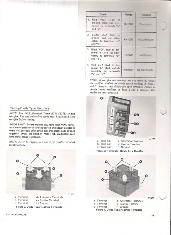

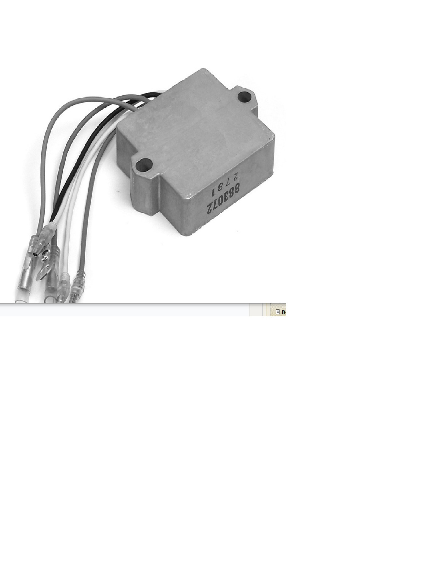

If you are still using a simple (3) post rectifier,...Check your output to the battery voltage.
If it is working itself up around 17 vdc,...Based on your problem description,...Consider putting a v6 regulator with a built-in rectifier on the beast in place of the simple, unregulated rectifier.
There are lots of used ones on eBay, and I have had really good luck with them. Much cheaper than new, and rarely fail.

You should be seeing more voltage.
Ohms test your rectifier.
doc

Rectifier test.

Old thread-still same problem. Had the carbs rebuilt and replaced the regulator / rectifier with the one suggested by the good Dr Frankenmerc. It will start and run on fast idle but when I pull back on the idle it starts to break up and dies. Pull up on the fast idle and it strarts right back up. I checked the coil. If I go from the wire to the distrbutor to the positive (where the green wire from the switch box goes) I get .68 ohms. If I go from the positive to ground I get nothing. When I pull the plugs they all are wet. Is it a bad coil?

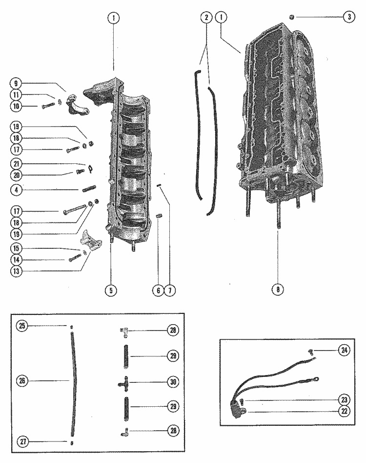

Does that 1150 have the crankcase bleed check valves on cylinders 2 & 4?
Terry

Problems with a Merc 1150 4 years 3 months ago #146847
Hey Bill,
Looks like your motor has the bleed check valves similar to the 800.
parts #25-30
www.marineengine.com/parts/mercury-outboard-parts/1150-115/7112248-thru-7131212-can/cylinder-block-and-crankcase-assembly
On two occasions I have had a valve fail and the motor ran much like you are describing.
Once in Kentucky on the Cumberland River and years later on Geneva Lake and both times had to get towed back to port.
They are a bit of a challenge to get to but easy to check for functionality.
