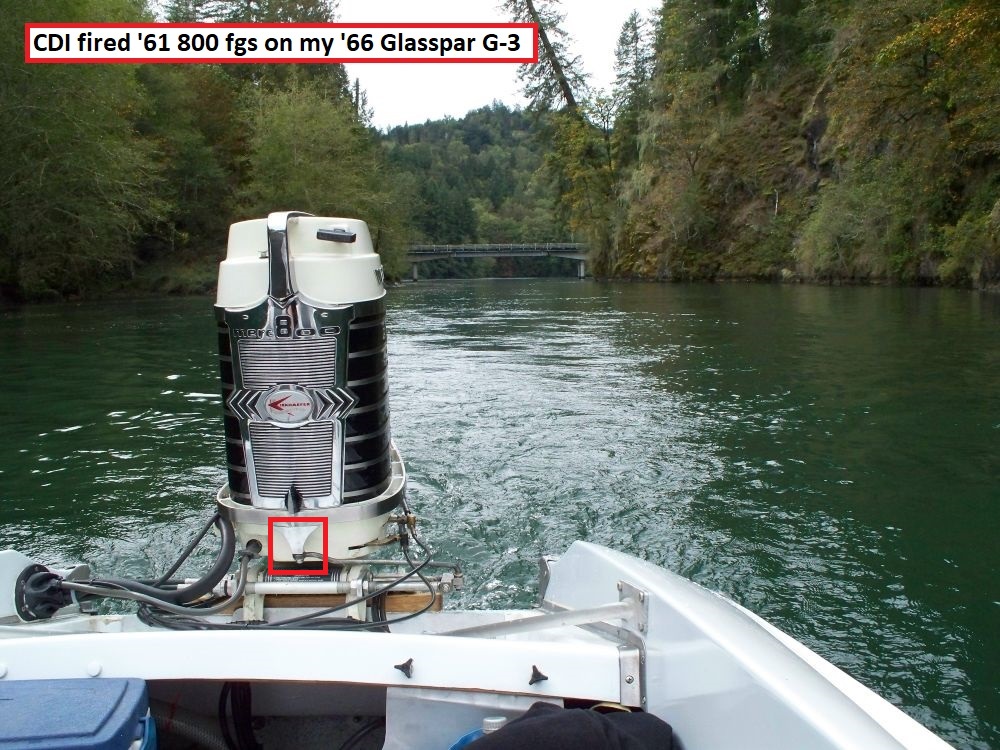

I am hoping someone can point me to the correct part(s) to connect a teleflex/Seastar style steering cable via arm kit to a 1964 Mercury 85hp outboard. The motor itself appears to have no bracket etc to attach the connecting arm. Anyone also know the correct steering link arm kit? I really appreciate the assistance! Thanks

I am attaching a picture that shows the part you need.
You might notice that I have dual rack TeleFlex steering cables in my set-up.
Overkill in this case, but necessary when I swapped out the docile 80HP for a bigger HP Merc.
doc

Thanks everyone that helped me solve this issue. Much appreciated!
