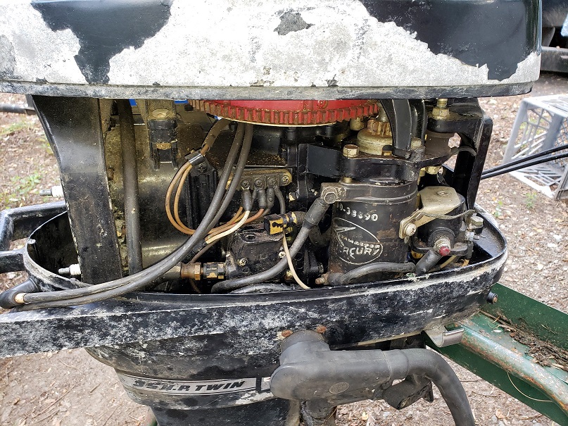

hello, i have a need to replace the fuel lines in this outboard serial # 2089974
is it possible to make your own lines????? using parts from auto store???

just an update on this motor . left it with a local boat repair they did nothing for 3 weeks took it back. bought a repair manuel i was going to just fool with it myself.
But I found one for sale on craigs good working order but called the guy and it would not work for my boat, But i asked if he did his own repairs on the motor , he said yes , So I told him i would pay for his help , and he said yes.

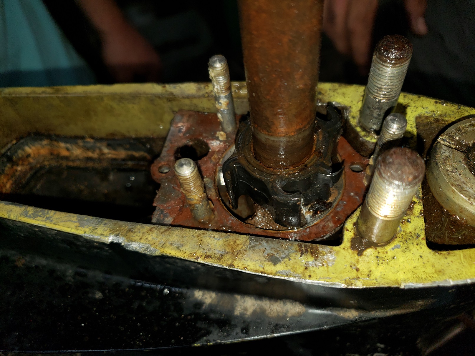

we got it started for a few seconds and found the impeller needed to be replaced. So he helped me with that.
It was very very hard to get the bottom off.. lots of banging, etc. and it took a lot of banging to get it back on. it needs more but i am trying to get the boat in the water even just once this year lol to see if it floats lol
