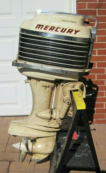

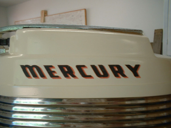

Vintage Mercury White Paint? 7 years 3 months ago #140386

Vintage Mercury White Paint? 7 years 3 months ago #140460
  • Dr.Go!
  • Dr.Go!'s Avatar
  • Posts: 1719
  • Karma: 19
  • Thank you received: 125
Dr.Go!
