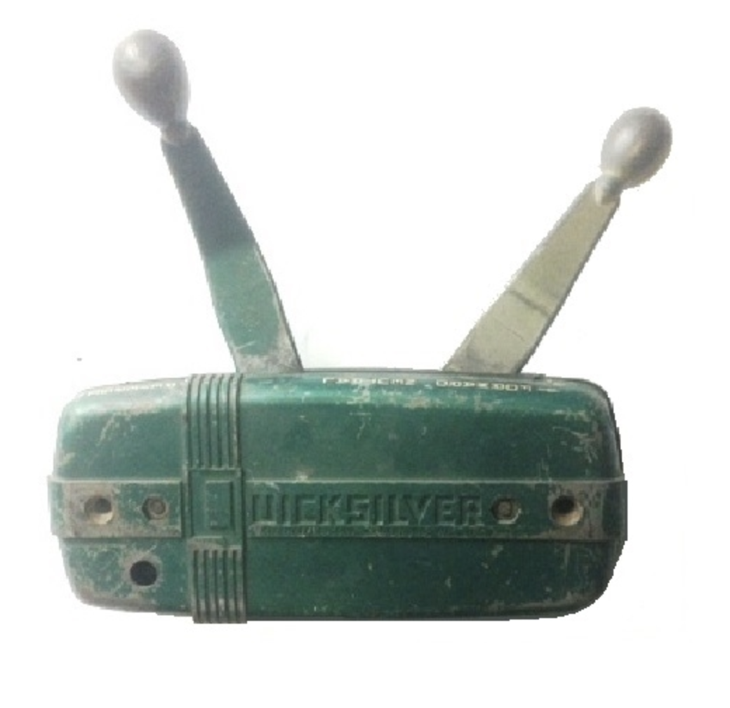

Where do you guys get replacement throttle cables? I picked up a 14' Alumacraft FD and need to get some shorter cables for it. Thanks!

Throttle Cables for Quicksilver Controls 7 years 5 months ago #139557
what kind of control box ?????

Hi Dave, it's the green one that came with the motor. Attached is an image of a similar looking one.

you have to make them from Teleflex pre 1970 naked cables. 1 914 310 7086.

Sorry for the delay here. I had a pair of cables that I thought would be too long but once I fit them into place along the side of the boat and through the transom, they fit great. I forgot that some additional length is needed for when the motor turns.
