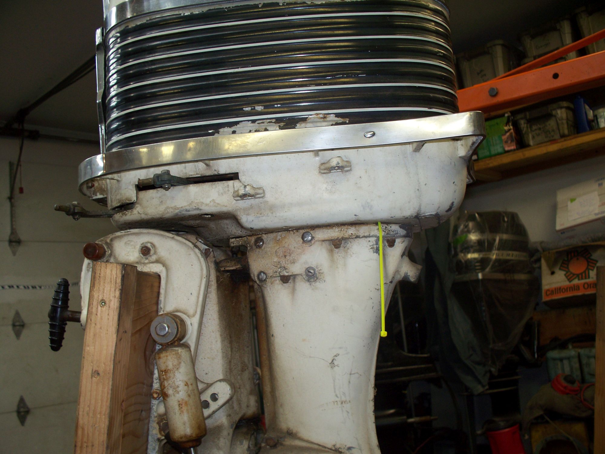

There is no thermostat in the 400-4 cyl, so the temperatures shouldn't get over 100ish, and it will probably run a lot cooler - say 70* +/-.
There is a tell-tail "pee stream' that should be barely warm to the touch. It exits the engine pan on the port side as shown in the attached picture.
When running, you can sometimes clear blockages of corrosion flakes, etc by blowing compressed air up the tell-tail.
