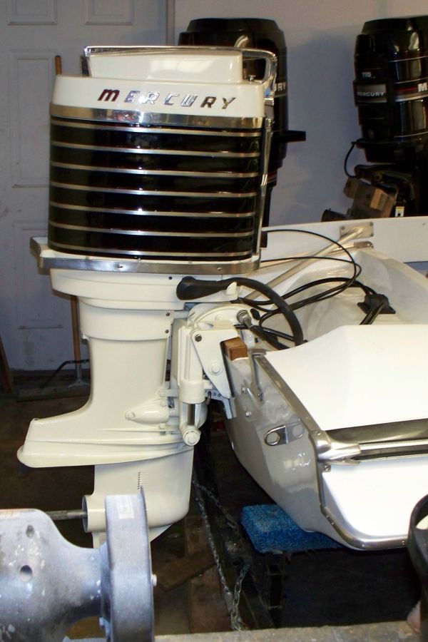

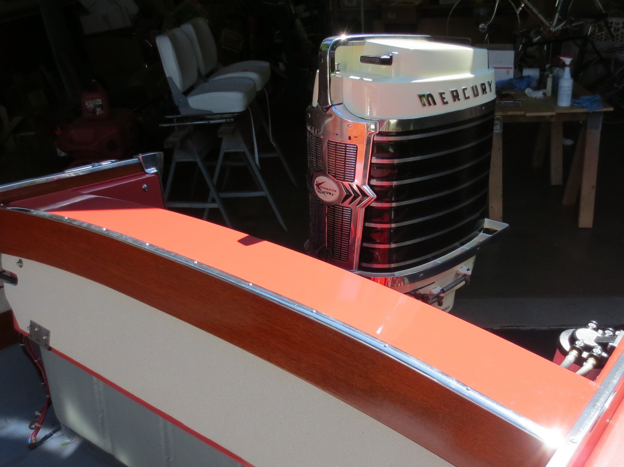

Got a few good shots of one of Bill Anderson’s beauties with what I think is a 700 with added T/T.
A wise man told me: “once you’ve experienced power tilt and trim, you can never go back”

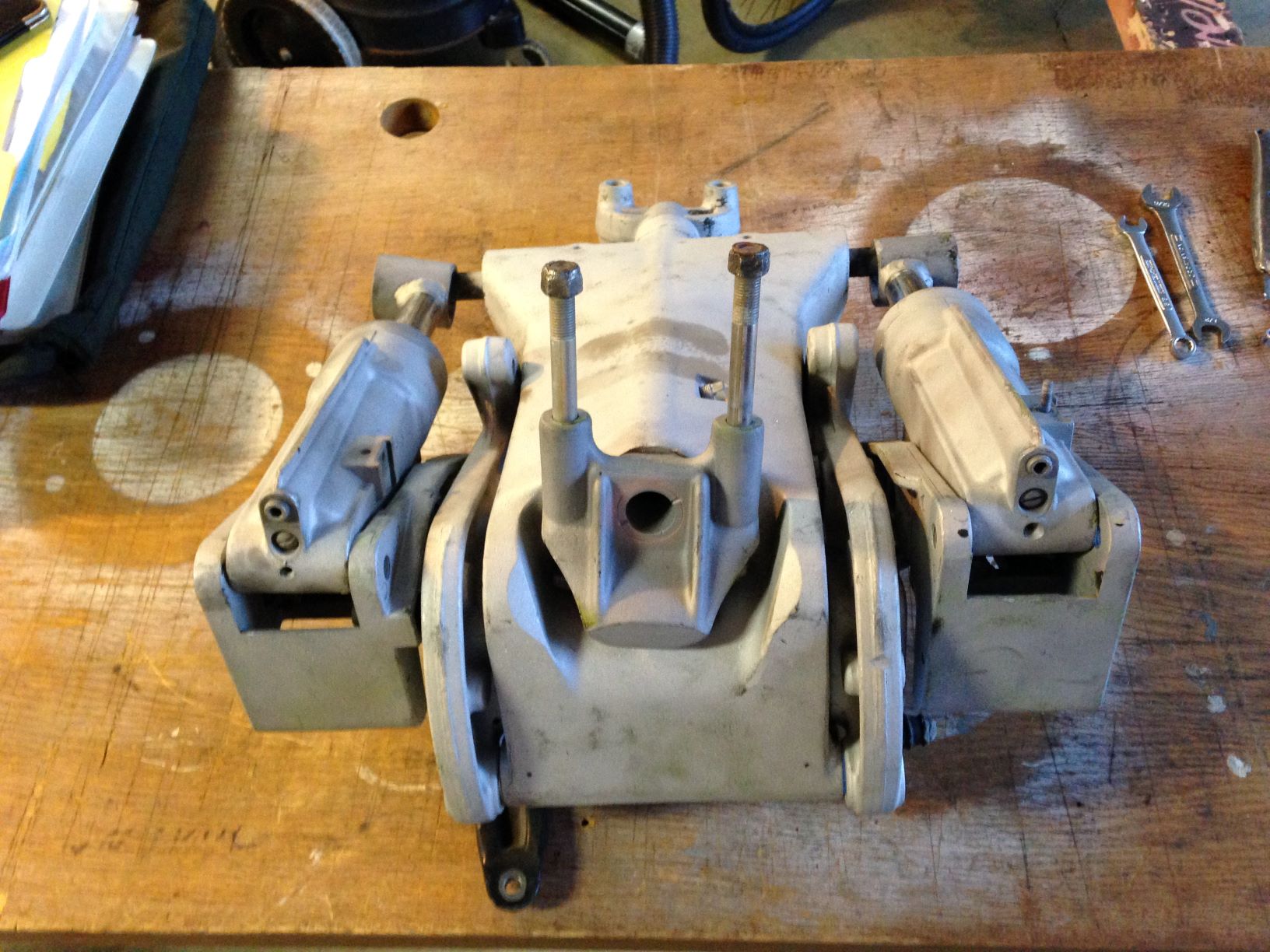

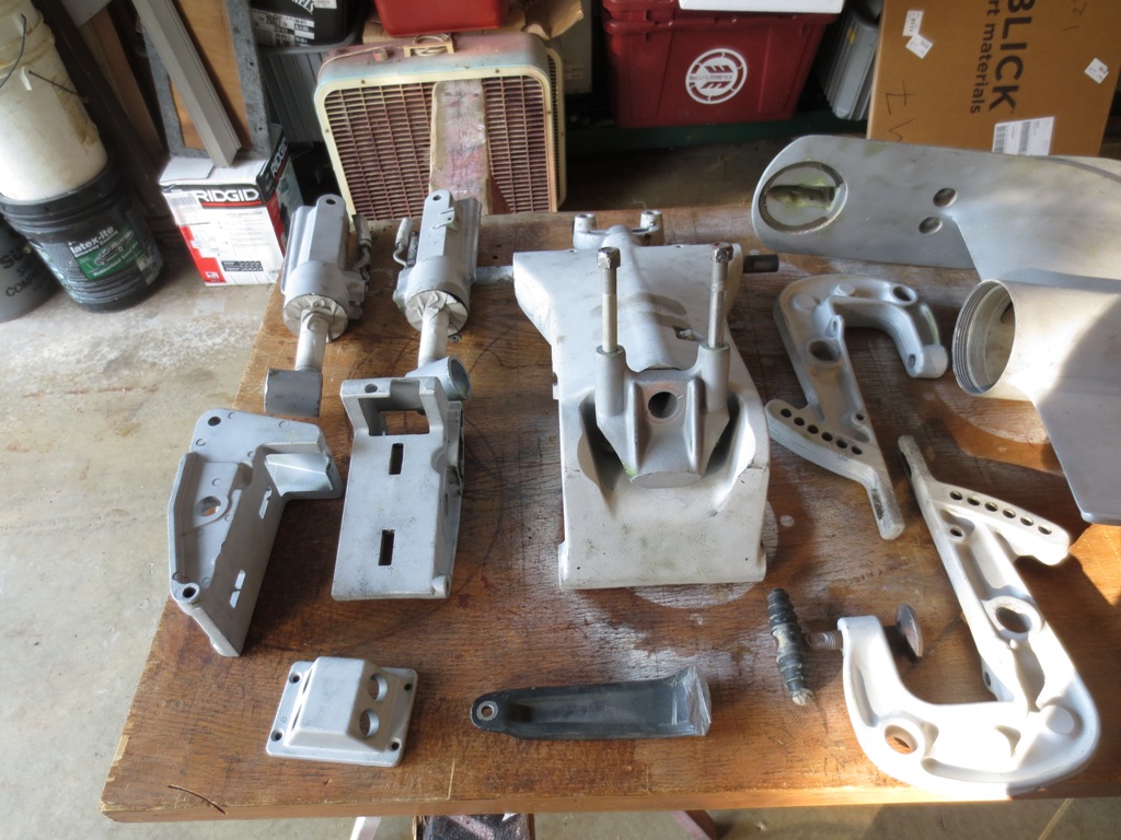

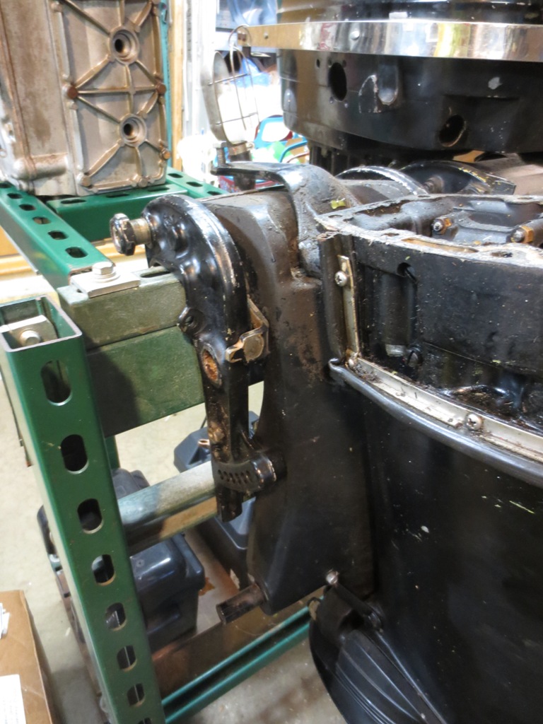

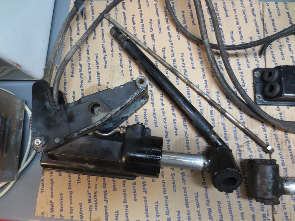

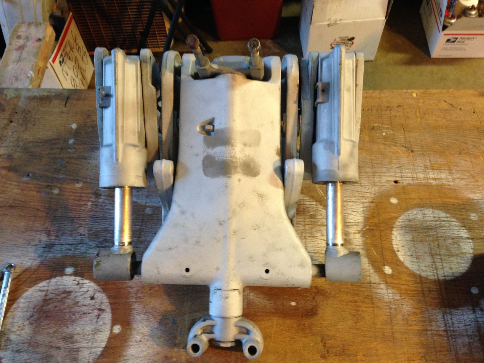

Was able to snag most of what I need for the PT retrofit including a 1970 swivel with clamps.
Still looking for the 3-button control.

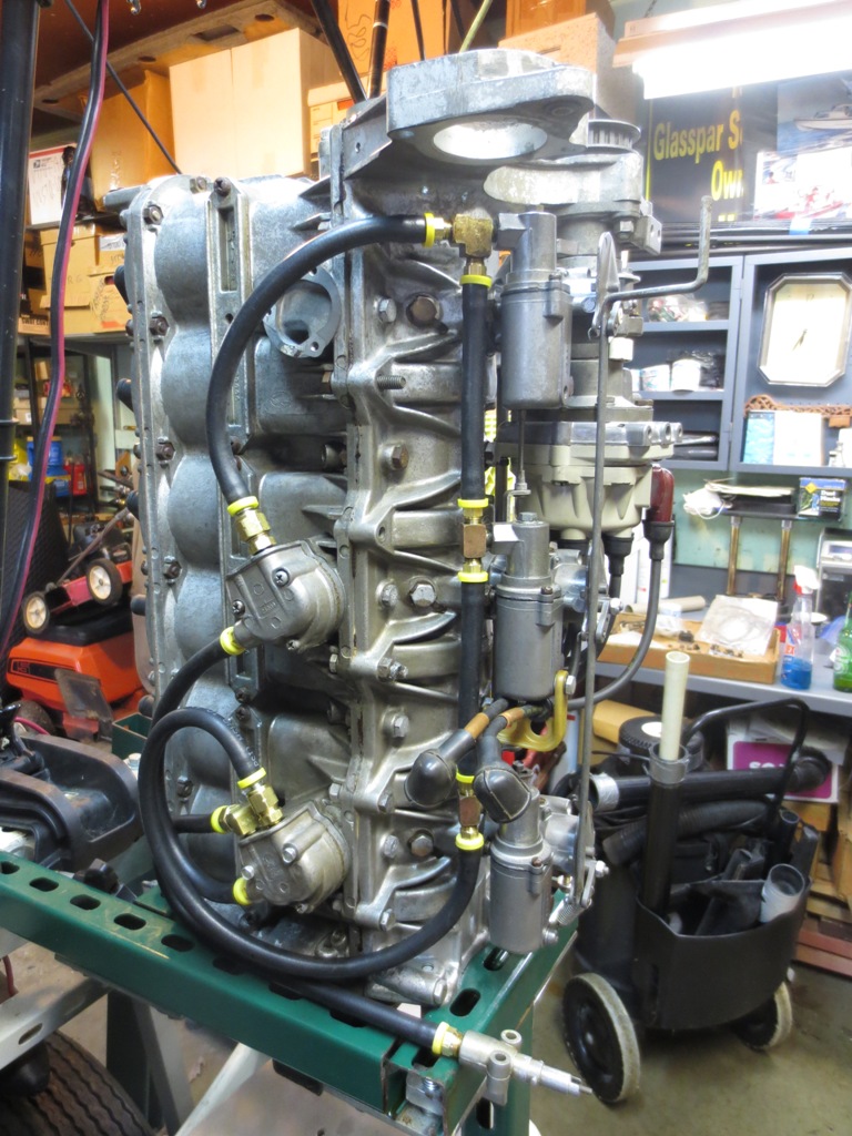

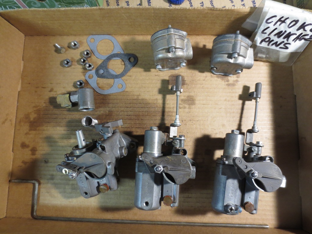

The power head cleaned up nicely and is ready for rebuilt carbs, pumps and distributor.
Now that I have the swivel, clamps and cylinders I can finish blasting and get ready to apply the Cloud White.
Thanks,
Terry

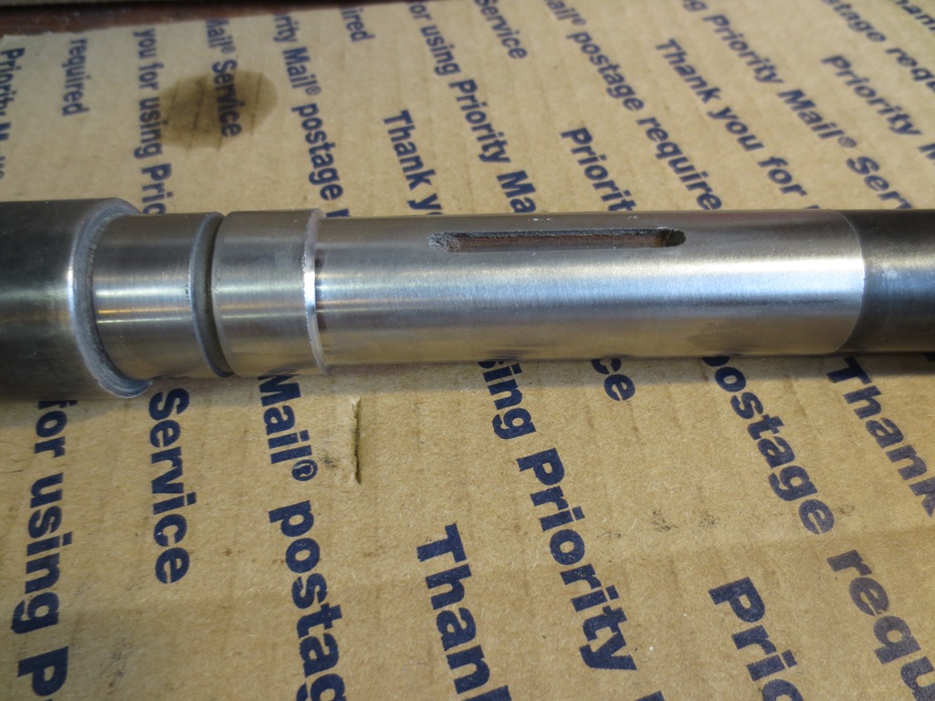

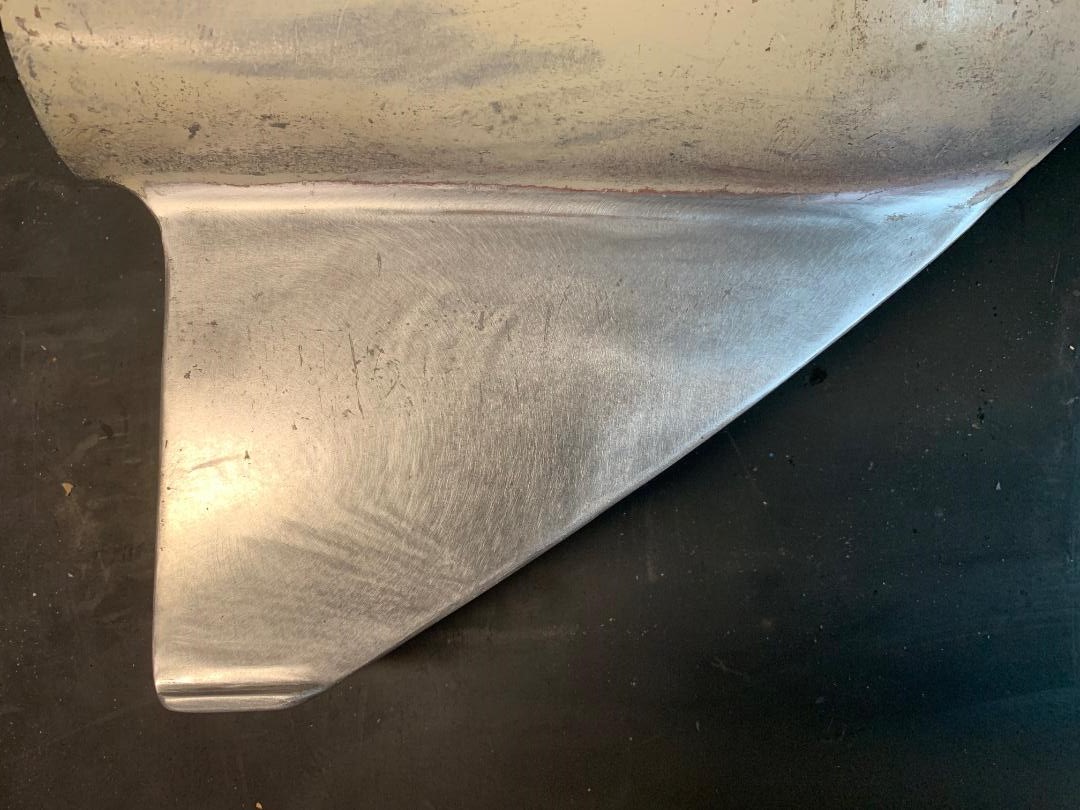

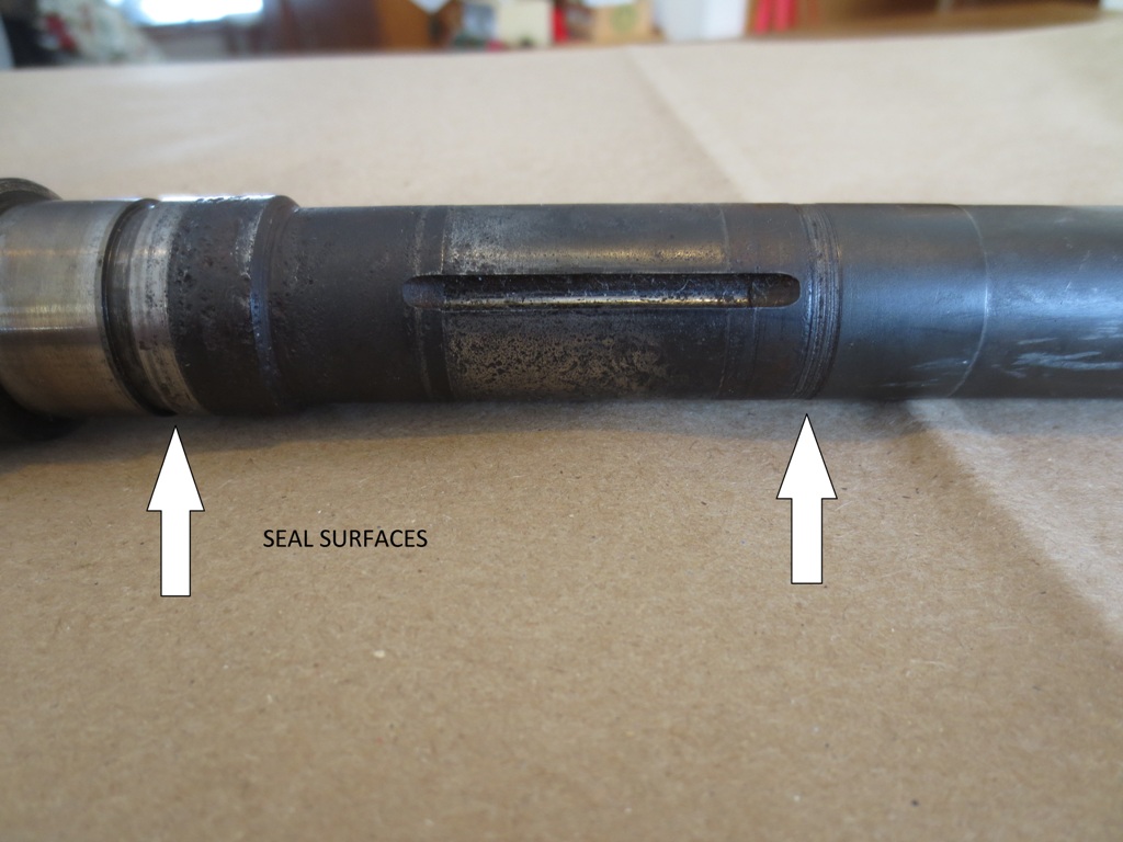

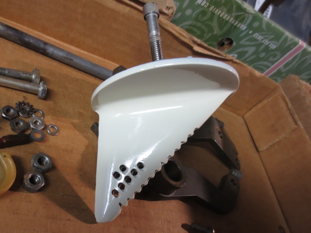

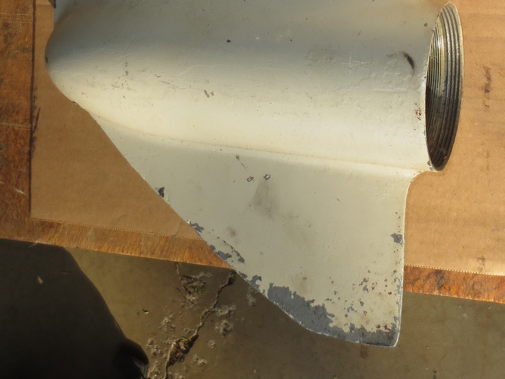

Working on the lower unit and had to repair the drive shaft and skeg.
The shaft was corroded at the seal surfaces.
Sent out to a metalizer for flame spraying and machining.
Also had a welder add metal and repair the skeg which had a small crack.
Thanks,
Terry

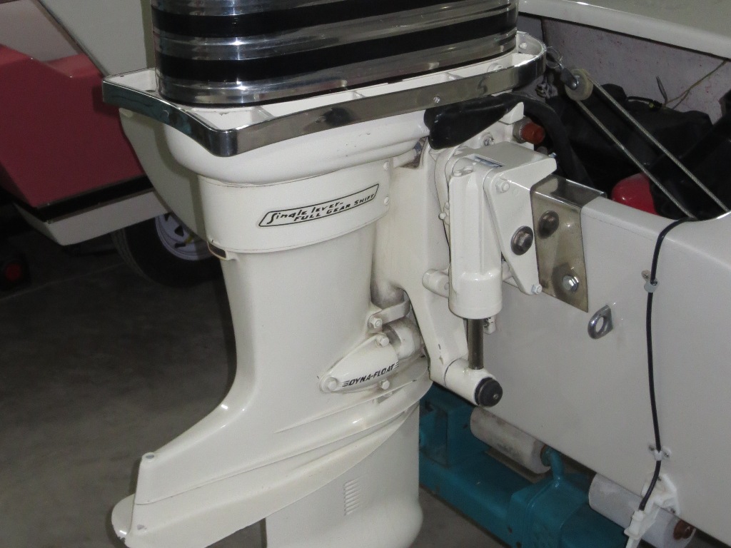

Inline six power tilt trim 7 years 7 months ago #139153
Your driveshaft repair looks AWESOME!!!
If you don't mind,...How much did it cost & where did you take it??
doc F

Found a guy in Oak Lawn IL near Chicago. Paid $190 plus shipping and it seemed like a fair price.
www.accuratemet.com/
I heard some guys just use JB weld to fill it in but that seems like more trouble than worth.

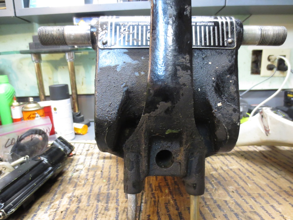

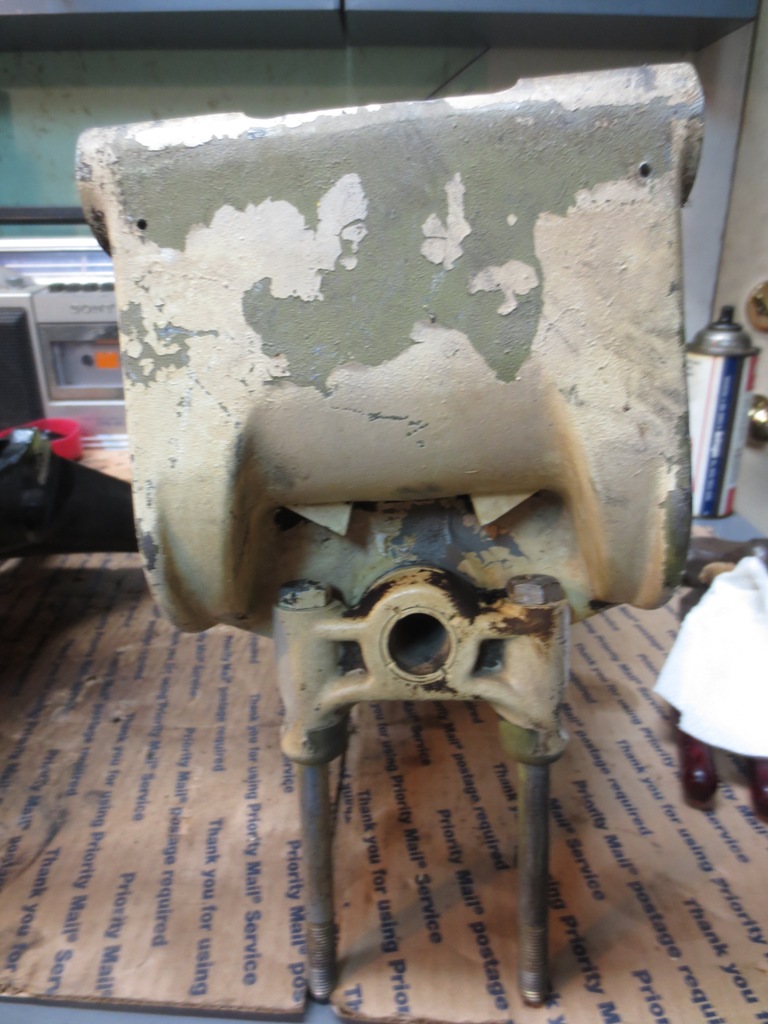

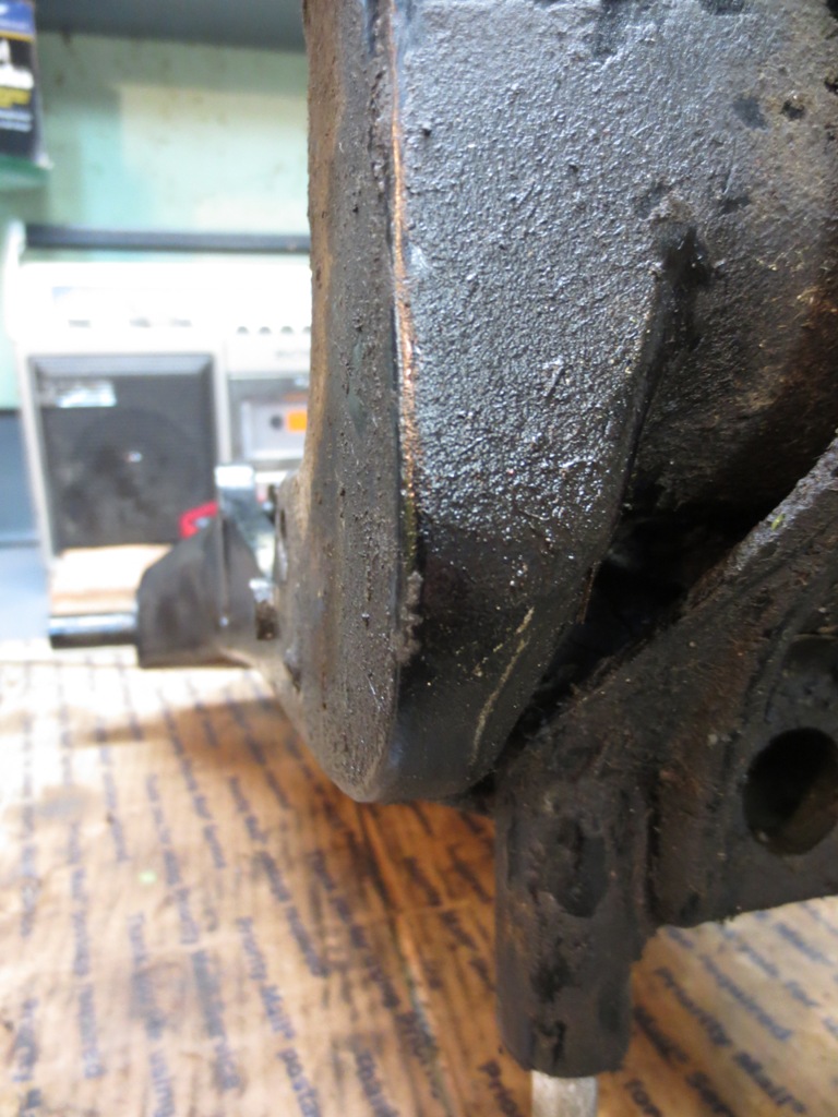

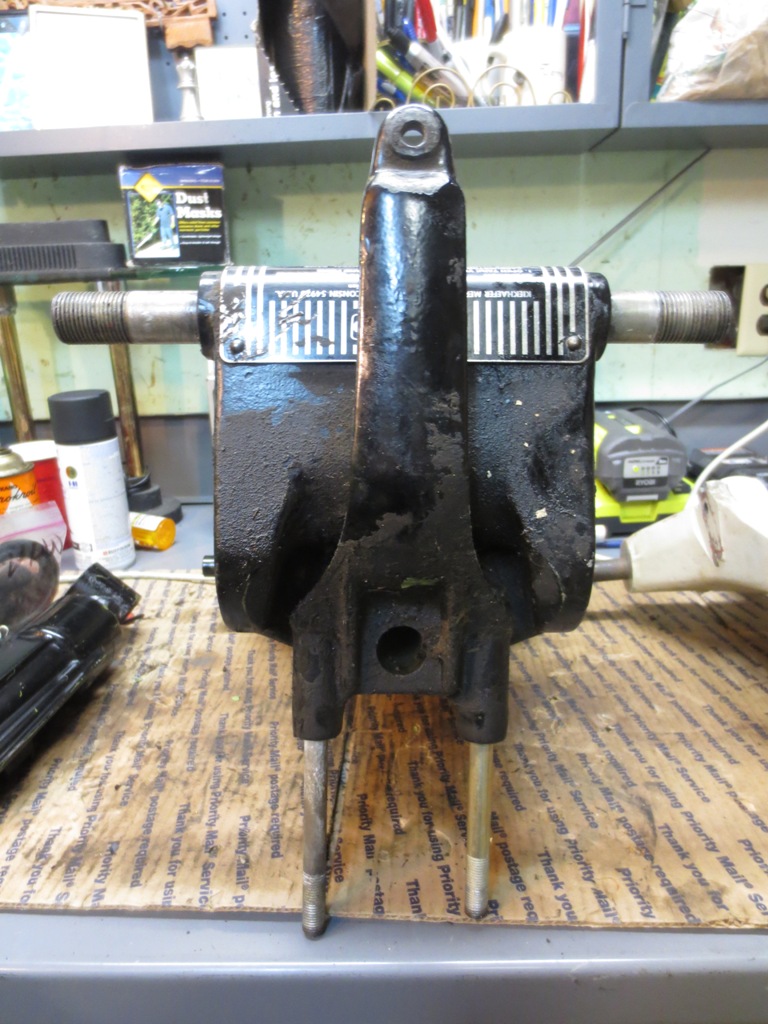

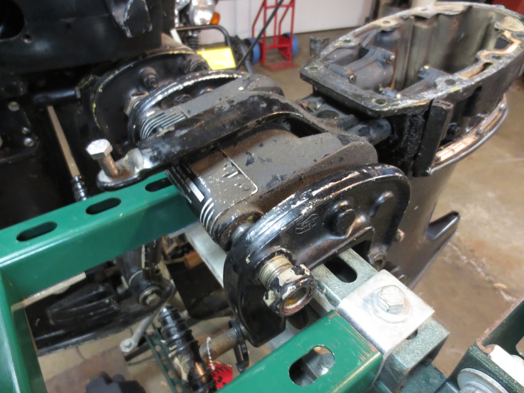

Have the old style (white) and new style (black) swivels sided by side.
They seem to be very similar other than the shoulder where they beefed it up.
Curious what the lever is for and assume its part of the RideGuide steering system.
Maybe time to change over from the cable steering. But not sure if I would be able to use the existing Attwood wheel.
Thanks,
Terry

I've done a lot of Metalizing when working. Really simple (well for a Machinist anyway). Just need the spray gun/torch, toss in a lathe and skin down to good surface metal, low speed build up, and re machine. And price sounds damn good to me!
Inline six power tilt trim 7 years 7 months ago #139174
  • Terrydi
  • Terrydi's Avatar Topic Author
  • Posts: 839
  • Karma: 61
  • Thank you received: 95
Hey Robby,
I had hoped to get down there to see the flame spraying but time did not allow so I shipped and missed all the fun. I had the same process performed on the 800 I’m running now 8 years ago at a cost of $165.00.

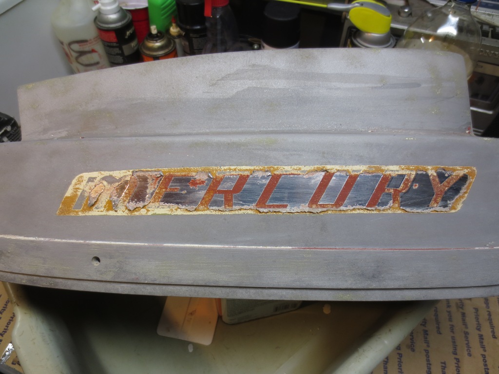

Still blasting cowl parts and could not take off the old decal that had been painted over.
Layered with paint remover and uncovered the original Mercury decal so at least I know now what I need to replace it.
Chrome background with red letters. Anyone know of a source for this style decal?

Check out North York Marine in Ontario. I bought new decals for my '63 Merc 850 from there and they looked great.

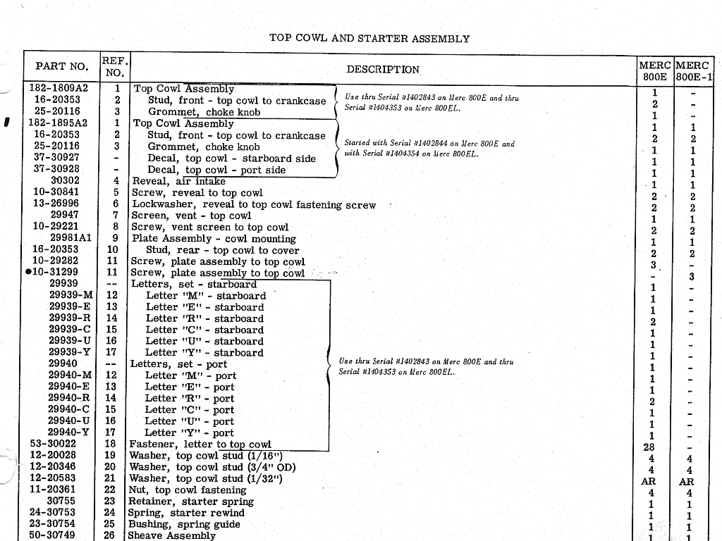

Inline six power tilt trim 7 years 7 months ago #139178
Terry,
That decal is not an original for an 800-6.
The 800-6 had individual chrome letters held in place by push-on clips on the inside.
Unless you find a bunch of holes bondo'd in on the inside, the top had originated on a '62-'64 90ci 850-6 or 1000.
The main decals on the 800-6 were on the cowling wrap.
doc

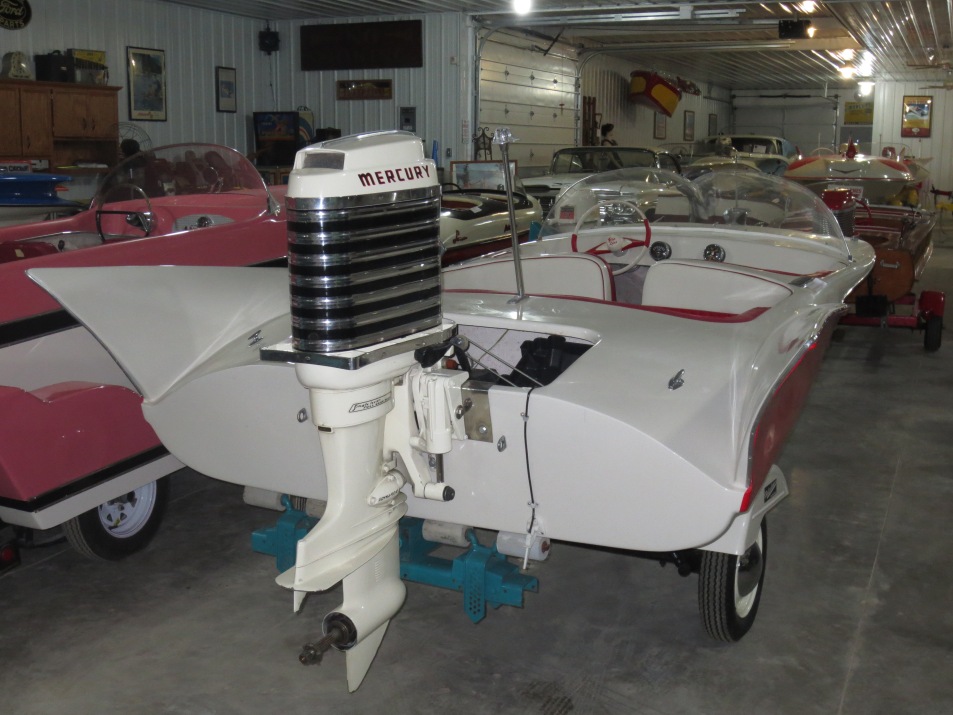

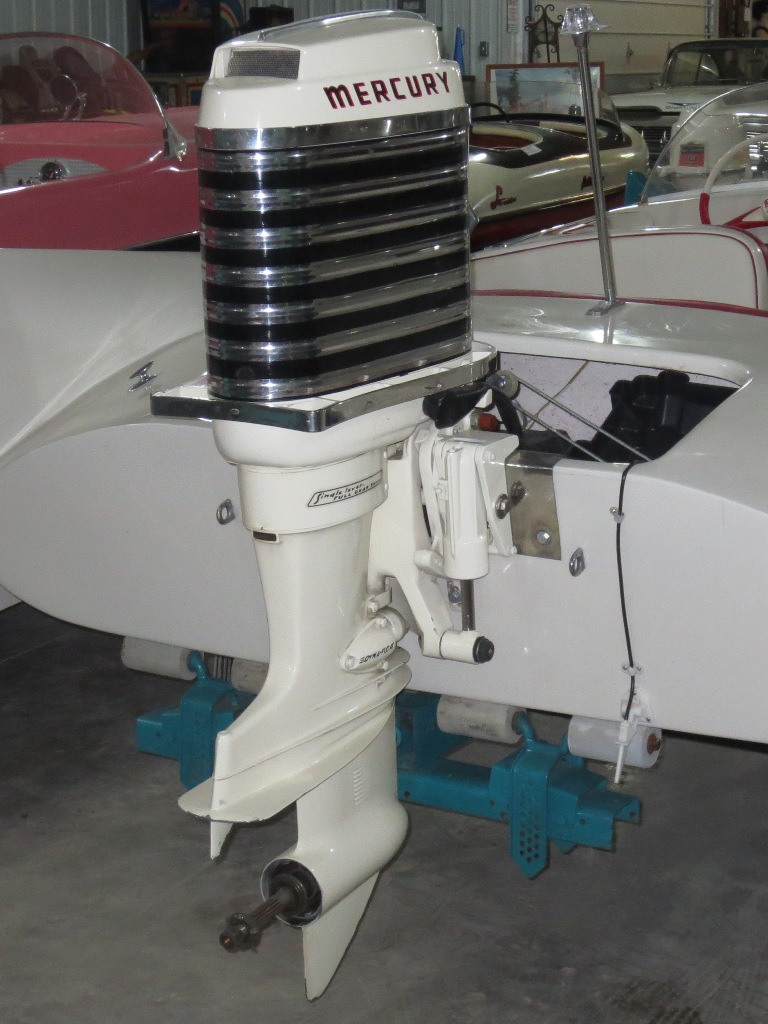

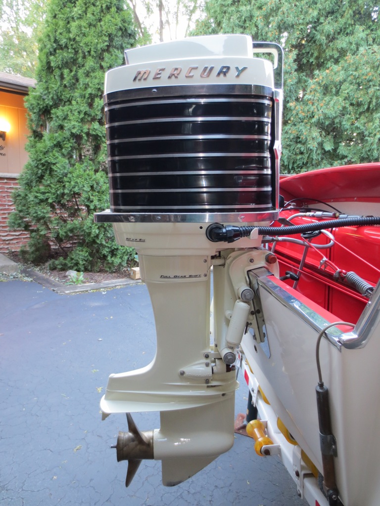

Hey Doc,
That motor looks great on that G3.
In 1961 there were two 800 models. I have both the 800EL & 800EL-1. The -1 model was sold without the cast lettering.
And they used the KA14 carbs rather than the KA11s. Also the upper mount rubber bushings were beefed up.

Thank you Bill,
North York Marine provided a decent replica medallion for the control arm after I destroyed the original trying while trying to remove it.
www.nymarine.ca/
They only show the Full Gear Shift and 80 HP Six decals for the lower cowl and shaft housing for which I have a local source.
I have the Merc part #’s so any easy solution is to simply find NOS decals. Yeah right! So I will probably have to have these replicated. I think the chrome with red letters on the cloud white should look sharp.

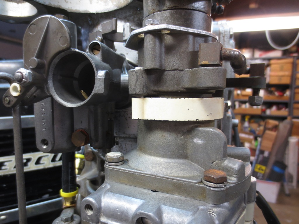

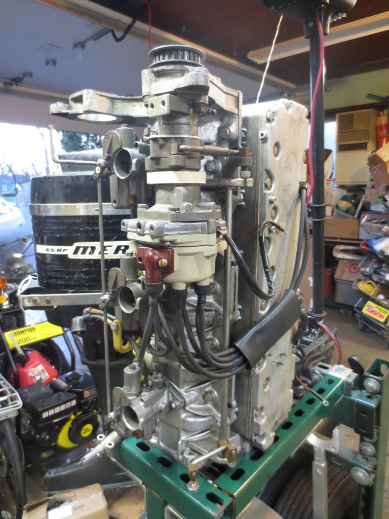

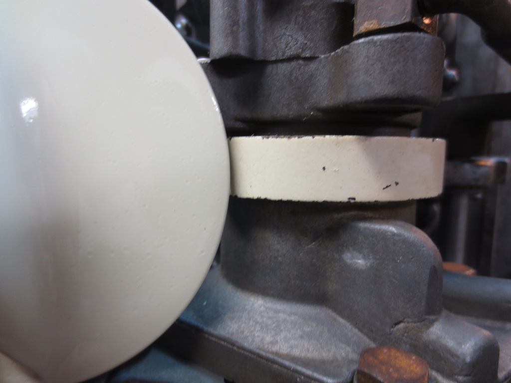

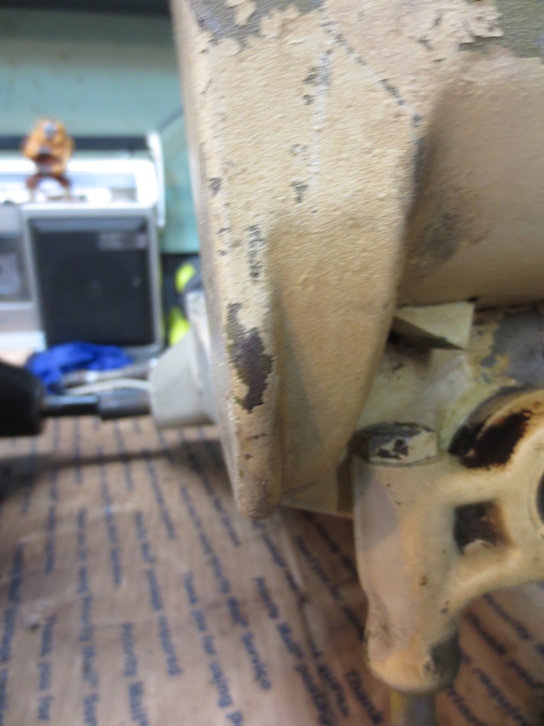

Starting to put his old Merc back together and noticed something interesting.
I have had discussions with fellow Merc folk regarding the Mercury “Cloud White” and what it should look like when properly matched. When I restored the last Merc 800 I matched to the color that was inside the control which had not seen the light of day since 1961.
Some said it was not white enough and appeared to be more of a cream color. And it does appear to have a yellow tinge compared to the white on the boat.
Now I see the horseshoe spring on the distributor adaptor is actually painted “Cloud White”. I had an extra trim tab and painted it when I did the last motor and you can see it’s a damn close match.
I read somewhere that the spring was called an economizer. Not sure of the theory but maybe when throttled quickly the spring expands retarding distributor advance?

Inline six power tilt trim 7 years 6 months ago #139337
when you throttle up, you use the spark advance and not much butterfly. then when you hit the spark advance stop you pick up the butterfly to full throttle. when you use the when you use gas.

Hi Terry,
Looks like good work you are doing. Yes you will need to use a later 67 up swivel bracket, it swaps right on, at least the 20 inch versions do, not sure about the shorty versions. The thrust of the motor is taken up by the tilt tube and the trim bracket bolt holding on the trim cylinder so loading is very different than the swivel bracket just pushing against the tilt tube and tilt pin, that’s why things broke. You should make sure your trim limit switch is working, that’s in one of the trim brackets, it prevents the swivel bracket from trimming outside of the clamp bracket tilt pin ears when under power, trimming beyond OK at idle only.
The drive shaft looks phenomenal! I scoured for years finding stainless replacement shafts, hard to find items where Merc did not make them for the early FGS motors as a service part for many years. I’ve also used the speedi sleeves but wow I like your option.
Also, I have an 800 top hood with the separate lettering and pretty sure I’ve got the 800 faceplate , I know I have the jacket with a few dings but easily fixed. Just PM me. I thought I was going to build an 800 so I collected parts but went with a 1000.
Randy

Joe Poole recommended replacing the swivel so I have one from a 1970 motor I will use. It has a steering lever and Joe says I need to cut it off for the original cowl to fit.

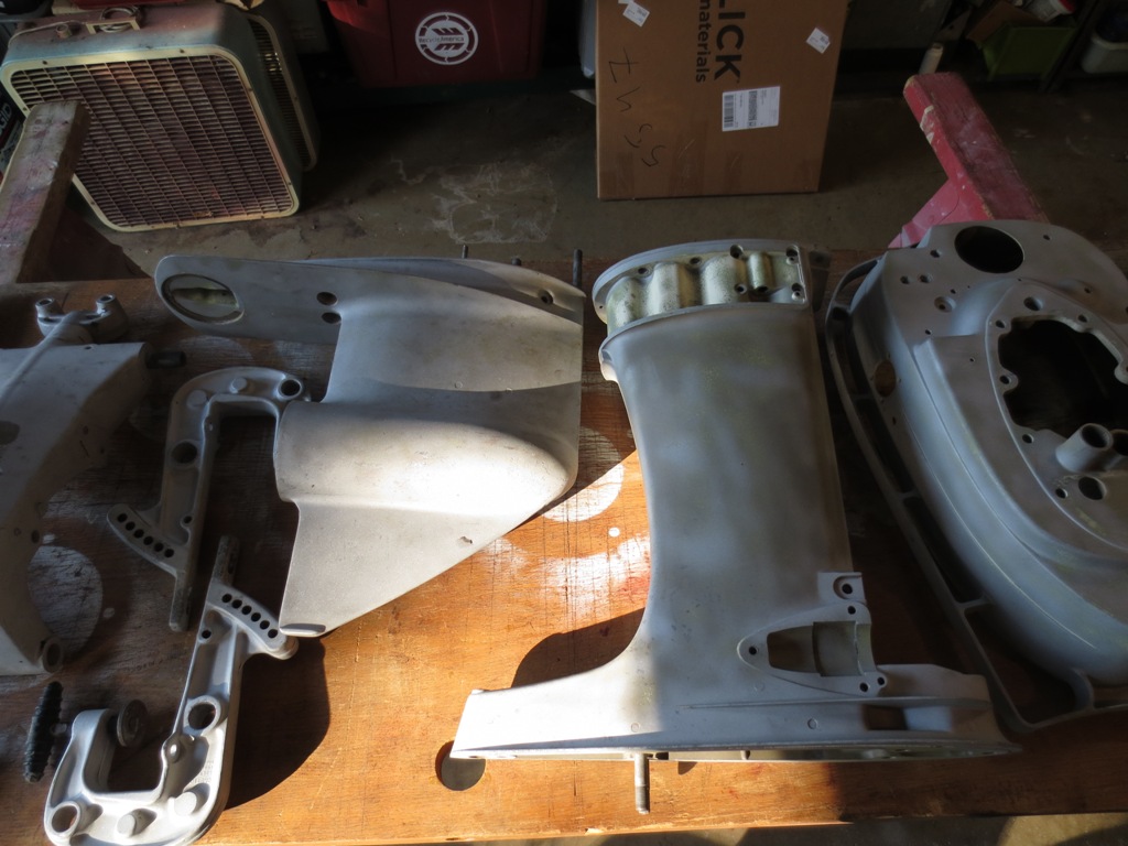

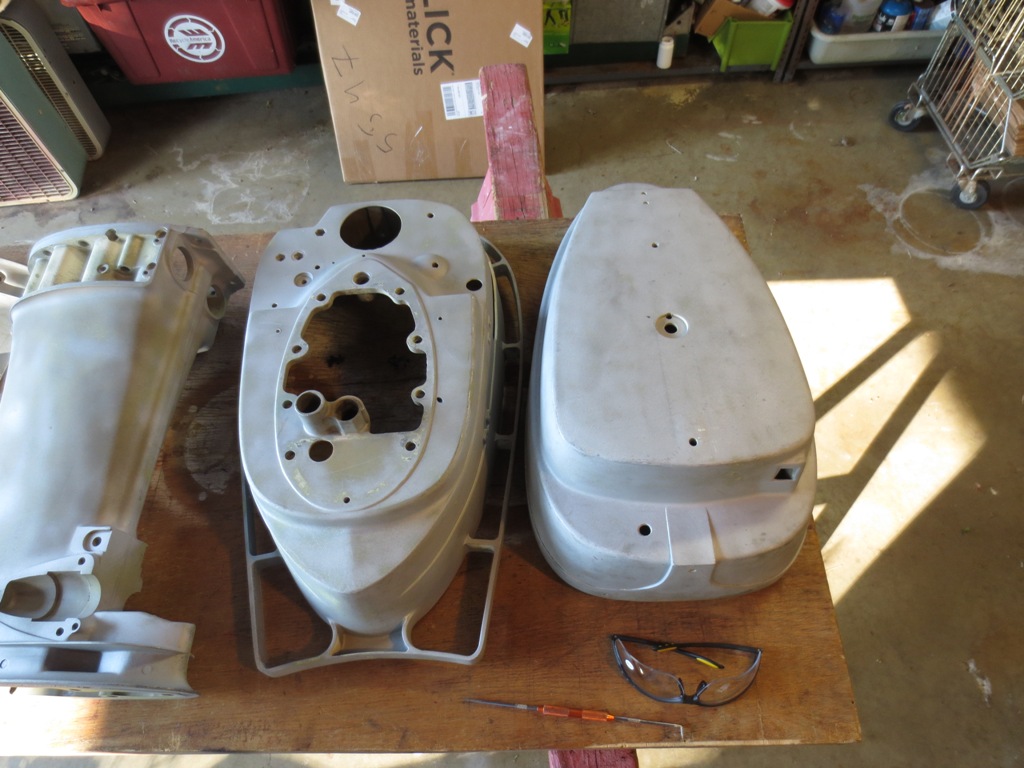

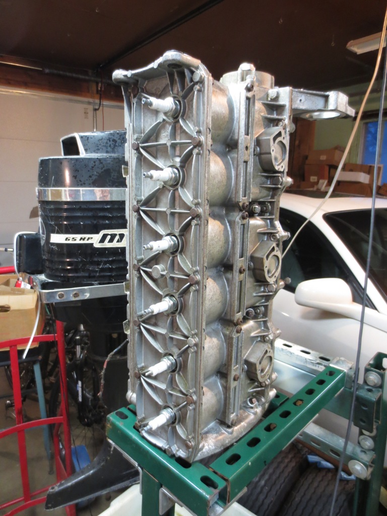

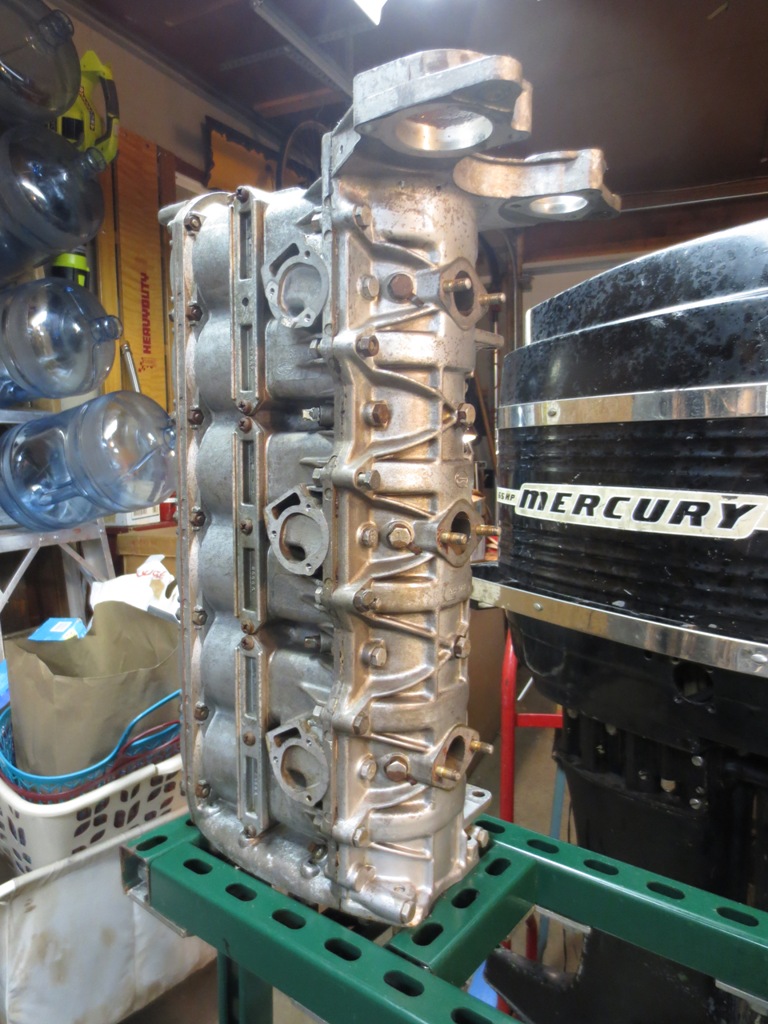

Finally finished blasting and getting ready to paint now.

I’m working with a local Axalta dealer and they do have a devise that scans and matches an existing color. They need a sample with a flat surface minimum 2x2 inches so I’m going to bring them the cowl top to scan. My question was what type of paint others have used although I will probably go with a polyurethane which I have some experience spraying and had good results.
I sprayed the motor well and this trim piece with polyurethane six years ago and it still looks good today.
Dr Go,
After sand blasting the surface is roughened but does not require further sanding before the primer. There are other media that can be used such as bead or baking soda and will result a smoother surface.
The high build primer fills any defects and is then sanded smooth.
Yes, the Merc controls were painted to match the motor.

asign Mary,
Do you think you could replicate the Mercury decal I posted here?
Thanks
Terry

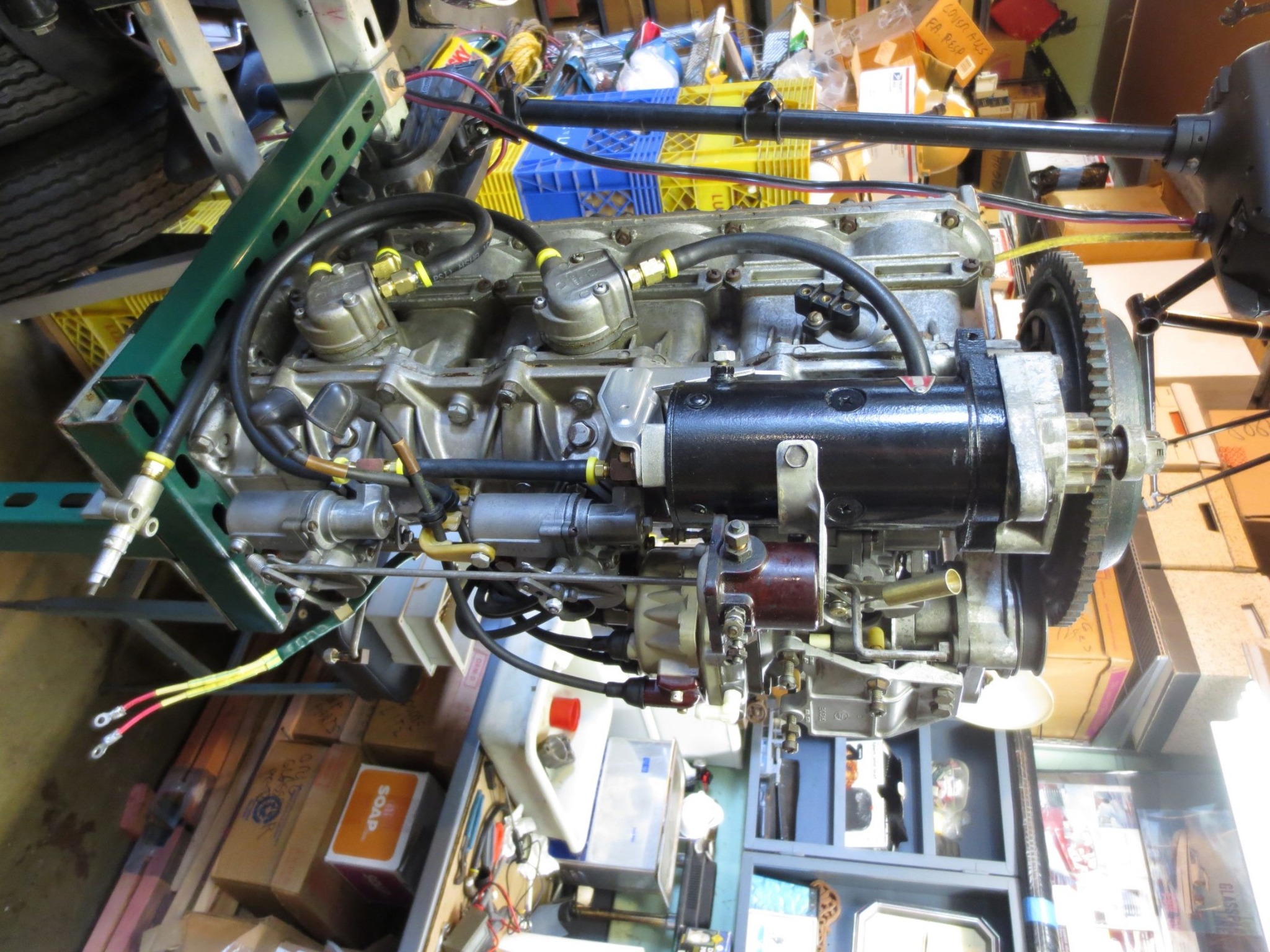

Does it have a flex flywheel? if so the flex plate may be cracked.
Inline six power tilt trim 7 years 5 months ago #139653
  • Terrydi
  • Posts: 839
  • Karma: 61
Thanks Dave,
Not sure what you mean by flex flywheel?
These are the best shots I have of it. I cleaned it up real good and did not notice any defects.
Sorry for the flopped over pics.
Terry
Inline six power tilt trim 7 years 5 months ago #139656
no yours is not a flex. may be just piston slap.
Inline six power tilt trim 7 years 5 months ago #139658
  • ed-mc
  • Posts: 1482
  • Karma: 235
  • Thank you received: 131
Kinda strange intermittent sound, I wonder if the recoil starter pawls are bouncing off the flywheel tangs. I suppose you could positively rule that out by pulling the top hat and running it without. You'd be able to get at the top bearing cap with a screwdriver or stethoscope and see if you can hear an internal rattle.
Inline six power tilt trim 7 years 5 months ago #139694
  • Terrydi
  • Posts: 839
  • Karma: 61
Thanks Merc Guys.
Dave,
You suspect “just” piston slap. I assume that would be an indication of worn rod bearings.
ed-mc,
Pulling the cowl top is an idea although it came off another powerhead where there was no issue. The noise does seem to emanate from inside the motor.
Terry
Inline six power tilt trim 7 years 5 months ago #139695
could be worn bore and pistons. rod bearings would be a knock.
