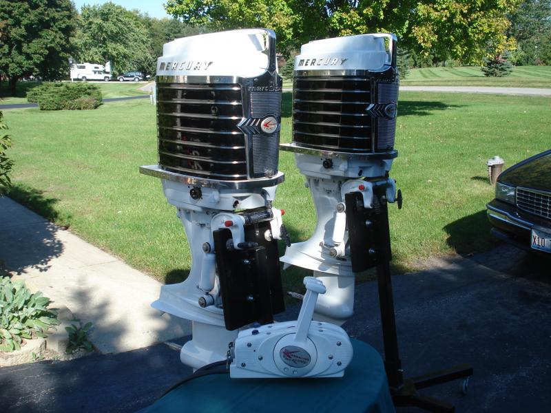

I am approaching being in the market for some early 60's 6cyl Merc's. Probably 850 up to 1100 with controls. While I know that with a little looking, I could find some cheap motors here and there, I don't have the expertise to properly rebuild these. I found the attached picture on the internet that is close to what I am looking for, but wow, what would take to buy a set of these!!!

BTW those beautiful Mercs in the pic you posted aren't FGS models, but Direct Reversing. Aka "Dockbusters". Even rarer to find a pair of 800 Dockbusters! But they sure would make a classic boat fly. They'd look really good on a Powercat.

Agree with the above. Also, I believe those are from classicmercuryoutboards.com out of Hayward Wisconsin. classicmercuryoutboards.com/

You asked what it would take to buy something like those......DEEP POCKETS.

Thanks for identifying the photo for me, I wasn't sure where I had gotten that from. I don't have any engines right now, and when I do run across them for sale, they are usually laying in a field or the back of a pickup. Sure it may be rebuild-able and I may even be able to do it myself, but it the long run it would be much better to have a reputable builders paperwork to back it up. Besides, I am looking for something I can mash the throttle on without feeling like I am just sitting there waiting for it to fly apart. I really like the look of the 850 but I have to admit that a little more horse power is always exciting.

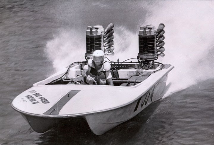

Just a side note and as I said I'm not a racer, and I'm not, but this thing really looks tough...

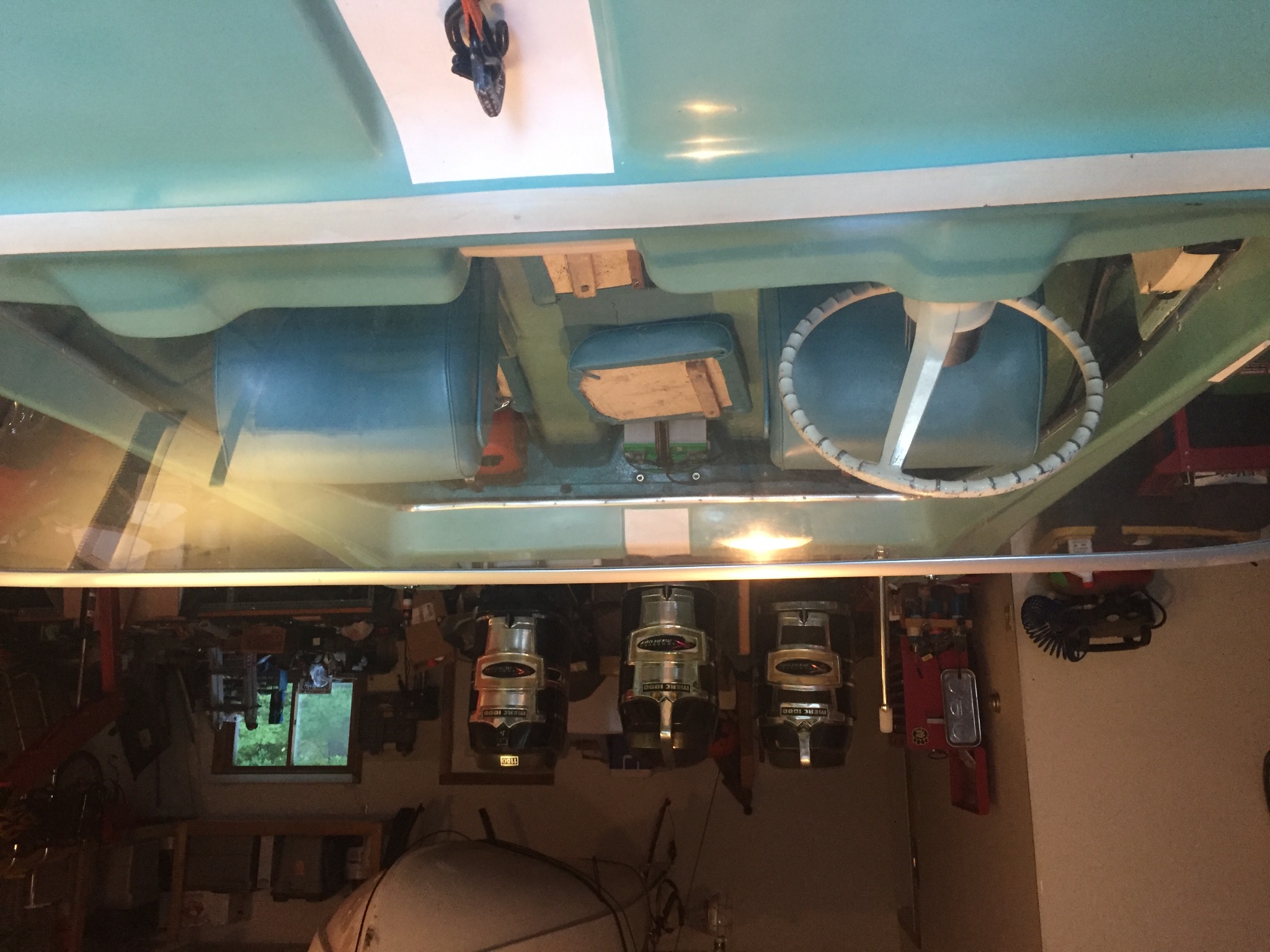

I remember dad asked an 18c Powercat owner with twin 110 Mercs how fast he could run and the reply I recall was cracked into low 70’s.. I would bet Frankenmerc 1000 powerhead engines built by the Doctor and put into cloud white motor cases would likely crack 70 or certainly near it one side or the other. That would be one sharp rig. I am sure if you contact Powercat himself on here, he likely would be able to give you great information on the Powercat and what each model can do. Mr. Danny Leger. That twin set up will get some attention, so add some extra time every time it makes a public appearance because someone like me would love a closer look and hear the boat’s history. Good luck. No- I am not going to do what you see in the pictures, but fun playing in the garage. TheToyBox did triples on an 18dc and knows his stuff. My 15T is too short and shallow short shaft to get too crazy. Just trying to throw some gas on your burning fire lol.
