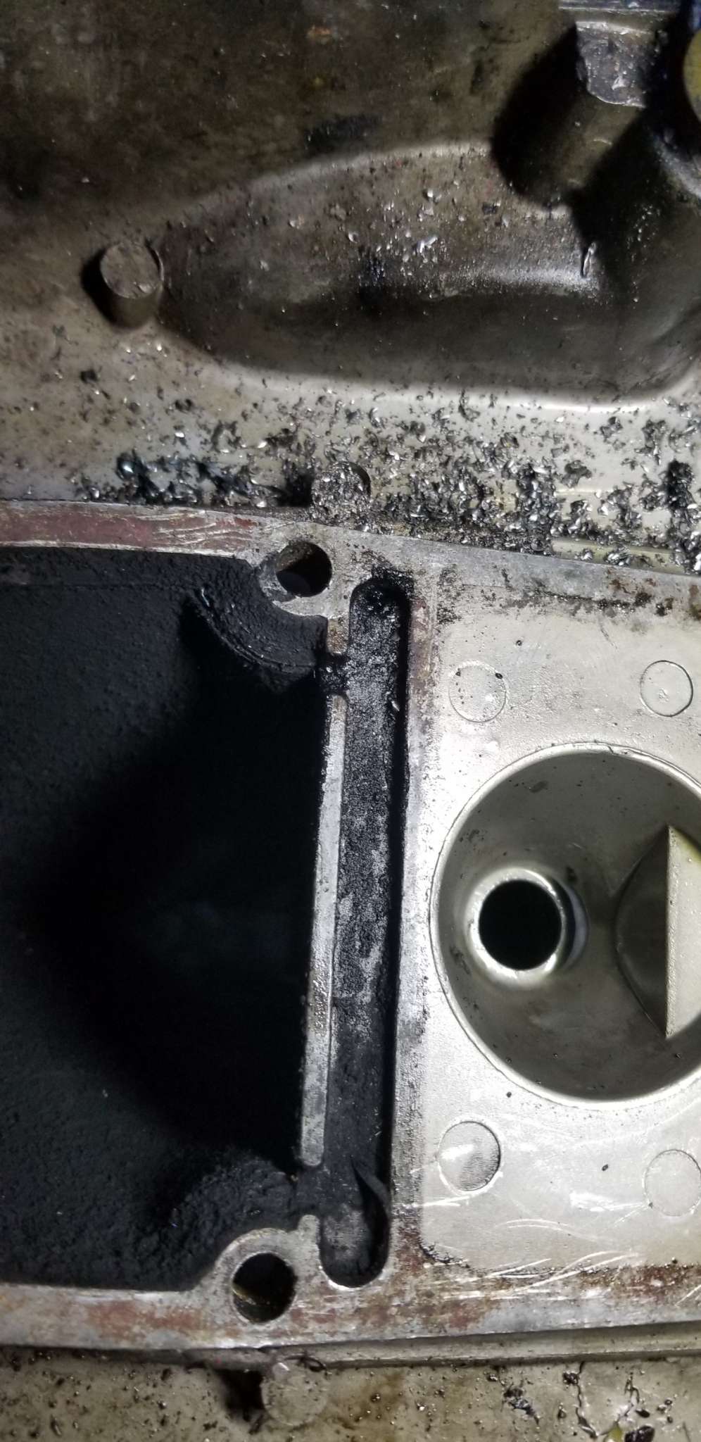

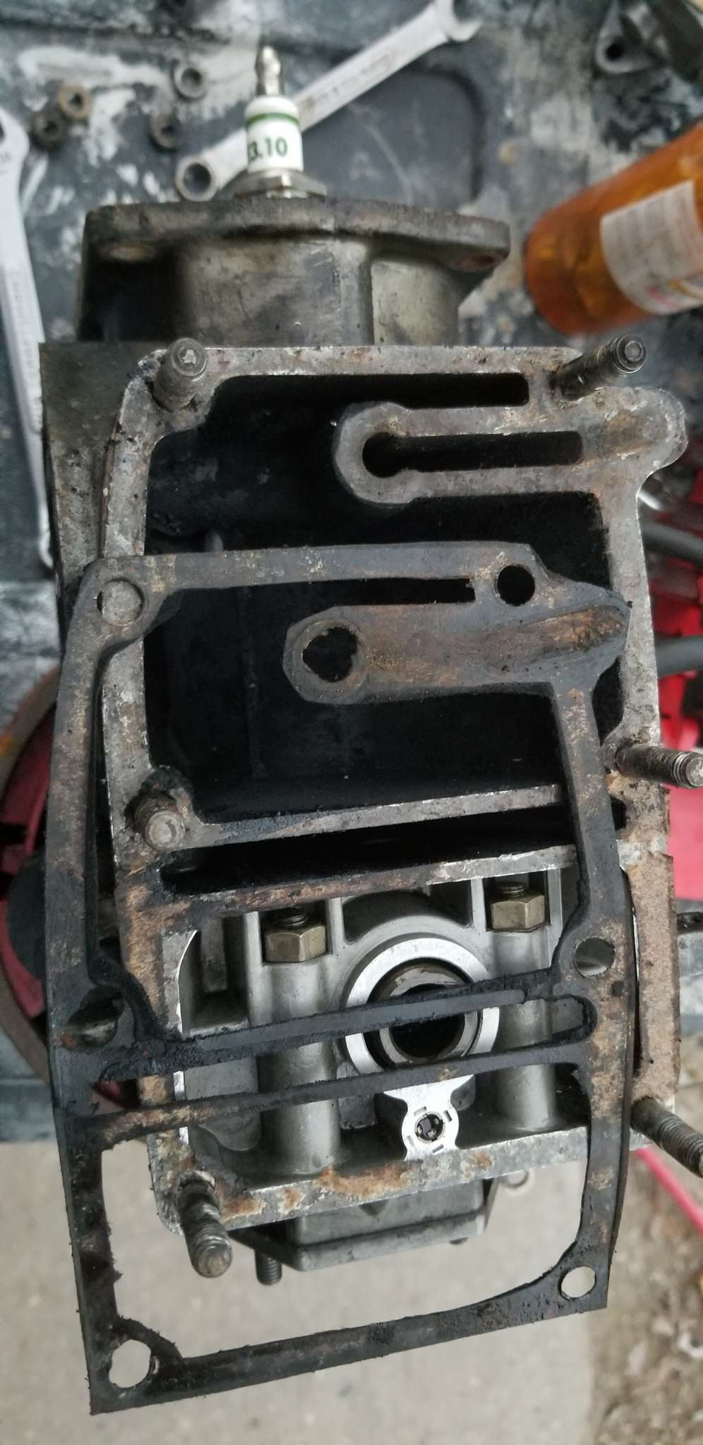

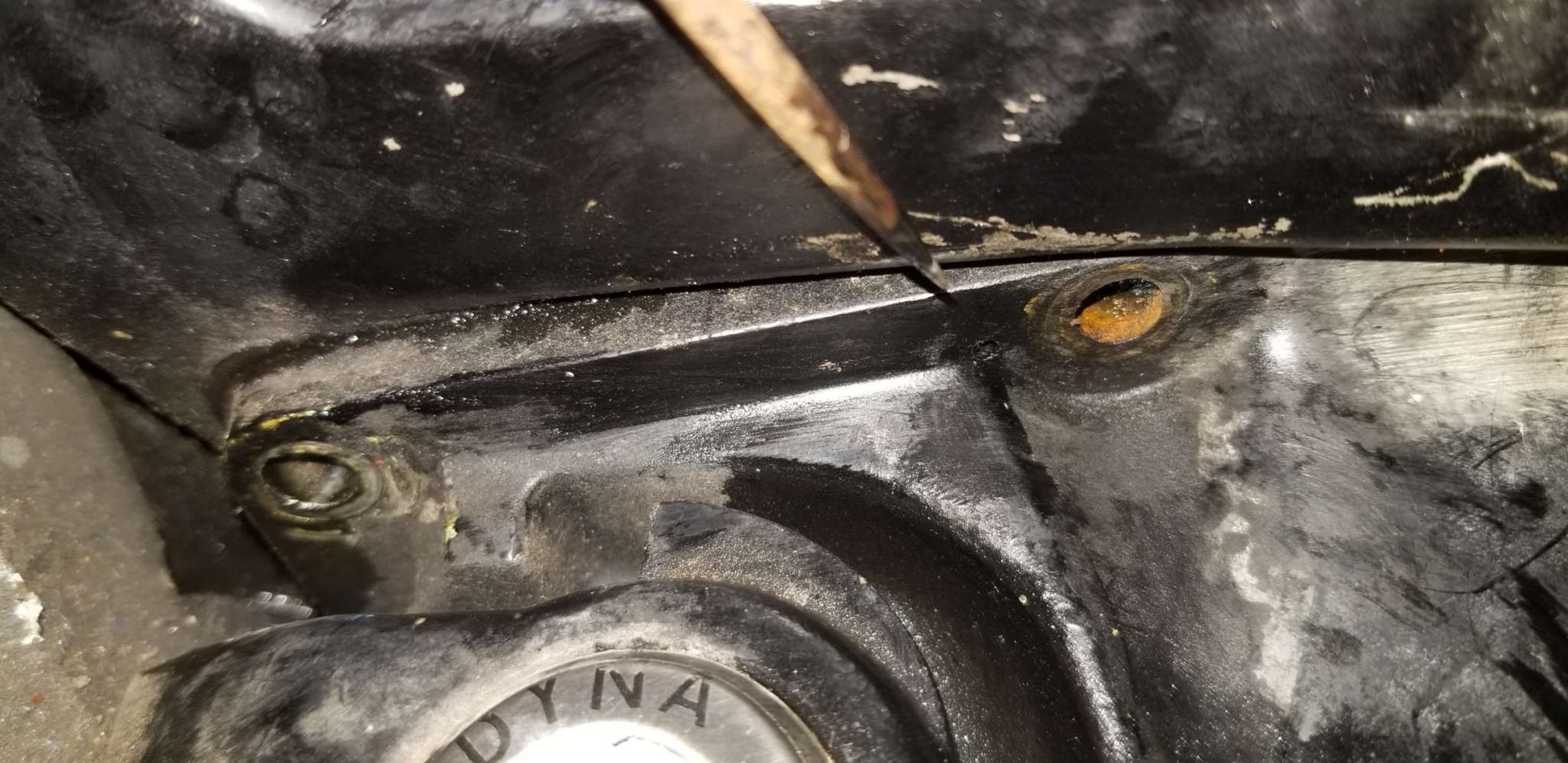

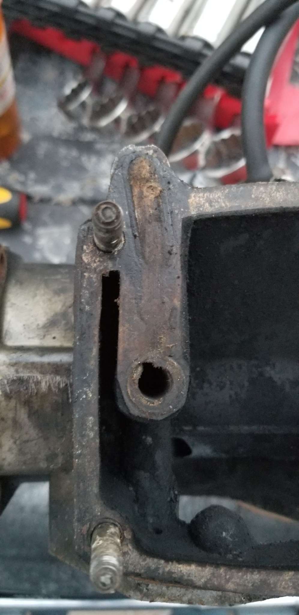

1965 Merc 39 Questions 8 years 1 month ago #137366
So I decided to pull the powerhead to check out why my flush port was plugged. It turns out the last time the gasket was replaced, it didn't have a hole to allow water to flow! Now that I see where the flush port is in relation to water jacket flow it wouldn't be the best place to add a tell tail to make sure the entire engine is getting water.
I also could see where the tell tail is supposed to be. Thank you Dave for the advise. I just could not see that tiny hole packed with black carbon next to the Phantom black paint! One more reason I like the Cloud White Mercurys more. Lol
Now I need to order up some water jacket and carb gaskets. Also broke all but one screw in the exhaust water jacket. I still need to drill one more out.
