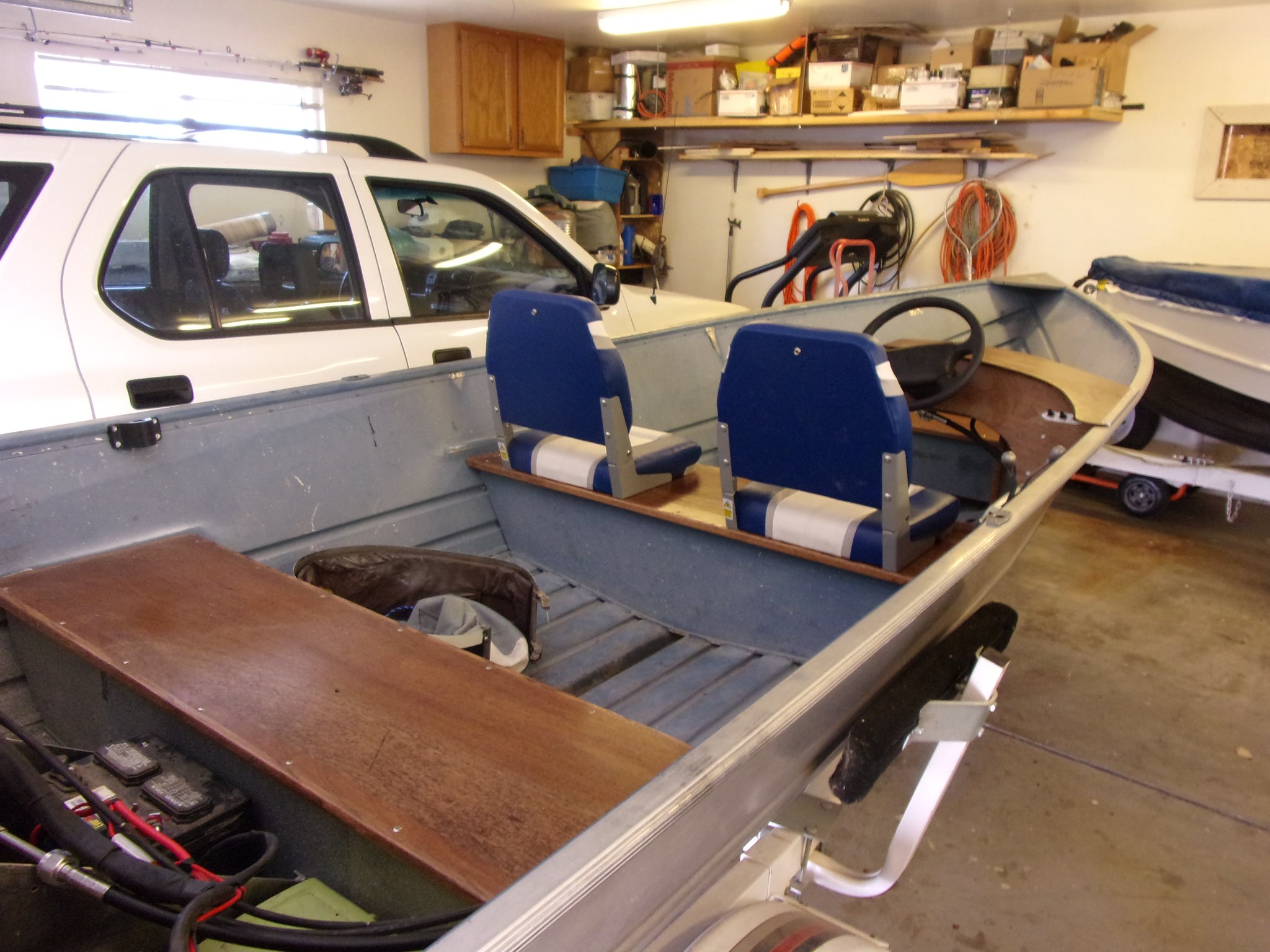

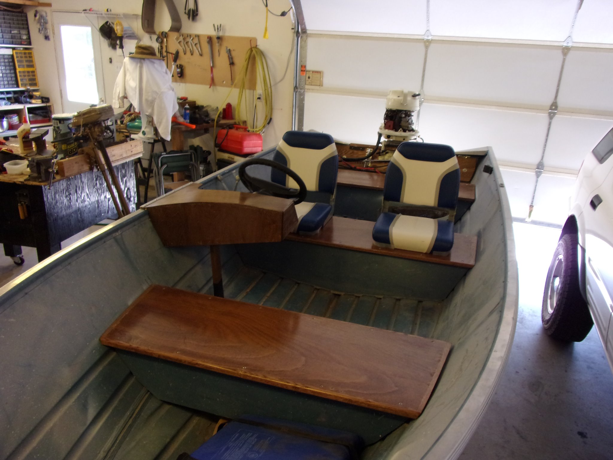

2 years ago I tuned this up and put new impeller in it. Ran it in the barrel a couple of times. It would run hot at slow to fast idle. Crank it up to 2,000, it would start cooling down. Never ran it on a boat. Got it mounted on my 14' Klamath with added forward control. Same problem. Pulled the lower unit off, Impeller is still perfect. Blew all the lines out. Made sure the upper water tube went into the grommet. Still runs hot at slow speeds. Gets up to 180 - 200 and I shut it down. Running out of summer and luck too.
Any ideas? Thanks Hugh
