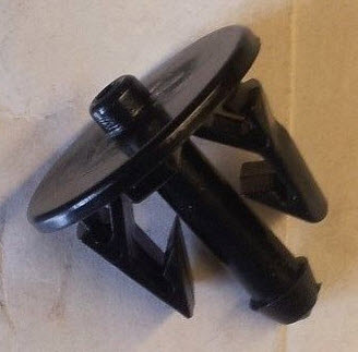

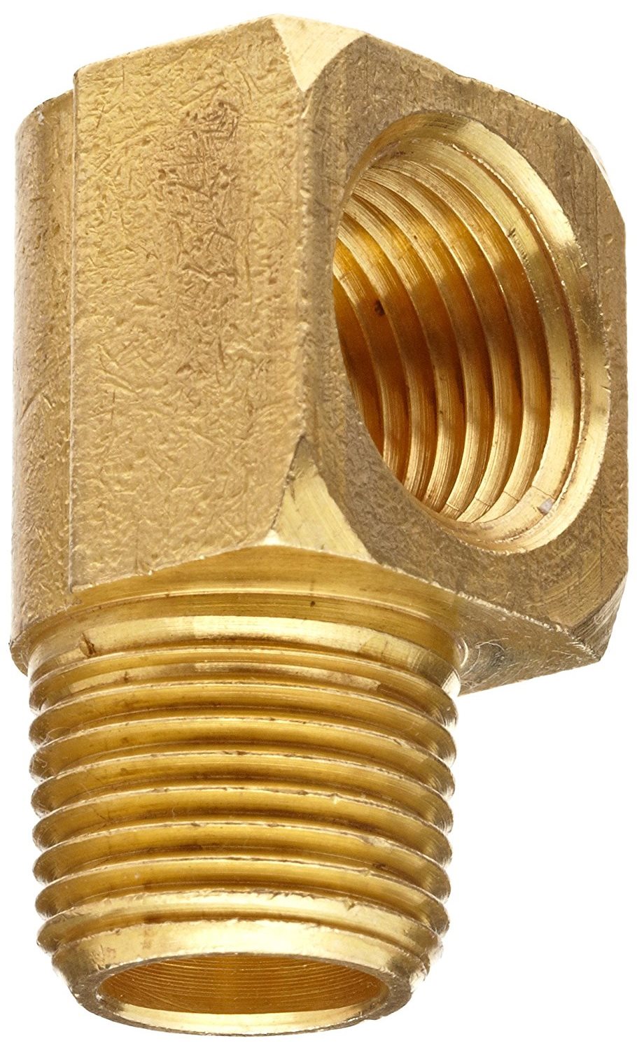

There's another way to get a telltale, you should have a 1/8" NPT slotted plug at the top of the powerhead on the manifold side. If you can get this plug out, you can install a 90-degree fitting and then run a telltale hose to the right side of the lower cowling, at the rear. Then devise a thru-fitting with a restrictor to give your telltale a nice spray.
The telltale fitting off a Johnrude 3-cyl or V4 might be a good fit for this application, you drill the hole and then the fitting snaps into the hole, held in place by built-in clips. See attached pics for a few examples.
I got the brass 90-degree fitting off Amazon:
