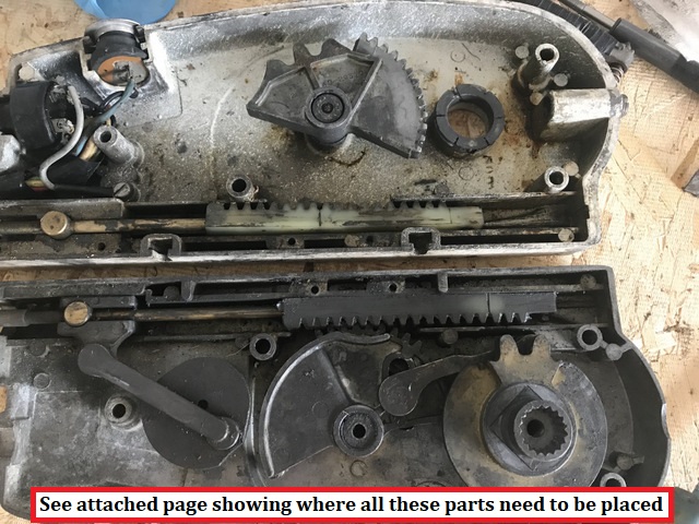

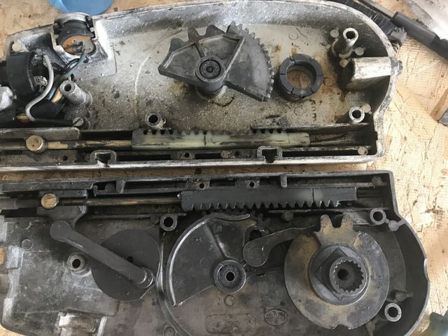

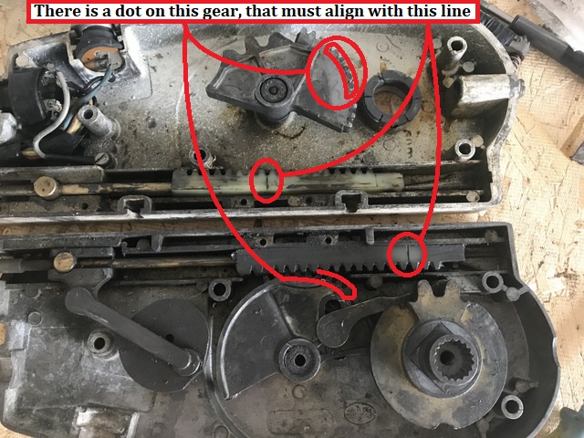

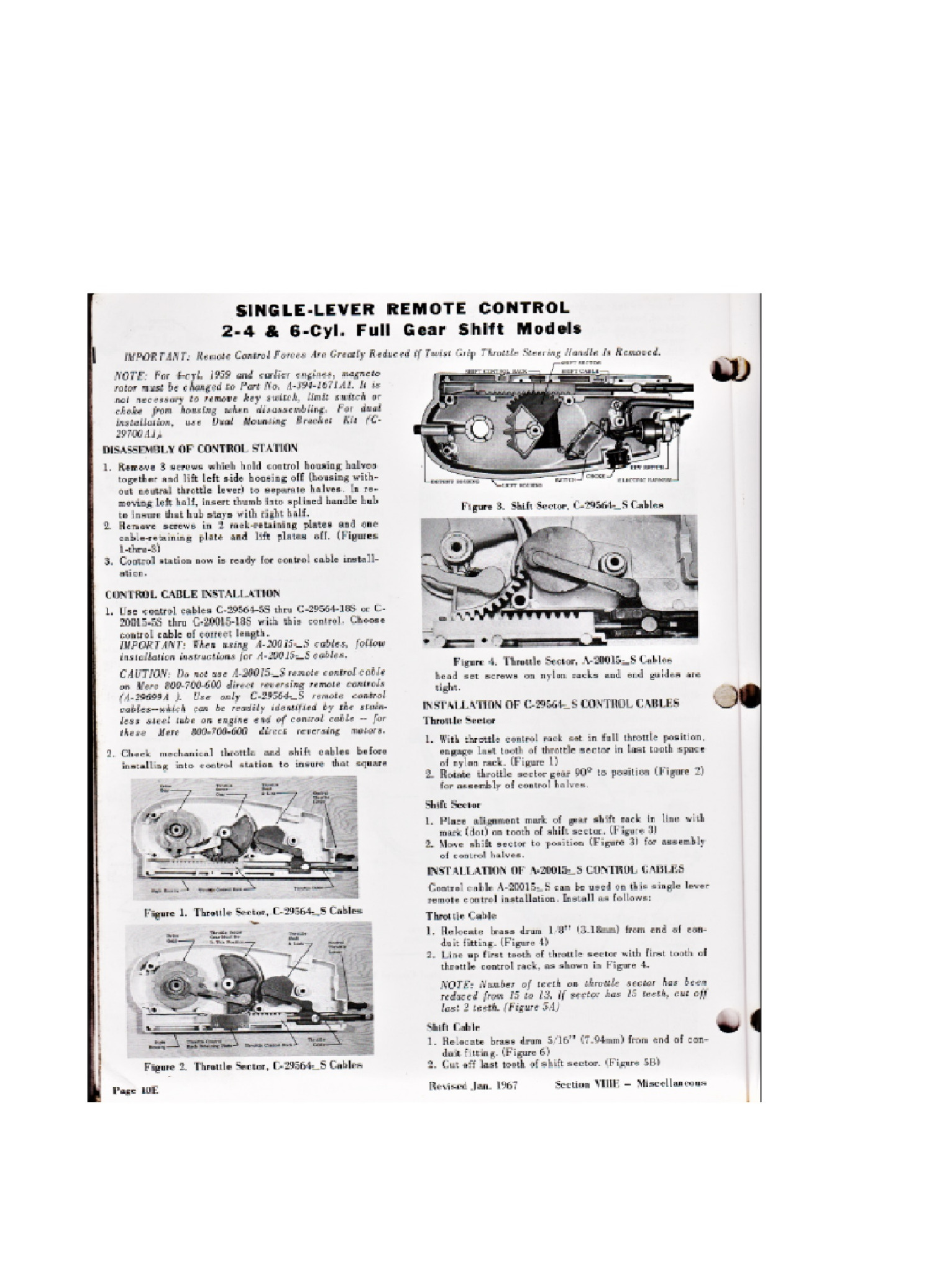

Small chance I'm thinking, but does anyone know how to set the gears when putting back together this vintage mercury shifter. Or maybe where I can find a manual? One of the nylon gears broke last year. I took it apart (with out pictures :( and now I'm stuck)
Mercury Shifter/throttle repair 8 years 4 months ago #136805
See attached pictures.
