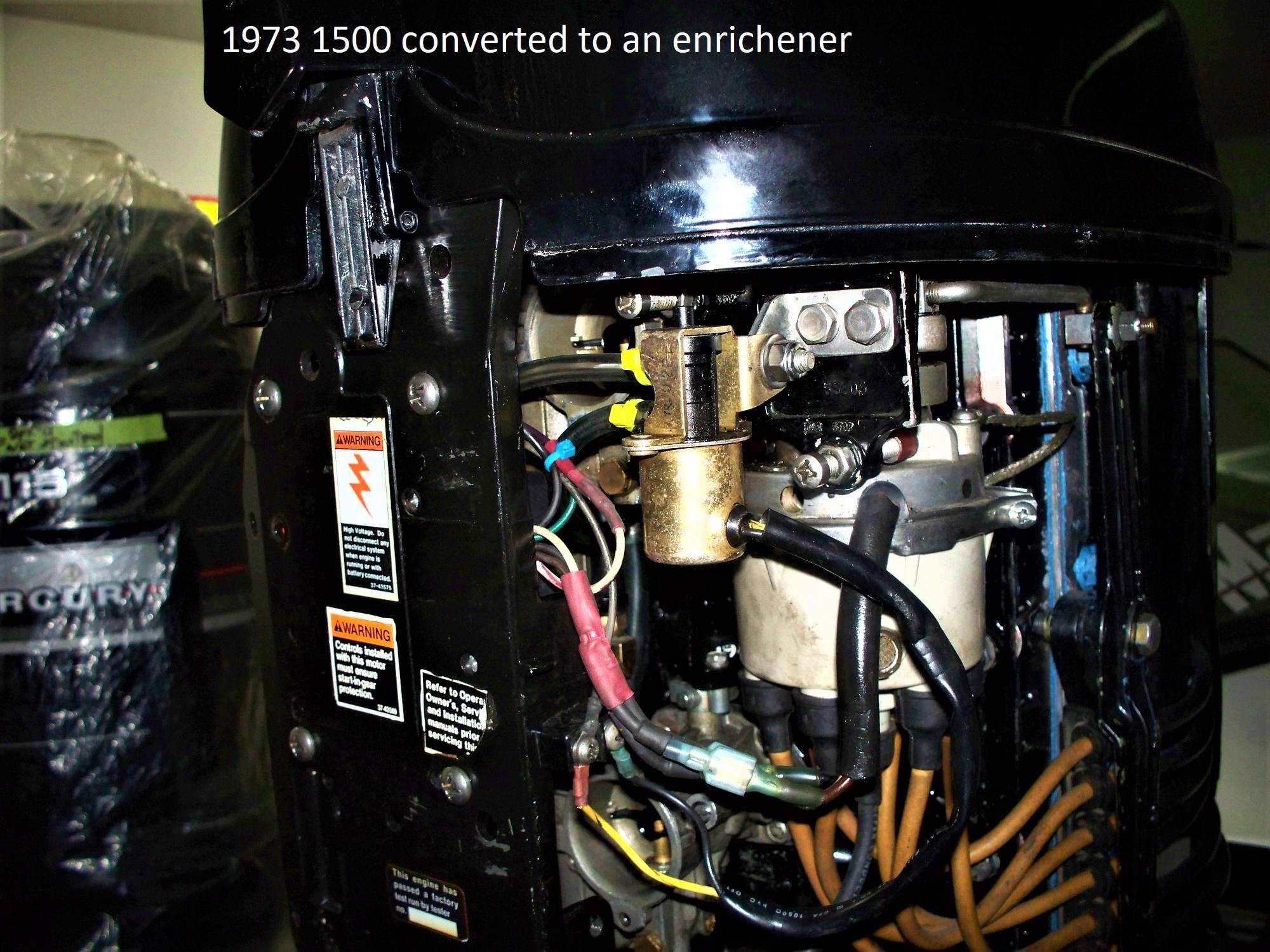

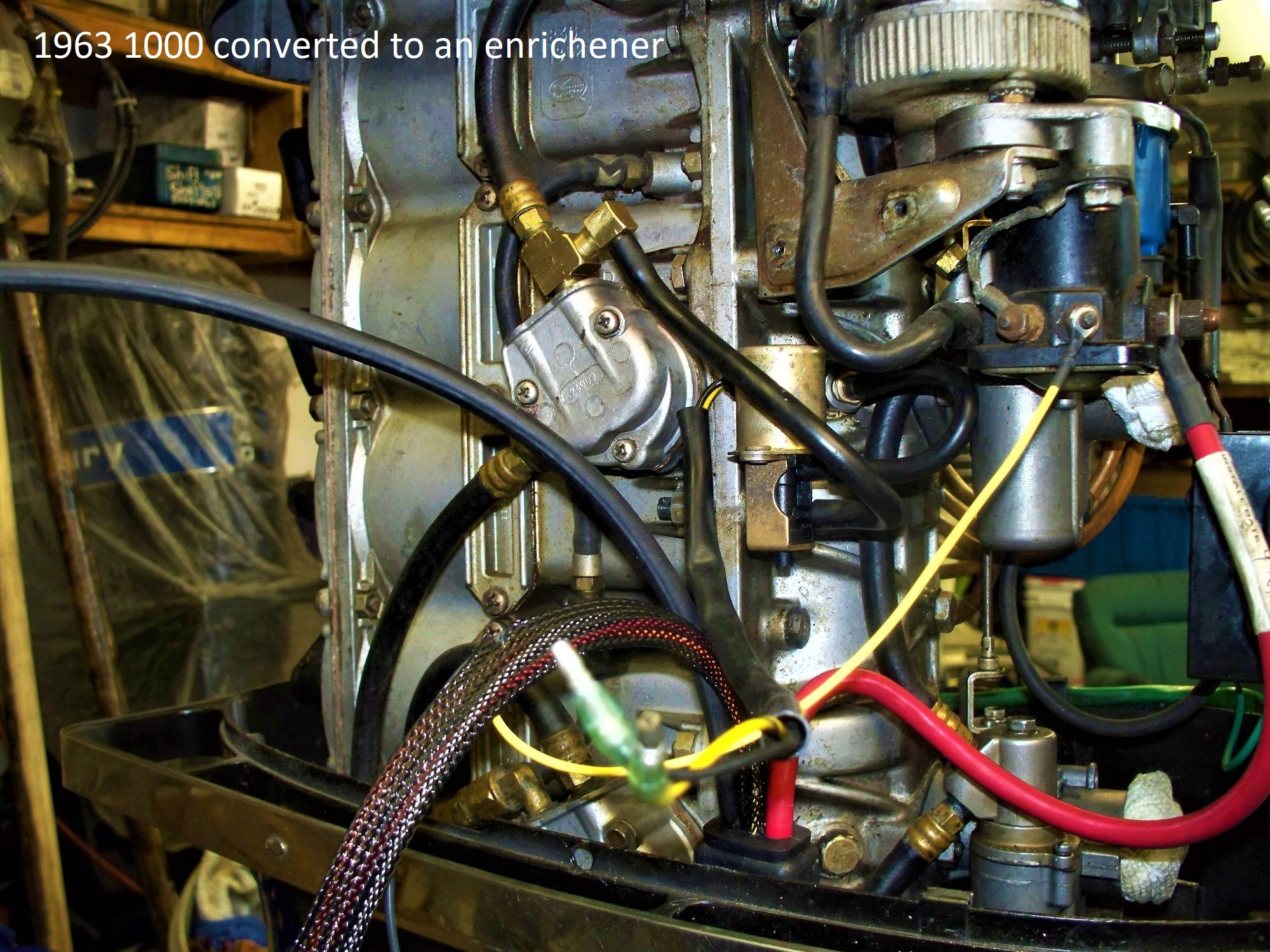

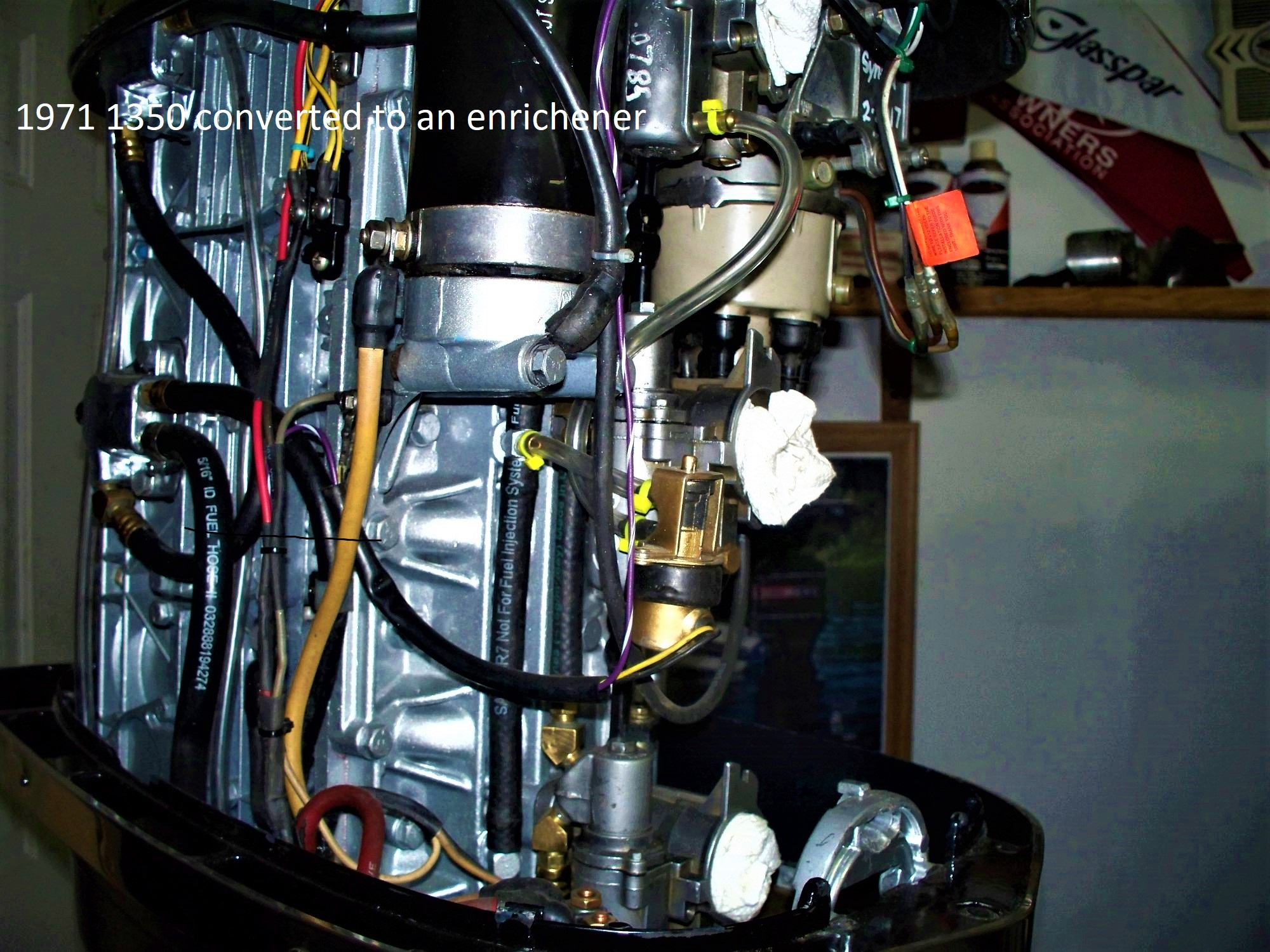

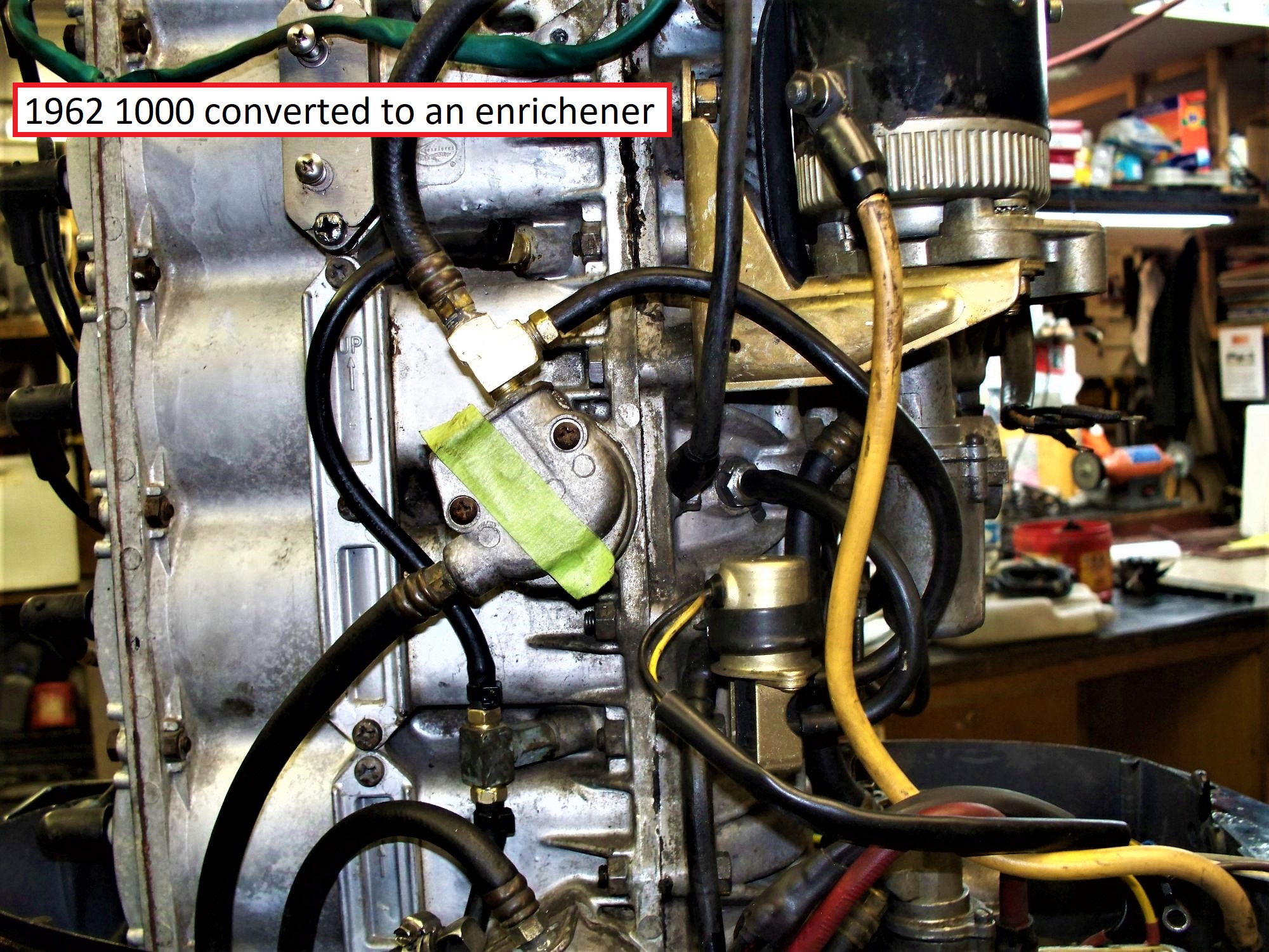

1972,115,cold start 8 years 5 months ago #136349
I have attached pictures showing various ways I have installed an enrichener on the inline-6.
I don't care for the way I mounted the enrichener on the 1973 1500, as the other installs are much easier.
The earlier inline-6 Mercs with (3) choke butterflies rarely need the conversion to obtain a quick cold start, but I've been installing them anyway.
Once installed, the starting sequence that works best is:
Squeeze the prime bulb until firm.
Turn the ignition switch to "ON", and press the choke button - or 'push-to-choke'.
Go back a firm up the prime bulb again.
Advance the throttle, turn the key to 'START', and push the choke again if the beast hasn't started yet.
You won't believe the difference is a cold start.
doc
