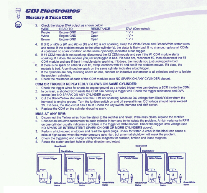

Your 50hp 2-stroke isn't extremely complicated, the most radical change they made on the later motors is with the ignition system. Instead of individual switch boxes and coils, they have gone to what is called a "CDM" Which may stand for "Capacitance Discharge Module" or something like that, I didn't find any good clarification on the acronym in an internet search.
At any rate, your engine has (3) of these CDMs. One per cylinder. They are a combination of coil and ignition module in one. You still have a stator, and a trigger assembly under the flywheel.
The stator windings could be bad. You can tell this with a resistance check, usually. The trigger usually has one segment per cylinder, so the whole thing would have to be burnt out in order to work. Not as likely to happen, typical trigger failure causes a loss of spark on one or a few.
These models suffer from broken flywheel magnets. They also complicate things by having a rev limiter that can fail. Obviously the mfrs have never heard of K.I.S.S. - - Keep It Simple Stupid!
Here are some of the electrical components on your engine:
CDMs: www.marineengine.com/parts/mercury_marine_parts/sn/0T981538/1050412DD/11493_30
Stator and Trigger: www.marineengine.com/parts/mercury_marine_parts/sn/0T981538/1050412DD/11493_40
One other thought, this is a typical ADI (Alternator Driven Ignition) system that is grounded to kill spark. So if there's a problem with the kill switch or shorted-out wiring somewhere, you'll have no spark. So one of the 1st troubleshooting steps is to disconnect the ign kill wire(s) at the motor and see if you regain spark. That's a black wire with yellow stripe.
I did find some info at CDI Electronic site on troubleshooting CDM ignitions.
It's easier to download the 50Meg file on a PC and view/print pages in Adobe; failing that, the online interface is clunk, but works. Online link is listed 1st.
www.cdielectronics.com/troubleshootingguide/
Info for your 3-cyl, 2-stroke 50hp is on pages 109 and 110 of the manual.
www.cdielectronics.com/wp-content/uploads/2016/12/7th-Edition-Troubleshooting-Guide_RS.pdf
I scanned-in the 2 pages and they are attached. There's quite a few things involved with the troubleshooting, so be sure to carefully follow the sequence outlined. Those CDMs can be a real Bugger!
I'd much rather work on the older models. The new ones are all fancy and such, but they use lots of plastic parts and it seems the mfrs have gone out of their way to make them even more complicated and hard to work on. They obviously don't want you to fix an old motor, just buy a new one!
HTH & G'luck.........ed
