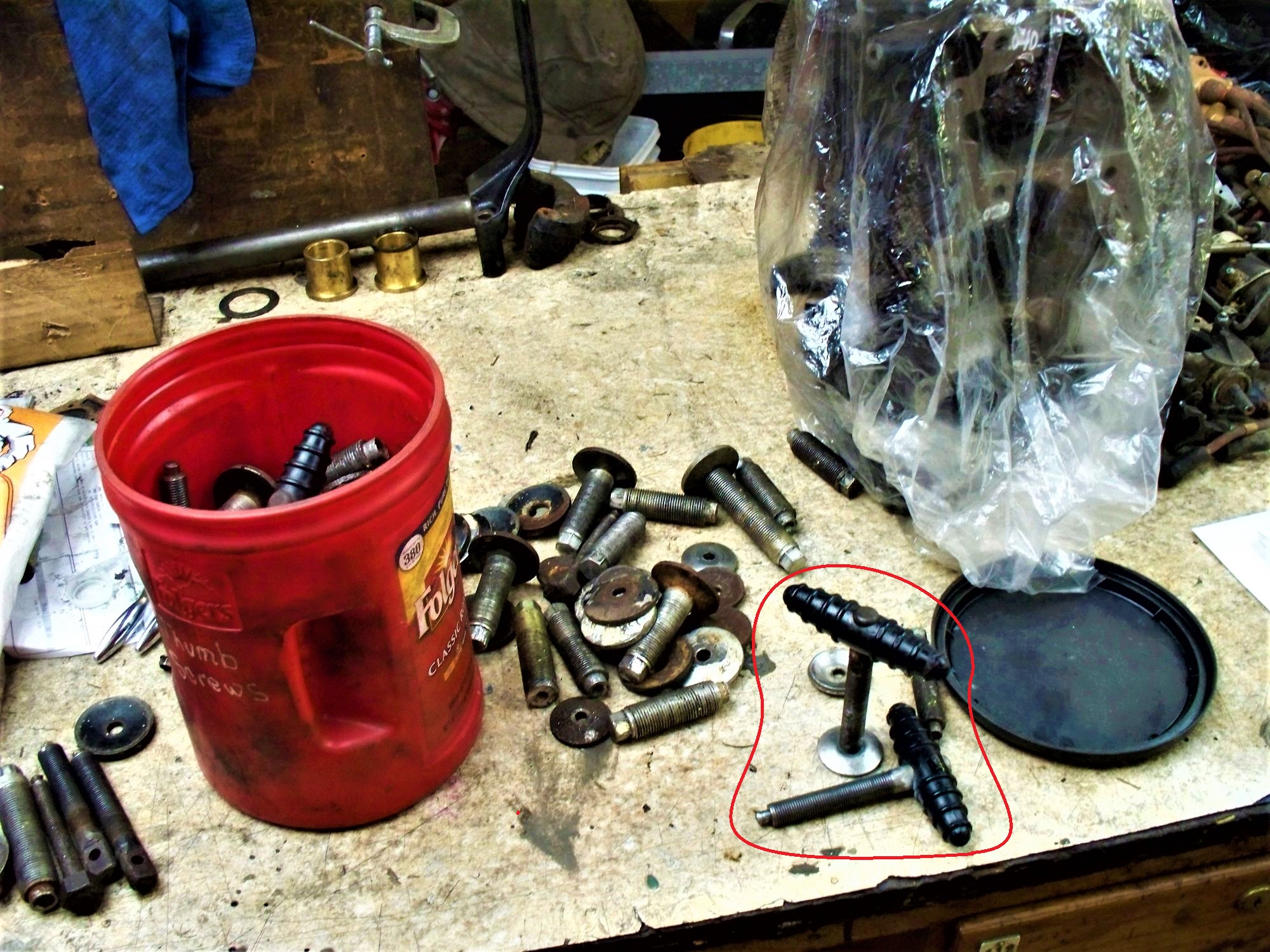

I have a few.
They are used, and are not flawless.
Little nicks & dings in the black grips.
$20 + shipping.
If you don't have the required tool to install one, I will loan it to you.
Don't try and remove the bent one until we talk.
PM if interested.

No special tool required to unscrew the 'screw', but once you have knocked off the washer with a punch & hammer, you might find that the end of the threads are mushroomed, and need to be filed off a bit to allow you to unthread it without damaging the female threads in the transom clamp.
doc
Transom screws for 1960 Merc 300 8 years 9 months ago #135442
I just use a wiz wheel and cut them off when replacing them. ball pien hammer will mushroom the end for the washer.
