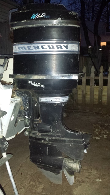

It doesn't seem to be for an 1100. What does the cowl wrap go to?

Unless it's a replacement decal on a different wrap, it's either for a 66 or 67 950 or 1100. Can't see the picture well enough. You can identify a 67 by the red pinstripes along the chrome band
What motor does this cowl wrap go to? 8 years 10 months ago #135112
make sure the top cowl is on right and adjust the 3 clips on the wrap. it fits all 6cyl 65 and up in line will into the 80's

Actually the top hat mounts via (2) clamping levers, (1) port and (1) starboard. So it'll only fit those motors with that style of attachment.
The motor is a good find, 1100 Short Shaft is pretty hard to come by. It should make a 15"-transom fiberglassic fly!
www.marineengine.com/parts/mercury-outboard-parts/1100/1870204-thru-2314955/top-cowl-and-support-brackets

Thanks for the info. Dr.Go! and I figured it's a 1967.
