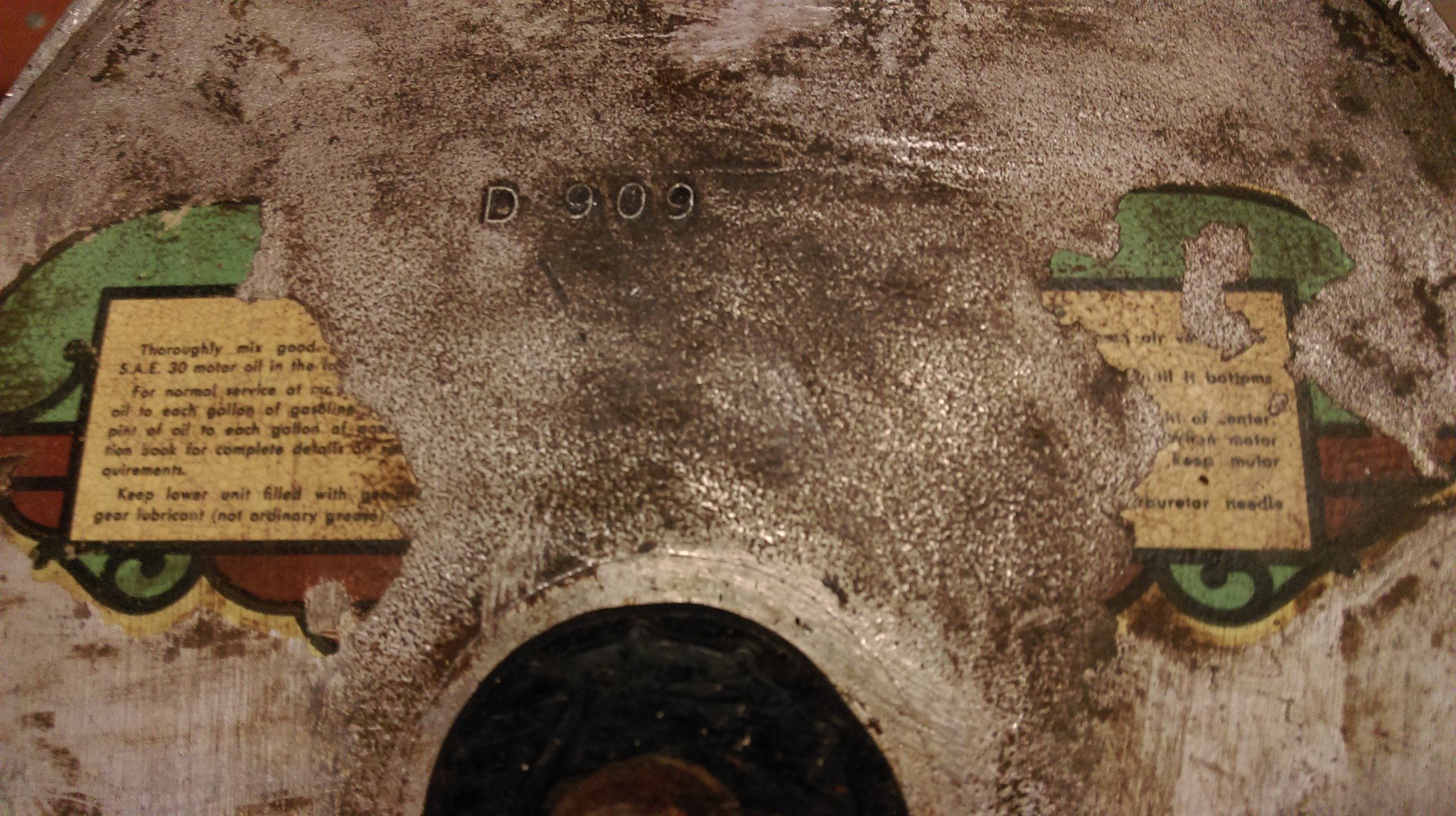

stickers are original. the stripe on the leg has nothing to do with the should be. tha cavitation plate should be about even with the bottom of the boat or lower. yes on the degreaser BUT keep away from the decals. the color if you repaint is DULL ALUMINUM. and a decal set. all easy to get.
1947 Mercury KD4 8 years 8 months ago #135070
thank you for chiming in Dave........I will measure where the cavitation plate will be on the boat I have for this motor
I see some parts on oldmerc.com but I don't see decals. The one on my motor are very old and crumbling, there are some remnants on the top of the gas tank also, so I will need a set .
Just pondering what to do to try to bring it to working condition......?

1947 Mercury KD4 8 years 8 months ago #135071
try JohnsMcintosh.comfor the decals
also Dixie Hammock does decals.
go to johnsoldmerc.com and ask.
1947 Mercury KD4 8 years 8 months ago #135075
remnants of an old decal......

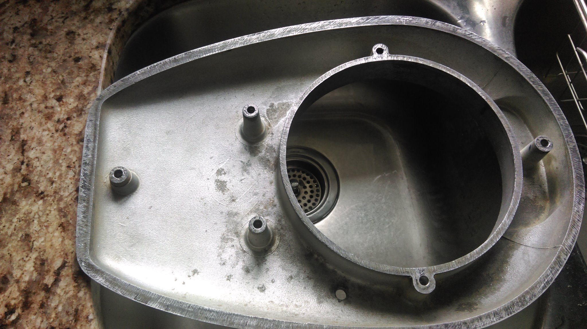

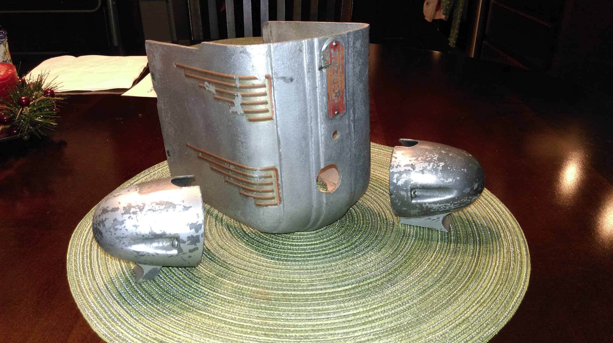

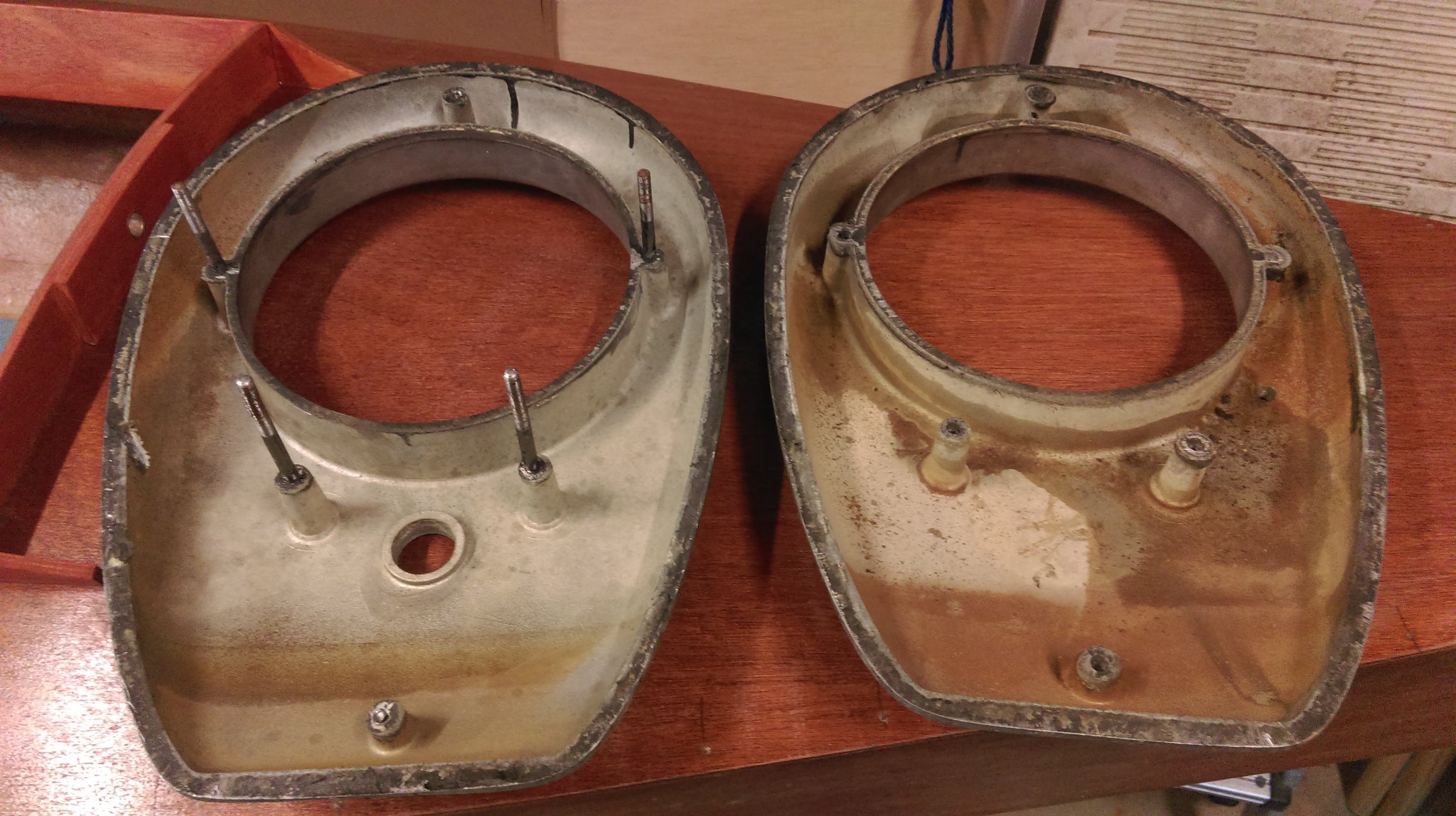

started cleaning the motor , learning about it as I was going. Scrapped first idea about spraying it with a degreaser and hosing it off. Yes, most likely would have been much faster, but since there is no manuals for it ( apparently there are 2 pages on KD4 in 1960 and older manual ) I like take it apart as I am cleaning it - gives me better understanding of how motor and motor it's components.
Here are few pieces that I washed with a dish soap on a steel wool pad, I think that' all I am going to do . So far not planning on painting it.
Next check for spark and cylinders pressure....
Cylinders are wet with oil - I think they were taken care of....

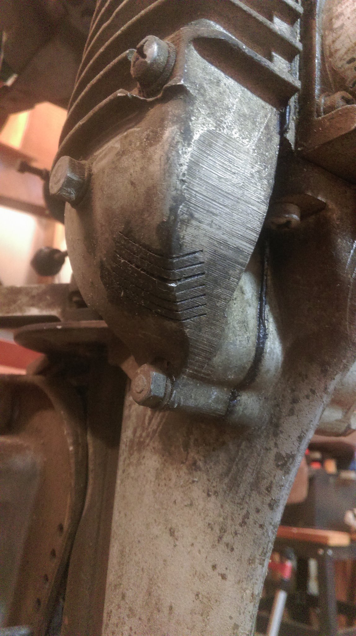

.......also the sliced exhaust manifold turned out to be a factory feature....so it's all good

Very cool, that's the exhaust relief for when the engine is not moving in the water. Once underway, there is less restriction since the exhaust is being scavenged out of the L/U by venturi action (the motion of the water passing the exhaust).
If the coils are not ravaged, you may get by with simply cleaning and regapping the points. Note the points will need to be removed and then the contacts cleaned, and finally polished with Crocus Cloth.
Have Fun!..........ed

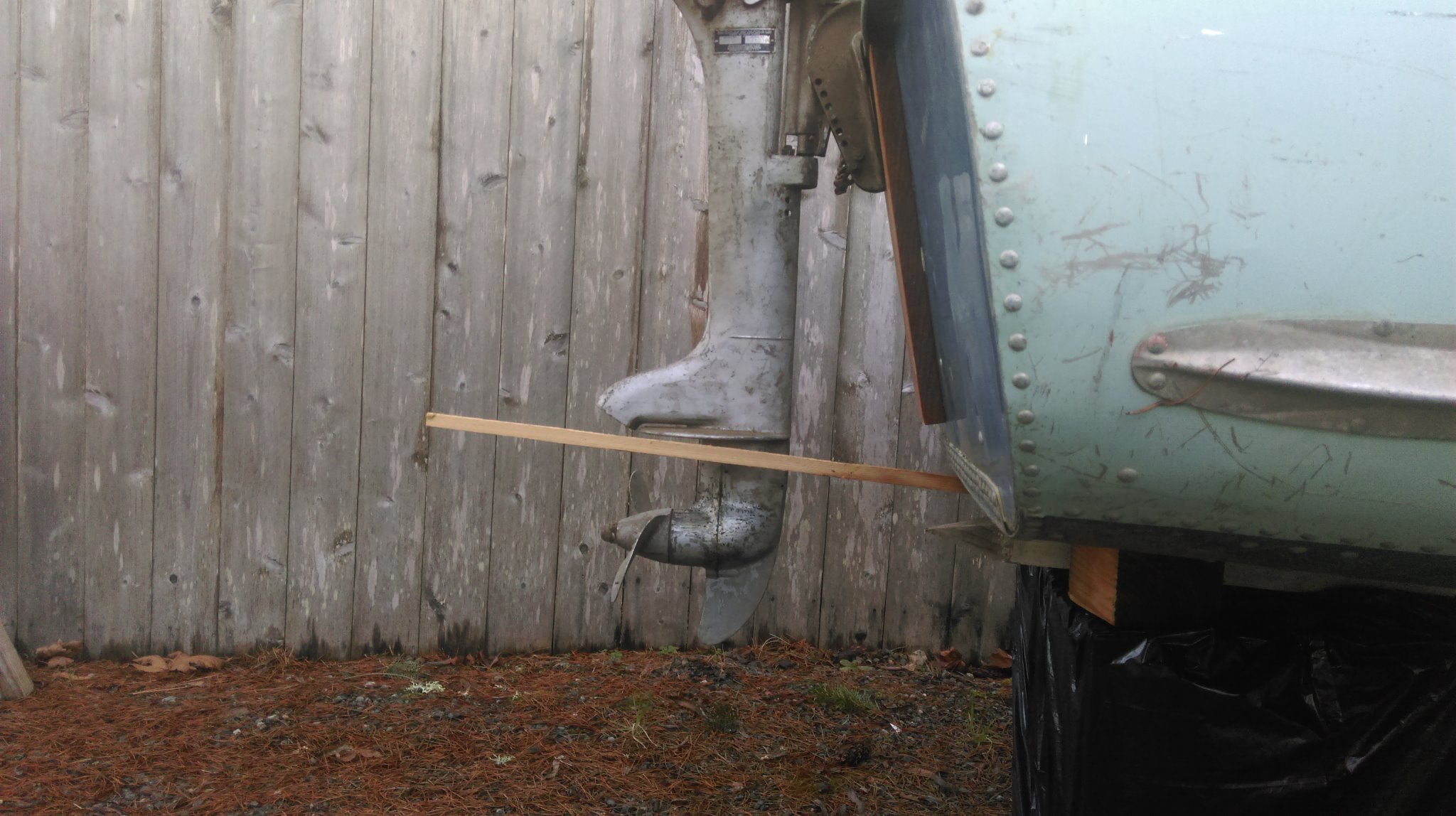

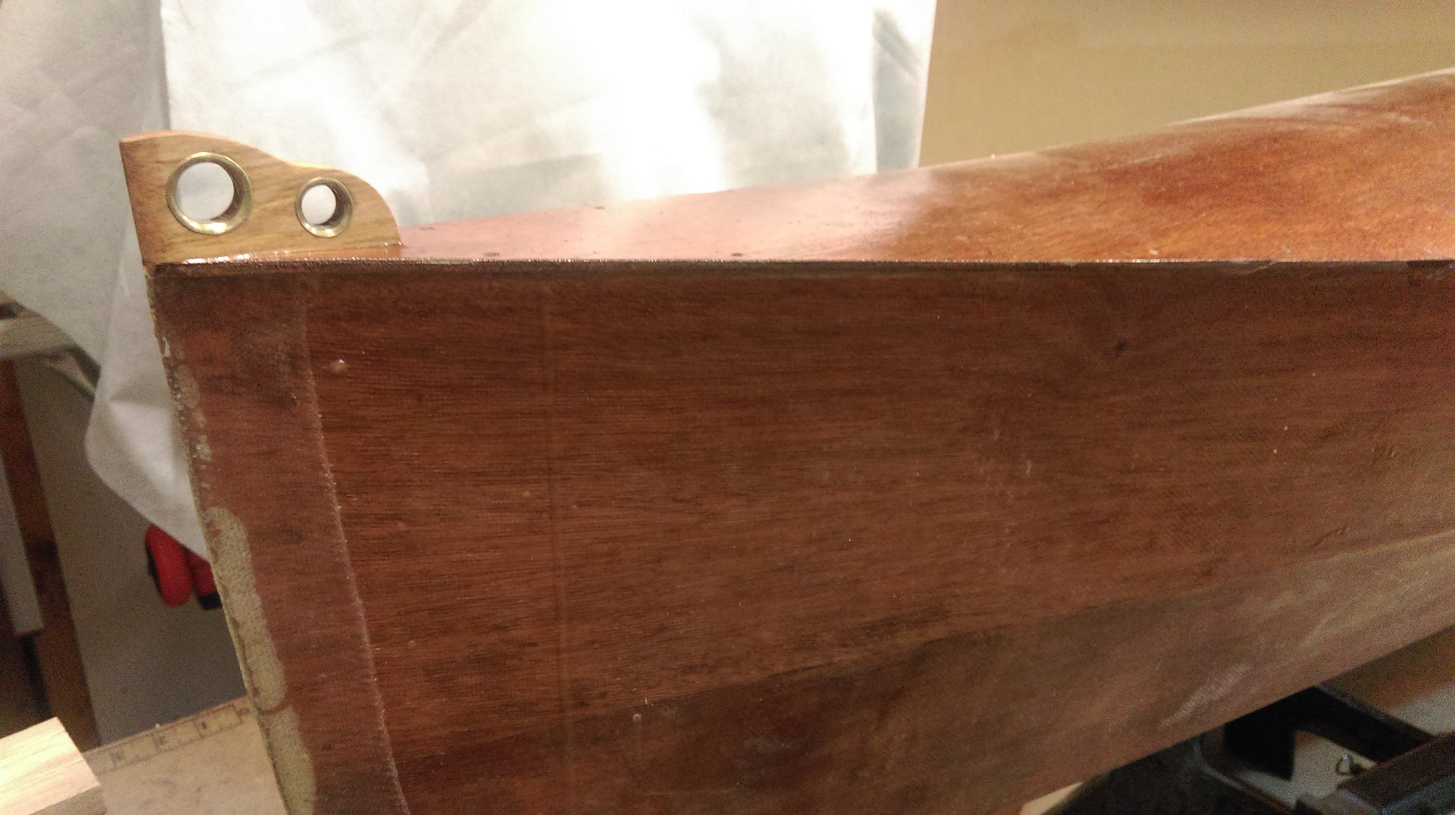

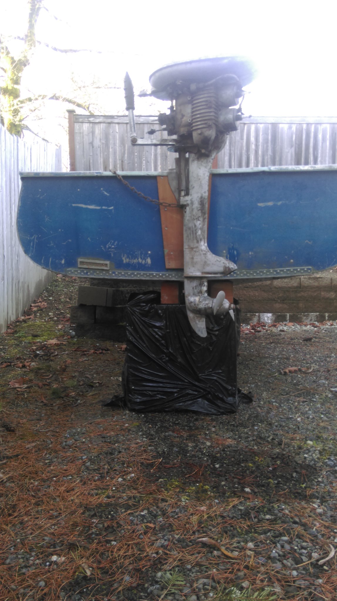

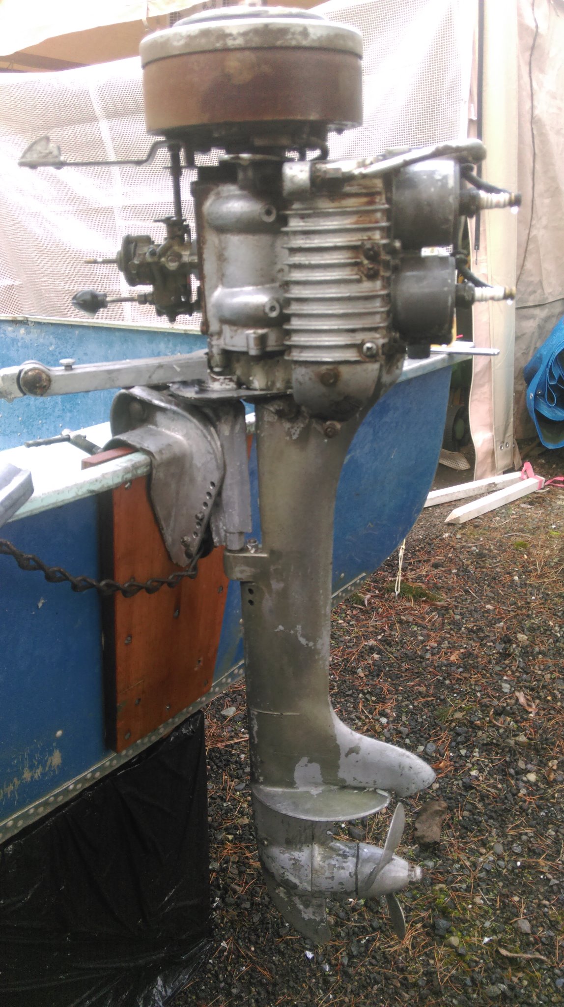

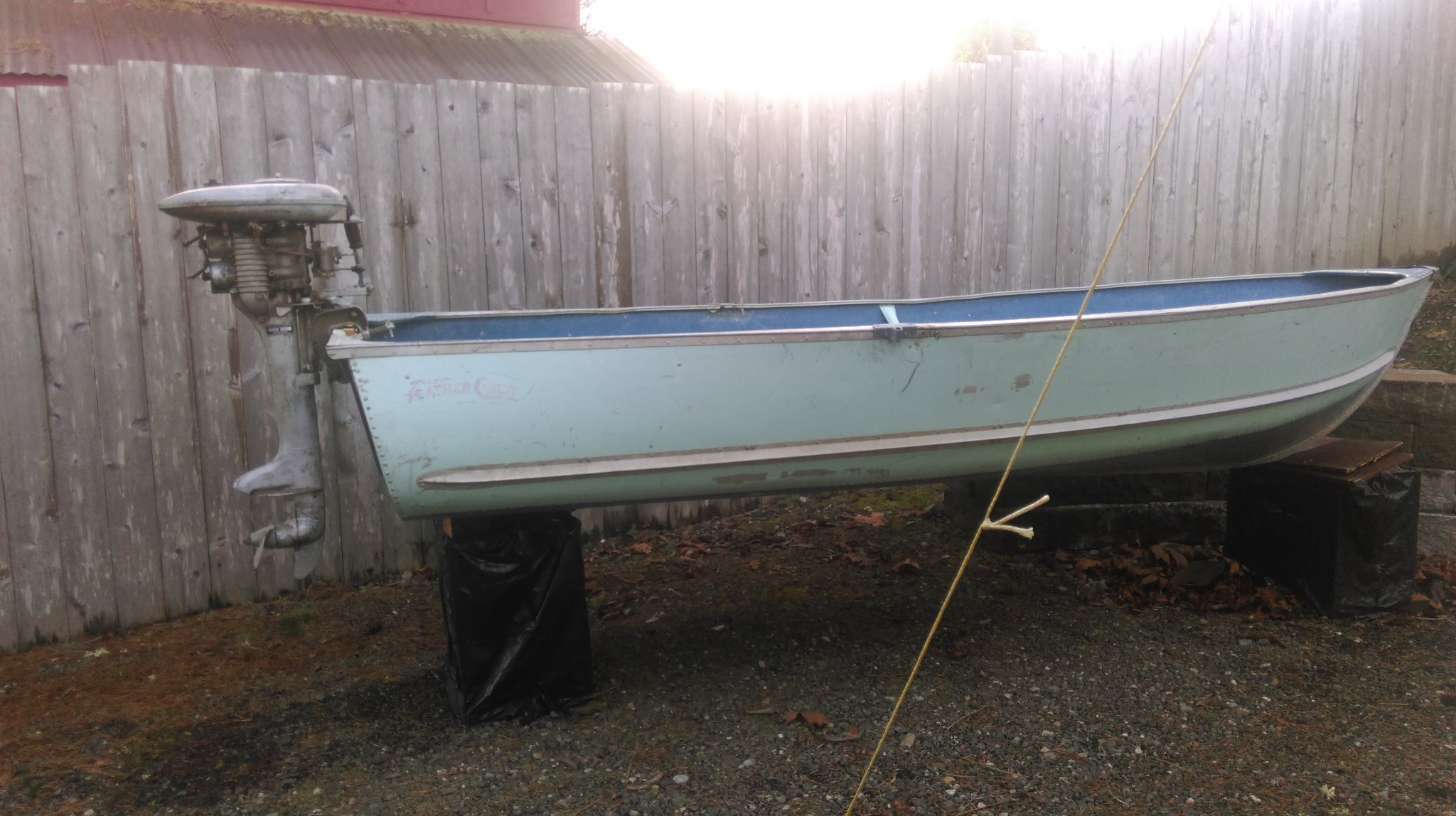

Mounted the motor on the boat - as I was wandering if the transom is not too long for it. Took some pictures and wander what you guys think.......real test will be with the boat in the water....
1947 Mercury KD4 8 years 8 months ago #135254
  • ed-mc
  • Posts: 1467
  • Karma: 235
  • Thank you received: 129
Wojo, the transom height is just fine. There is plenty of prop in clean water below the transom. I dunno if the 6hp would even plane your hull, but if it does, it would be OK. I can't tell from the pics but I'd expect there are a series of holes or something similar in the gearcase for water intake, since the pump is in the aft end of the gearcase.
Looks good on the boat, have a Happy New Year!

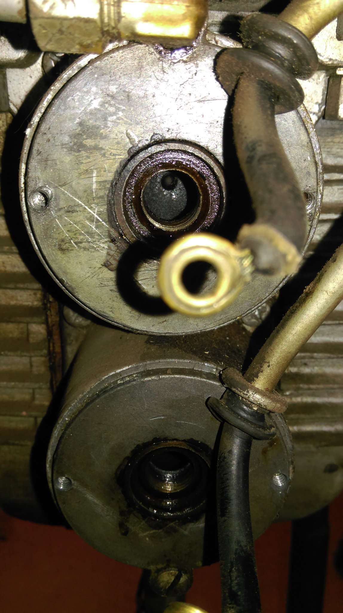

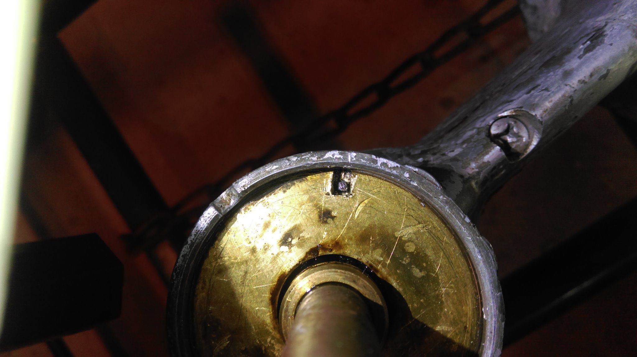

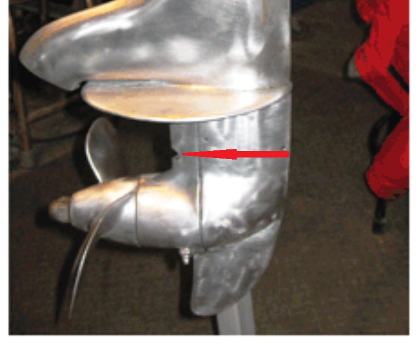

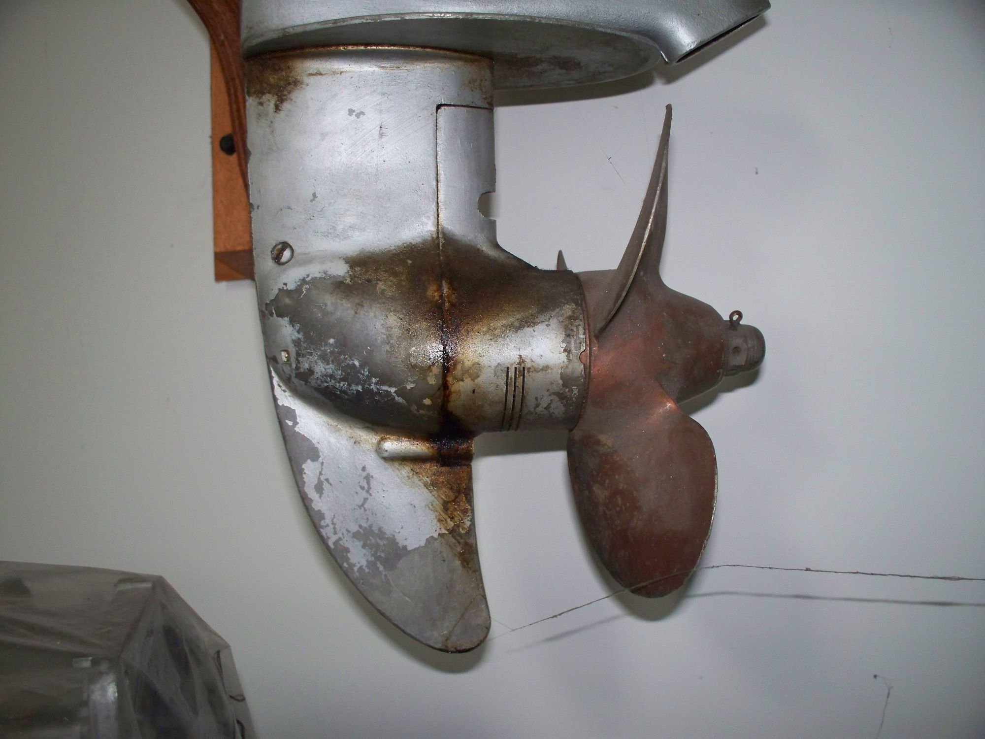

I found a better pic which shows a hole in the bearing carrier/pump housing. Looks like the sweep of the prop helps feed water to the inlet of the pump. See what you think about that.
1947 Mercury KD4 8 years 8 months ago #135256
been awhile but I think that hole is a Philips screw that holds the gear case together.
1947 Mercury KD4 8 years 8 months ago #135257
  • ed-mc
  • Posts: 1467
  • Karma: 235
dave bernard wrote: been awhile but I think that hole is a Philips screw that holds the gear case together.
Dave, that seems likely. Guess we need some better pics!

The Doc just sent me a Happy New Years picture, enjoy!
(slotted area is the water intake)
1947 Mercury KD4 8 years 8 months ago #135270
Dave you are right - it's a screw in there....at first I was thinking that it was a water intake also :)

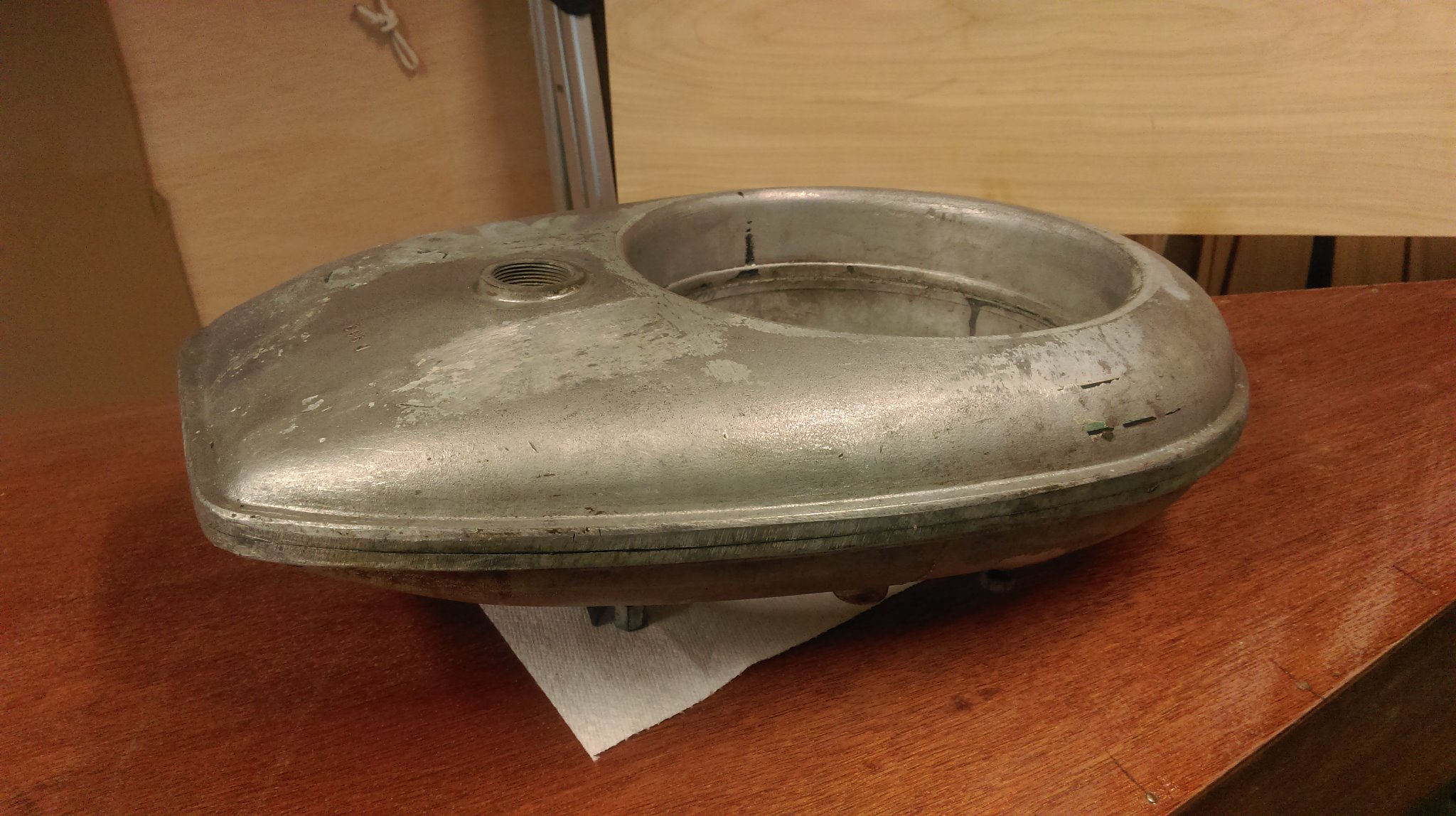

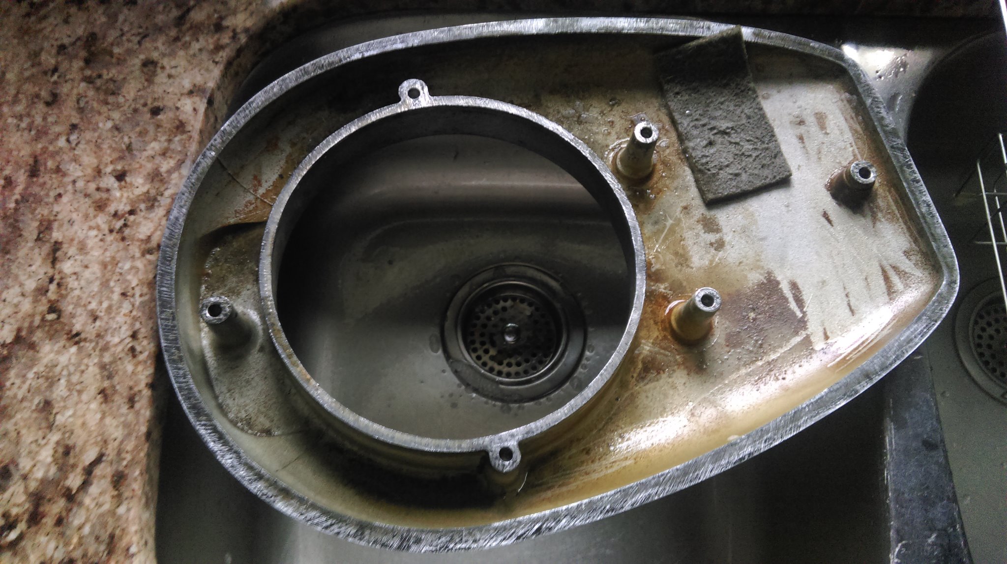

today I was cleaning the motor and at some point started spraying it with a carburetor cleaner..........not a good idea, the paint started coming off - sprayed with water and washed off with soap - hopefully cleaner didn't get where not supped to go.
Took off the gas tank and will be cleaning it inside with acetone tomorrow.

Any paint that comes off with carb cleaner is probably not original anyway. Your motor could be easily stripped of old non-OE paint, a bit of touch-up sanding and prime with Zinc Phosphate (Zinc Chromate is better but harder to get nowadays); then sprayed with "dull aluminum" paint which is the old-time finish and replicates raw cast aluminum.

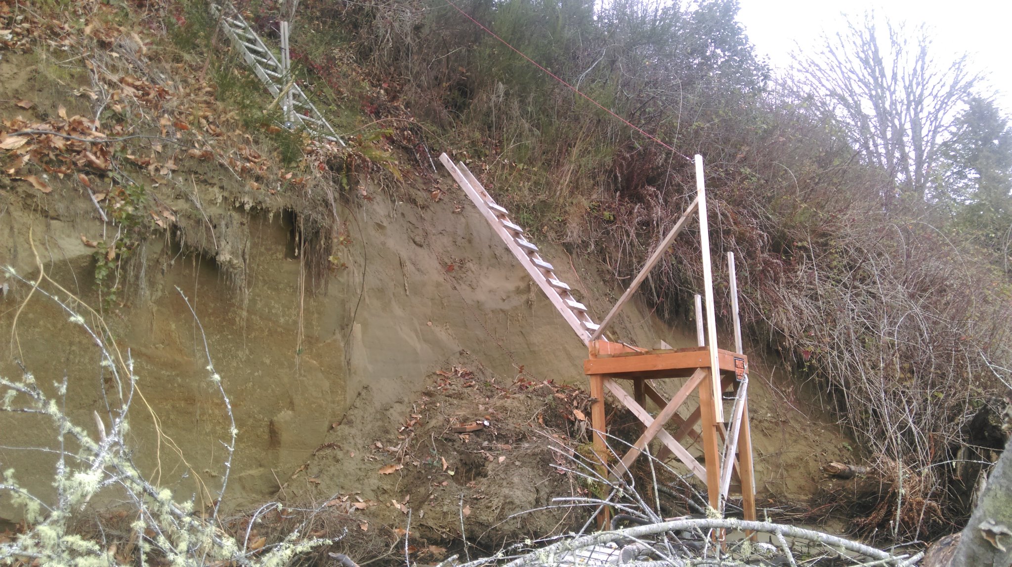

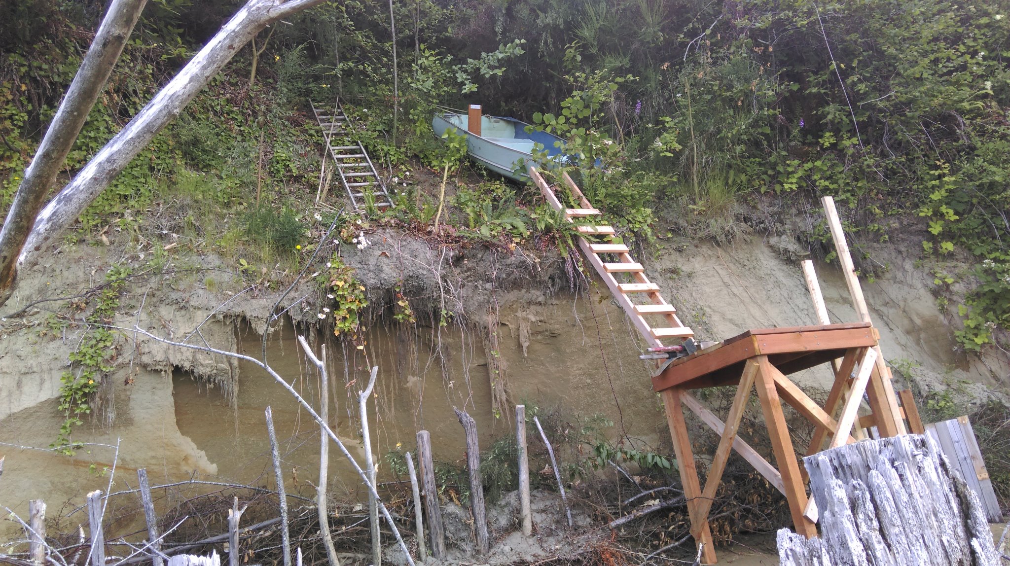

Went down to the beach yesterday to asses the winter storm damage to the cliff - looks very sad!
Have been working on bulkead permit for last 8-10 months - very expensive proposition.
The temporary platform was standing 2-3 feet from the land - in last week the distance grew to more like 8 feet......and we have still many months of rain to go.
This is summer of 2017 picture...
and here - today

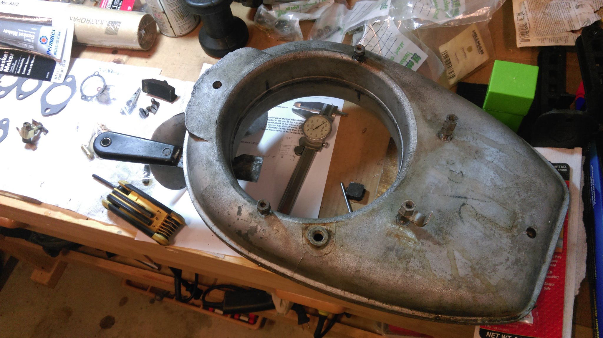

Sooooo.......took the fuel petcock out and there is no fuel filter on it - maybe petcock was replaced...?...don't know. Cleaned the petcock and is now operational.
Poured out the acetone that was sitting there for 3 days , and need to do some more cleaning because tank inside is still dirty. Noticed that the tank leaks - see the picture. This side of the tank was dirty - most likely from gas leaking out.

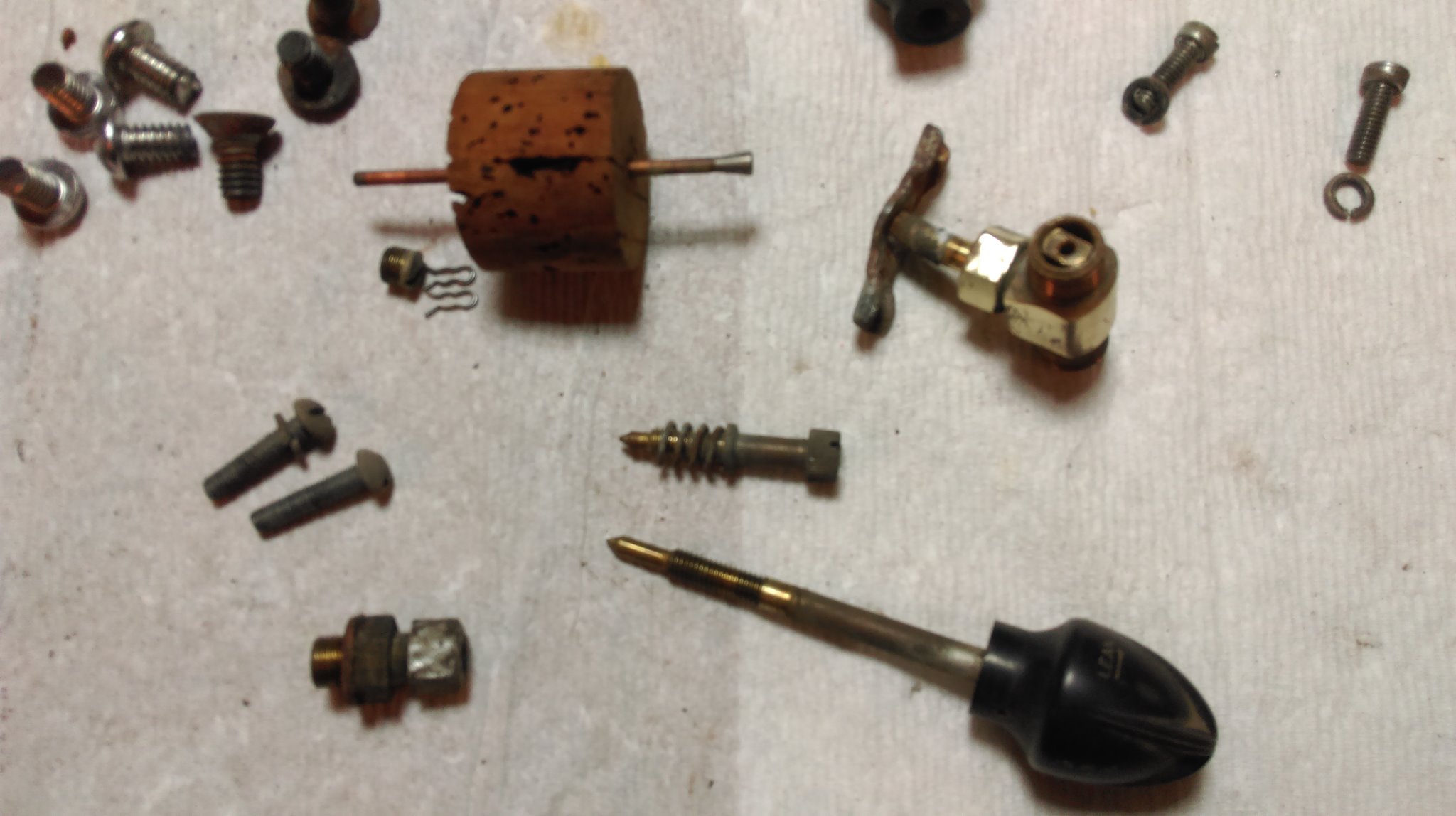

Took carburetor apart. The float in it is made out of cork and kept in place with two wire clips - there are grooves in the needle to keep them in place..... the cork looks good and I am wandering if I need to repace it with a new plastic float...?.....would that change the level of gas in carburator ...??
Washed the dirt off the carburator and tomorrow will set it in acetone for few days to clean small passages etc.

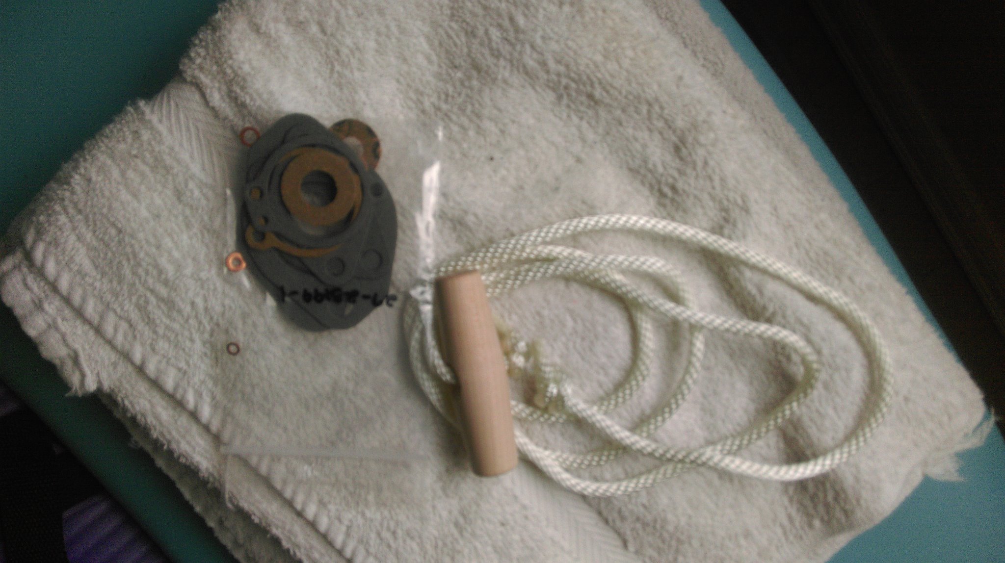

The gasket set for the carburator is most likelly a general set for many different carburetors that oldmercs is selling.
Well, so far so good.......discovered that both our phones don't do sharp closeup pictures anymore - had new batteries installed few days ago, and this is a result - trying to check settings ...no luck so far
1947 Mercury KD4 8 years 7 months ago #135378
Carburetor is more or less clean, turned out that I am going use only 2 gaskets from the kit........

On the carb, recommend coating the cork float with model airplane fuel-proof dope. This will make the float somewhat ethanol-resistant.
On the tank, if you have a rad shop clean and repair it, be sure they don't hot-tank it. I'm assuming that tank is aluminum and the caustics in the hot-tank solution will eat away the aluminum.
Interesting tank, it's got quite a seam. Is it 2-part? Don't know how these were built.

1947 Mercury KD4 8 years 7 months ago #135393
Yes they are aluminum and 2 piece. they can be taken apart and cleaned they have a gasket in them just screws to take apart.

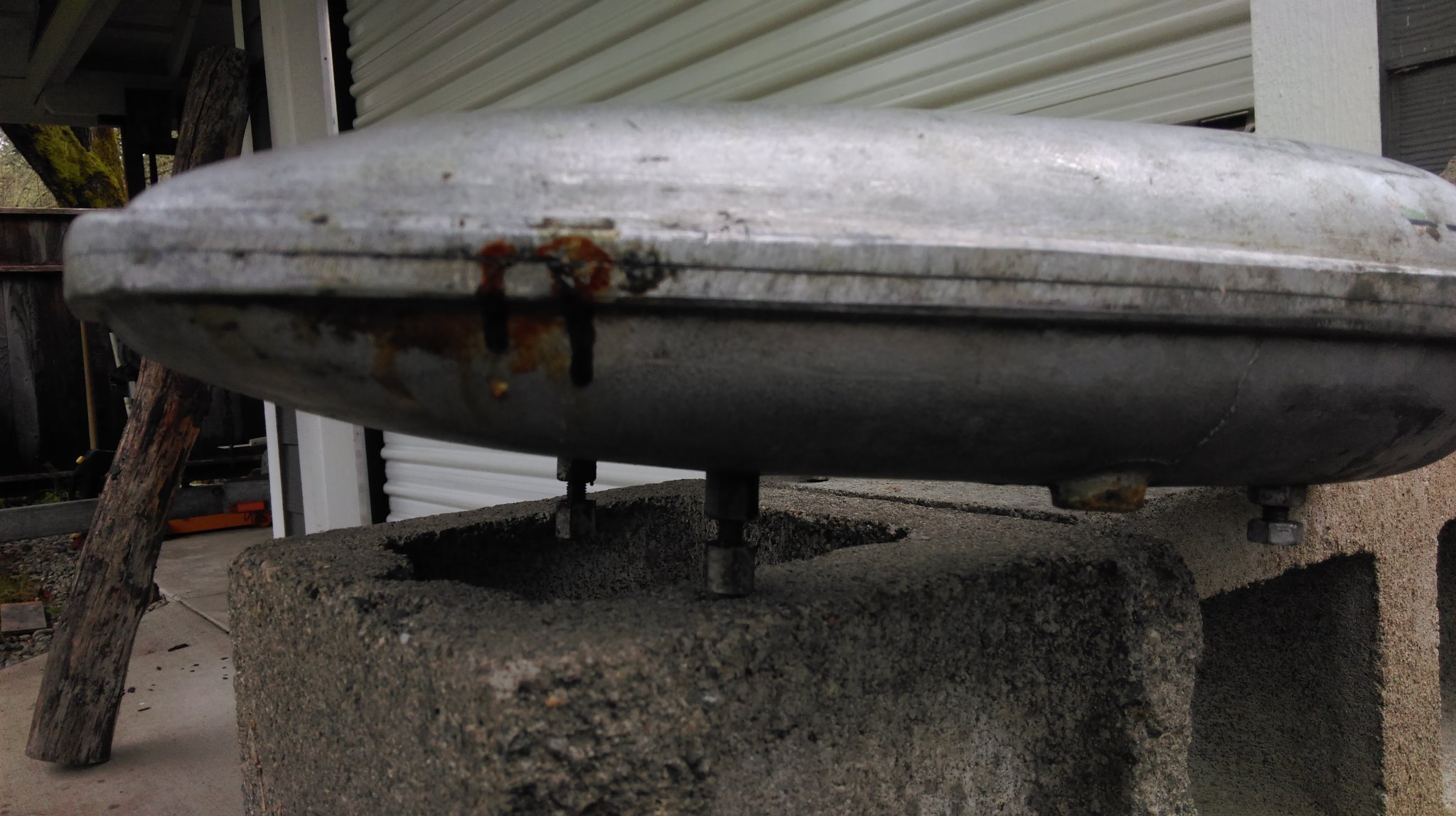

went to O'raileys before work yesterday and got the gaskets. Taking the tank apart today.....we shall see how it goes.

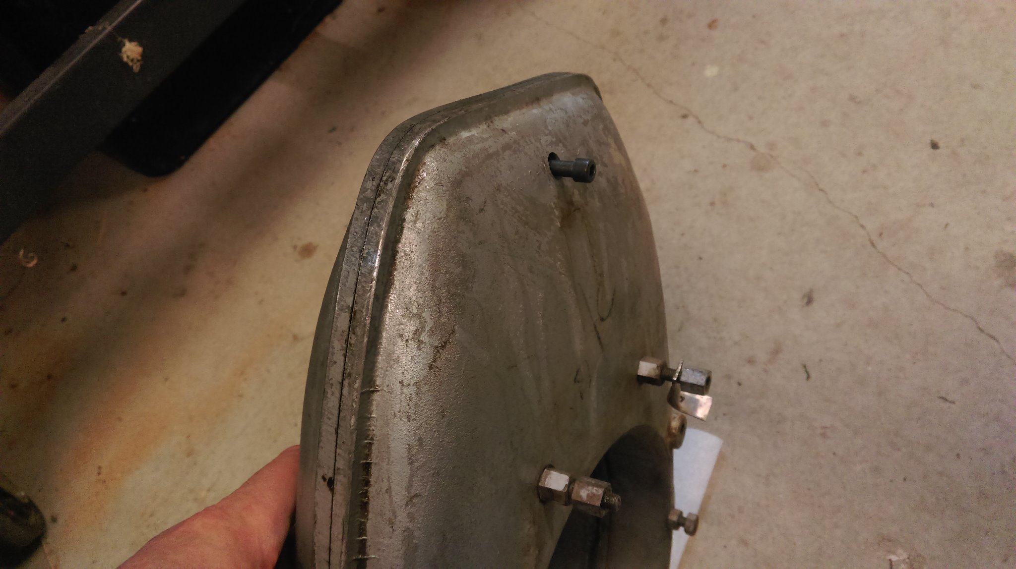

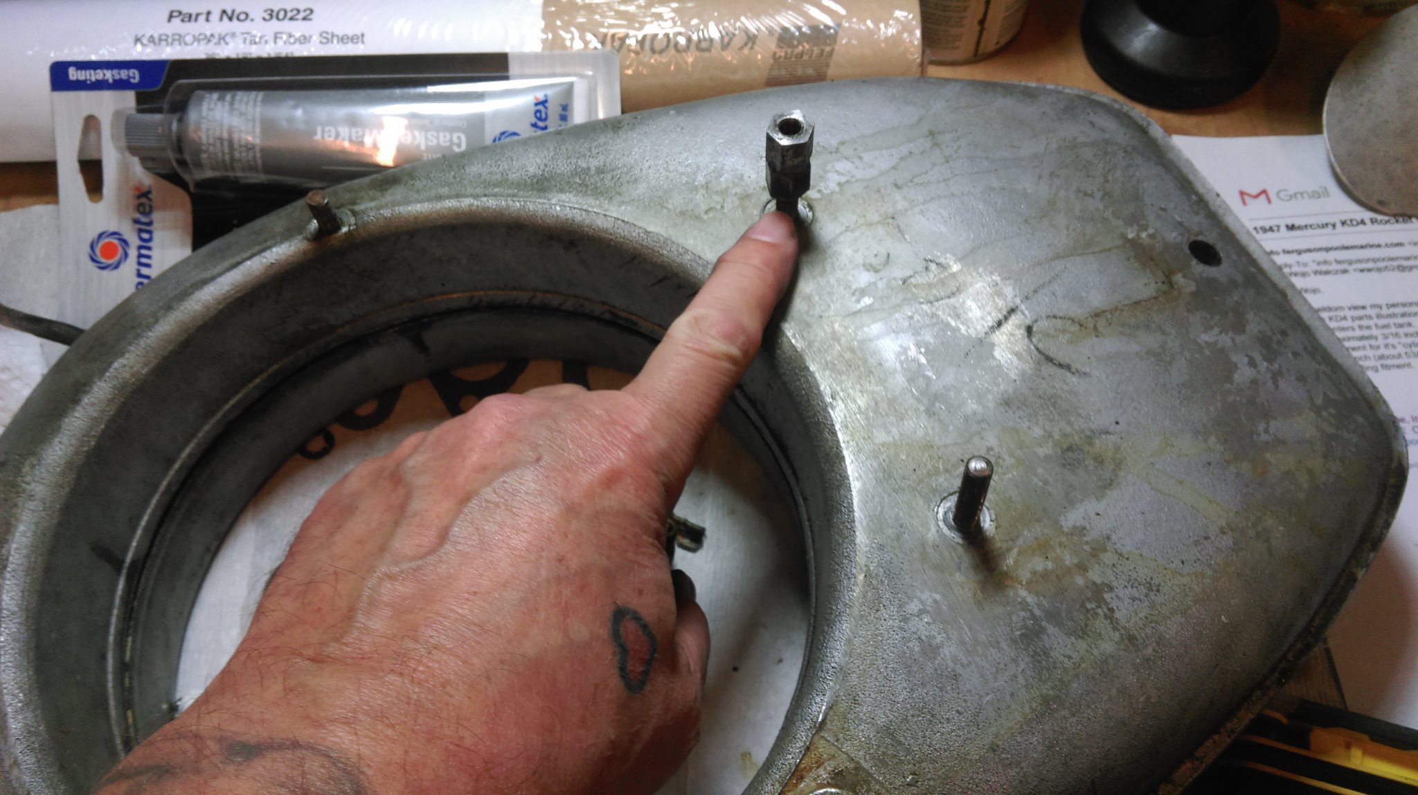

trying to pull the tank apart - it's not parting so far......inserted longer bolt and tapping gently on it and all around the seams - any tricks of the trade to offer Dave ???

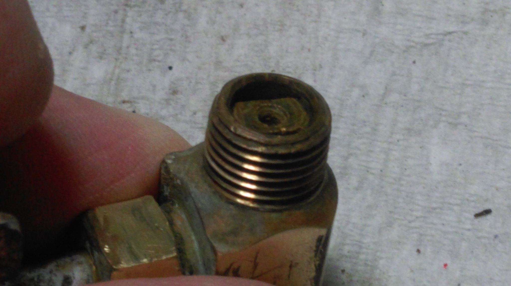

the fuel filter has 2-56 tread ( thank you for that info Joe ) - need to buy a 2-56 tap and tap the hole in the fuel petcock to install the filer - seems that there is no thread in this hole - although the diameter is right for the tread size.

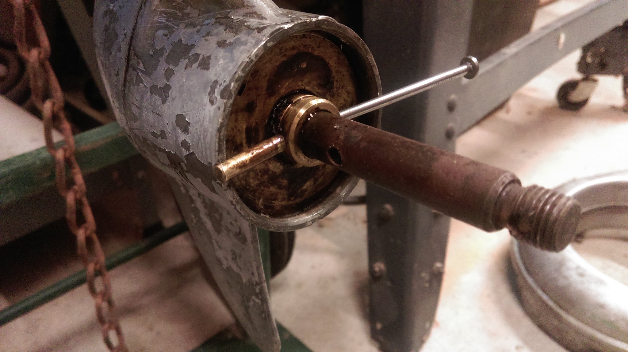

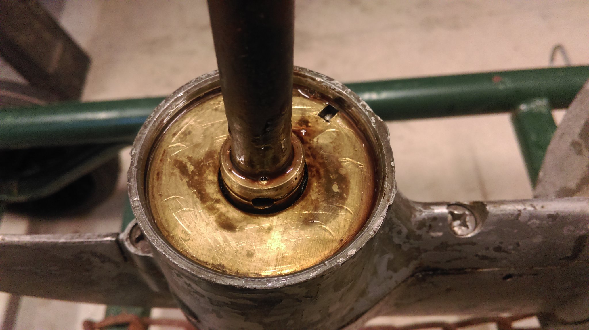

Since there was nothing else I could do today, I have started look into the water pump impeller - this is how far I have got in this project - here removing the pin - but the plate is not coming off !!??

Soaking the impeller plate in rust loosening solution.......
Petcock turned out to have treads already but I need to get a tap and clean the treads - I hope I didn't ruin thread on the filter already.......
1947 Mercury KD4 8 years 7 months ago #135483
put the propshaft in a vise and pull it out with gear and shims as an assembly DON'T lose the shims.

1947 Mercury KD4 8 years 7 months ago #135488
in desperation I have e-mailed Dave about the tank.....he suggested to use a thin bladed scraper. Started working the scraper in between tank halves......
it was going in in some spots and in some not........then had a EURECA moment.....what if the 4 bolts are not just only to mount the tank to the motor, but also to tighten the halves together...???!!!
.....just love to make simple tasks very difficult ...:whistle:
Thank you Dave!
I will try the impeller assembly removal in few days.
1947 Mercury KD4 8 years 7 months ago #135489
I see the leak is lack of gasket you can make them . make 2 1 inner and 1 outer then glue them in place before assembly. use good sealer gas proof when you put it together. make them larger then trim after it is together and dried.
The following user(s) said Thank You: 2dogsnight
1947 Mercury KD4 8 years 7 months ago #135500
OK, more progress:
Dirty tank......using fine metal wool pad with dish detergent - will have a gas with detergent :)
Clean tank...
water impeller plate movement in housing, but the pin is limiting it's movement.......and I think that's what it supposed to do - not sure how to remove it if that's the way to go.......
1947 Mercury KD4 8 years 7 months ago #135501
cover and the hub pull out . no turning. pull prop shaft and guts out as an assembly.
