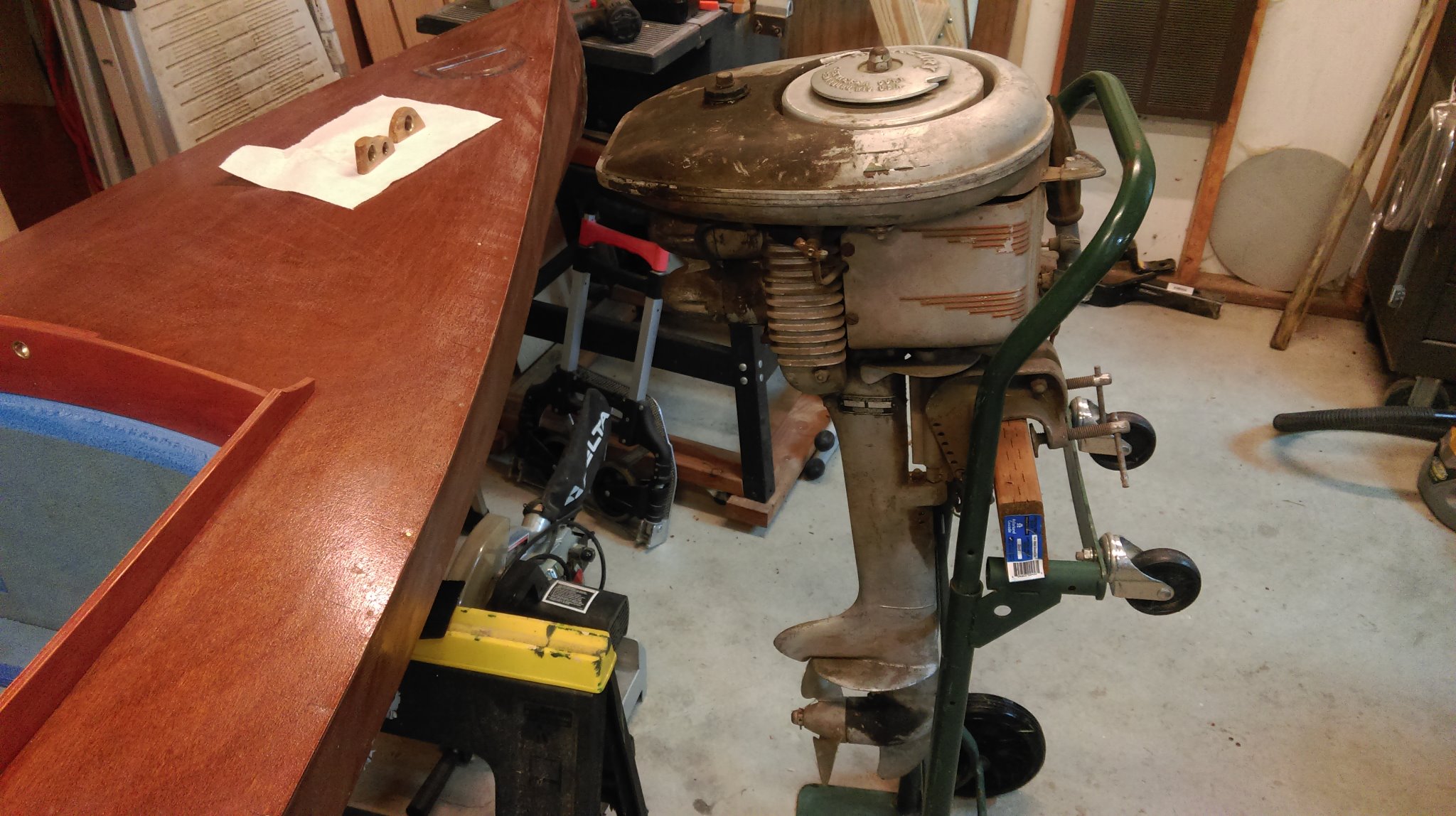

Got the motor yesterday from Idaho area - I am assuming that spend his life on Coeur d'Alene lake. Cylinders are not frozen!! Motor is complete! few observations so far:
- the weight without gas is 50 lbs
- red stripes are stickers (!!) I was expecting to be paint

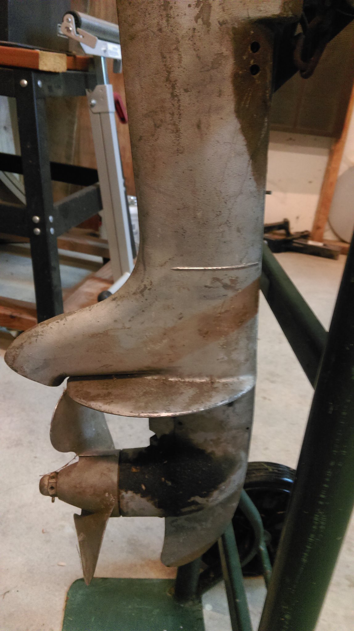

- can I use degreaser to spray and wash the dirt/oil stains away ?
- is the line an indications where the motor should be submerged to ?
1947 Mercury KD4 8 years 8 months ago #135066
stickers are original. the stripe on the leg has nothing to do with the should be. tha cavitation plate should be about even with the bottom of the boat or lower. yes on the degreaser BUT keep away from the decals. the color if you repaint is DULL ALUMINUM. and a decal set. all easy to get.
1947 Mercury KD4 8 years 8 months ago #135070
thank you for chiming in Dave........I will measure where the cavitation plate will be on the boat I have for this motor

Mounted the motor on the boat - as I was wandering if the transom is not too long for it. Took some pictures and wander what you guys think.......real test will be with the boat in the water....

Wojo, the transom height is just fine. There is plenty of prop in clean water below the transom. I dunno if the 6hp would even plane your hull, but if it does, it would be OK. I can't tell from the pics but I'd expect there are a series of holes or something similar in the gearcase for water intake, since the pump is in the aft end of the gearcase.
Looks good on the boat, have a Happy New Year!
