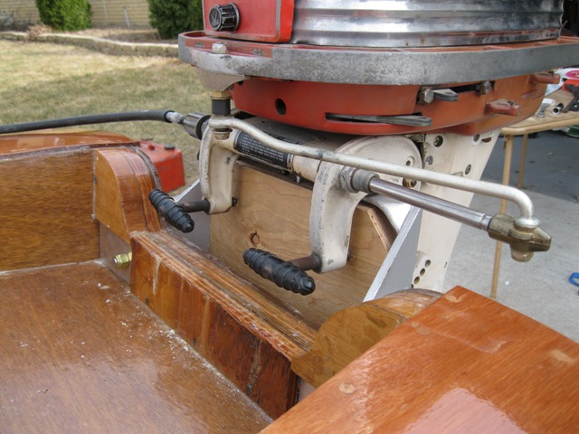

STEERING FOR VINTAGE MERCURY 9 years 2 days ago #134785
Not available new, but you can make an adapter with a spare larger tube and a couple of brackets, works well. I will post a picture of my setup for you to get an idea.

STEERING FOR VINTAGE MERCURY 9 years 2 days ago #134791

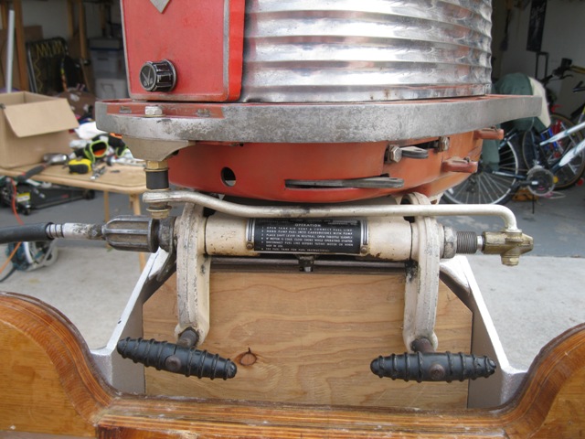

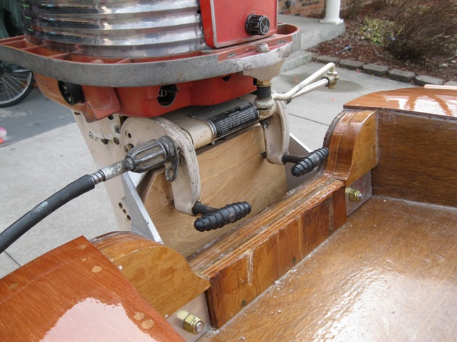

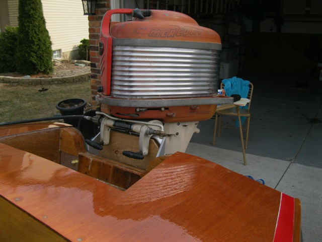

It is cleaner if you attach to the engine rather than the transom, I will show you how I did it shortly as soon as i can get the pictures off my camera.
STEERING FOR VINTAGE MERCURY 9 years 2 days ago #134792

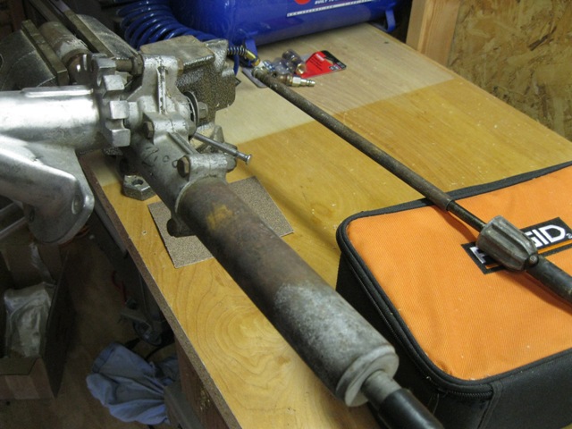

Hugh,
I'll get some pics together soon. What your looking for is a Ride Guide system. I currently run one on my Glen-L Zip with a Mark 58. I have a few but need to get lengths. Will get back with you soon.
Travis
www.liquidassetsonline.org , 63\'PowerCat14-C w/twin64\'650\'s,14\'Glen-L Zip w/Mark58E,58\'TeeNee,
Mark55AE,Mark55E,PairMark58E\\\'s,Mark58AE,Mark78AEL, 6-7RBM\'s.Keep EM\' Alive! Always looking to add to collection.
STEERING FOR VINTAGE MERCURY 9 years 2 days ago #134793
Pretty easy to set up on the engine and it looks almost factory when done right. Beauty is you can run with brand new cable and helm and not have to worry about stiff and rusted used stuff.

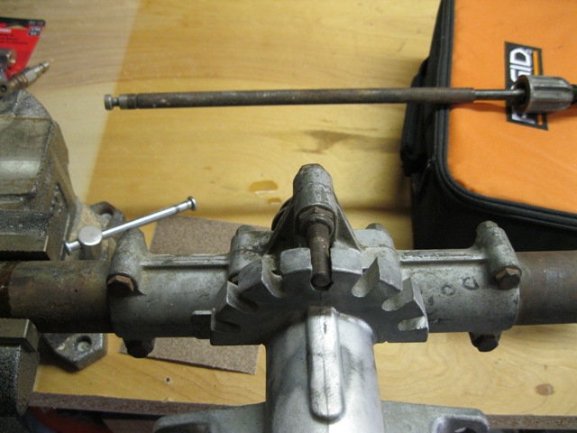

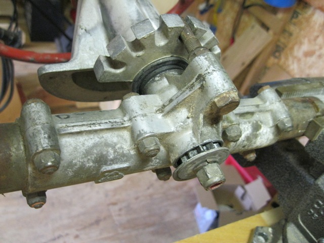

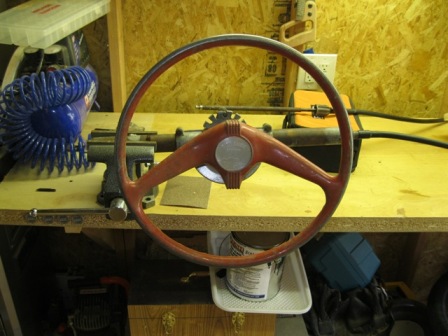

STEERING FOR VINTAGE MERCURY 9 years 10 hours ago #134819
Huge,
All pics are for OEM quicksilver Ride Guide system. Any questions just ask. Motor in pic is a Mark 55

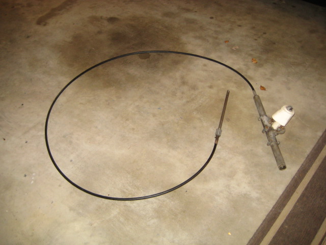

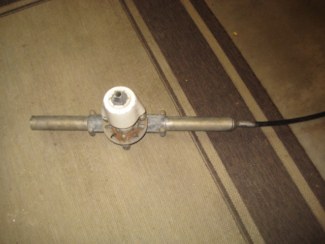

I have the complete steering setup ,I got for my 1963 65 HP Merc with quicksilver steering wheel I'd have to measure the length ,its been in my garage with the engine for about 6 years !!
STEERING FOR VINTAGE MERCURY 8 years 10 months ago #135079
  • Hugh Long
  • Hugh Long's Avatar Topic Author
  • Posts: 261
  • Karma: 8
I will need a very short one, about 11 - 12 feet. If you think you have something close, let me know. I am in no hurry at this point, but if I find the right thing, I will pick it up.
Thanks Hugh
STEERING FOR VINTAGE MERCURY 8 years 10 months ago #135080
  • 65G3
  • 65G3's Avatar
  • Posts: 190
  • Karma: 6
Ill measure tomorrow
STEERING FOR VINTAGE MERCURY 8 years 10 months ago #135085
  • 65G3
  • 65G3's Avatar
  • Posts: 190
  • Karma: 6
The cable is 11 ft long from the end of the steering box to the end where the nut is , and 1 foot sticking out at the motor end ,where it goes in and out
