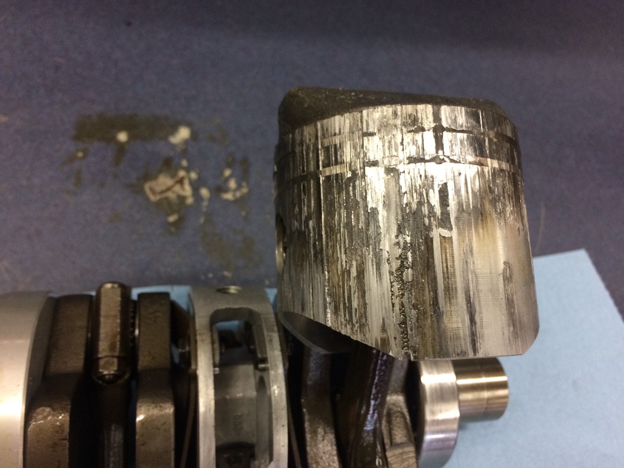

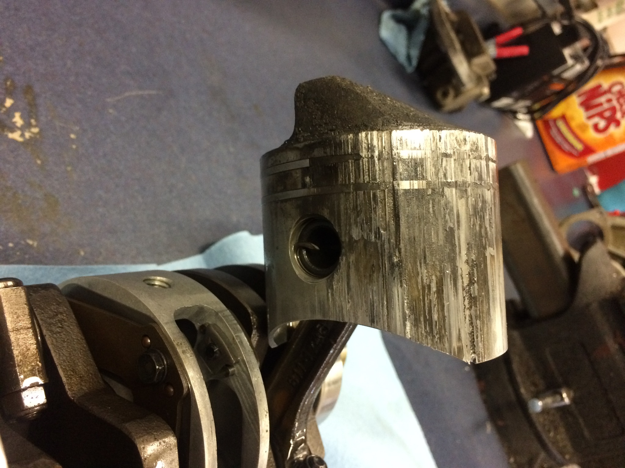

I learned the hard way that even buying a running motor (that seemed to run ok), I should have performed a compression check. Then maybe I could have paid a bit less up front for the whole boat, motor and trailer to help pay to fix the bad cylinder I later discovered. I will always bring a compression checker when considering a motor purchase.

I'm following in those sad footsteps with my 61 40HP oldNrude. I've got it running decently but with between 60 and 65 lbs compression I think I'm getting about half of that. That's why I'm hoping that Mariner 45HP isn't farther gone than what I've got already. It's got heart but it's lacking nutz. Whatever happened to THAT piston hurt !! I'll try to avoid that at least ! Thanks !

Bad thing was big unexpected expense (since I don't have talent to fix myself)... good thing is that a qualified mechanic rebuilt it which means I have an almost new old motor. Hopefully I can take good care of it so it will serve me and any future owners.

That engine got hot... real hot. Scoring on the exhaust side is usually overheating or water ingestion thru the exhaust ports, possibly a bad exhaust divider plate. Be surprised if the block is still usable after that.
