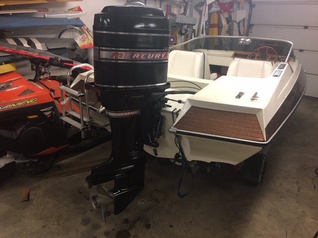

Hello, I am looking for advice on prop selection and power. I have a 1977 Glastron Gt150 the use to have a Chrysler 105hp on it. That motor finally went to outboard heaven and I replaced it with a 1969 Mercury 1250 125Hp. The Mercury is suppose to run between 4800-5300 at WOT. When I put the motor on the boat I transferred the tach that came with it . It had a 17p prop and was revving over well 6000 rpm at 38 mph. I bought a new 19 and 21P prop. Here is where it gets weird. The 19p goes 42mph at 6100 Rpm and the 21p goes 40mph at 6000rpm , slower than the 19p?. My old Chrysler 105 would touch 50mph at 5800 rpm with a 21p and 45mph with a 19p at 6000 rpm. I have fooled with motor angle and motor depth. The Merc sounds great but doesn't have the same or better speed with the same props??? Prop diameter is about the same, the lower leg on the Mercury is visually smaller. I confirmed the tach RPM using a model airplane tach and making a felt pen line in the flywheel, the tach is reading about 200rpm fast. Any thoughts??Im confused..Brad

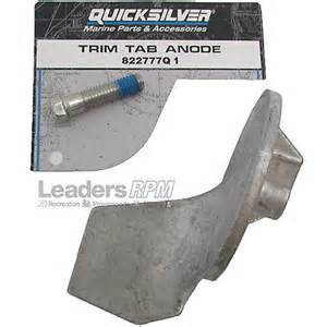

That prop already has a lot of rake! I learned the hard way, too, when I bought that stainless Stiletto prop and much to my surprise the prop hit the stock trim tab. Called the school of hard knocks!
The Mercury trim tab is a nice piece if you want to do an upgrade from your modified trim tab.

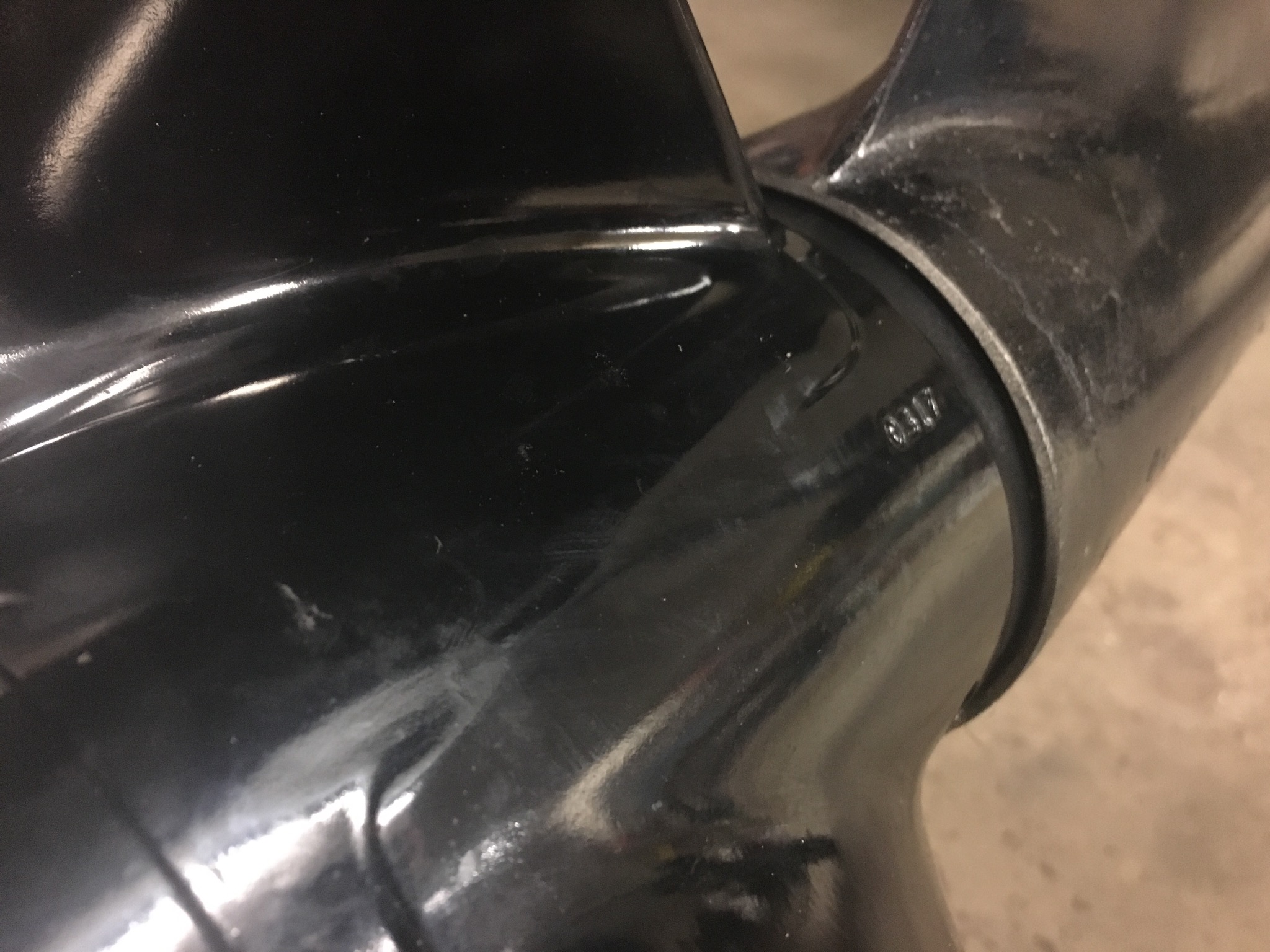

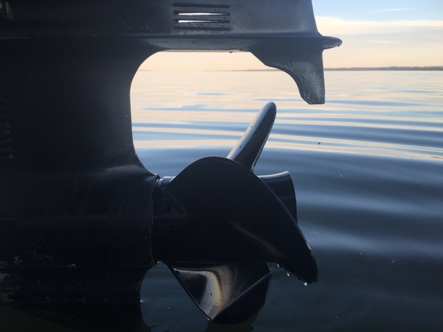

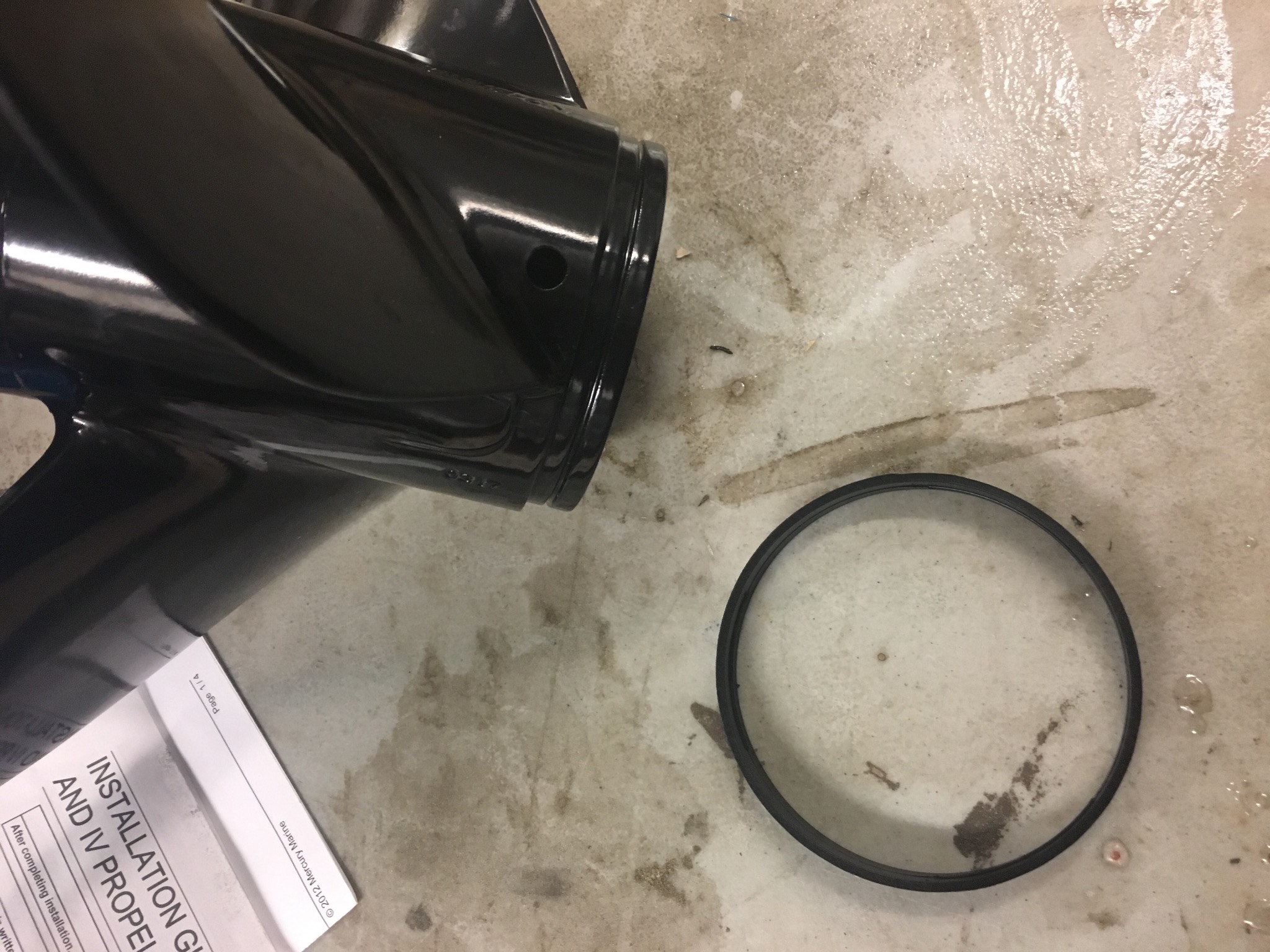

I'm looking at the zoomed-in pic of the prop, and it looks like there's quite a bit of gap between the L/U housing and the prop itself. There are 2 steps at the fwd end of the prop, the 1st is quite visible then the one fwd of that has a slightly smaller i.d.
Does the smaller i.d. extend any distance into the L/U housing? If the wrong combination of thrust hubs is used, the prop can stick too far out and then excessive exhaust gasses flow over the hub, causing uncontrolled ventilation.
I would imagine that the new prop has an integral huib at the front. Your propshaft should have a beveled edge where the thrust washer rides, and the thrust washer should be the thin, flat one, P/N 13191A 1.
Note that the older style props didn't have integral hubs and used a longer thrust hub at the fwd end. If this old-style hub were to be used with the new-style prop, the prop would stick out more and this could cause ventilation problems. Another reason for high rpm and low speed, lots of slippage!
Just a thought; if there's minimal clearance between the o.d. of the fwd machined portion of the prop body and the labyrinth seal at the rear i.d. of the gearcase, you shouldn't get much if any exhaust going past there.

Wow, another good point. The prop I used comes with a hub kit for that motor ...And... a nylon ring that can be snapped on to the back of the prop to take up excess clearance. My motor was not listed as one that needs the nylon ring but worth looking at.. lots of things to check now and allot more understanding from my end. Thanks!!! Brad

Meteor wrote: Wow, another good point. The prop I used comes with a hub kit for that motor ...And... a nylon ring that can be snapped on to the back of the prop to take up excess clearance. My motor was not listed as one that needs the nylon ring but worth looking at.. lots of things to check now and allot more understanding from my end. Thanks!!! Brad
Yeah, that might be what it needs. Just as an example, years ago Merc, OMC and others put out bulletins regarding drilling "ventilation holes" in the prop body, in order to let the prop spin up when you're taking off. Exhaust gasses flow out over the blades and cause a "controlled" ventilation or cavitation as it were.
These holes were typically 3/16" to 5/16" although some prop mfr's have slots or holes on their high-performance props that are even bigger. Usually used on a Hot Rod boat with a very large-pitched prop, gives plenty of slippage for the hole shot. So if even a small set of holes can cause a useful ventilation, you can imagine what exhaust gasses pouring uncontrolled from out the gearcase and around the prop blades would do!
Back in the Day we were running different motors and I drilled a prop for my brother's old Merc 1000. Put 3/8" holes in it. It had a great hole shot, but instead of gaining speed and having the exhaust sucked out the back instead of still pouring out the holes, it just kept coming out the ventilation holes. It slipped like a bad clutch in a car, or the rubber hub of a Big Twin Jonhrude. It wasn't the greatest prop, so no big loss. But we sure found out how it worked (or didn't)!
I had a $25.00 Merc 700E Dockbuster and we threw that on my brother's 13.5' Sea-King runabout. I drilled some ventilation holes in the prop and it was pulling slalom skiers out of the water, no sweat. My good buddy did a step-start one time, I had gassed it really good to show off to some guys that were laughing at our old boat & motor. It took off so fast he said his head was swimming! Those were the days, cheap motors and cheaper gas. Not so much nowadaze!
I think we're that much closer to figuring out what the deal is........ed

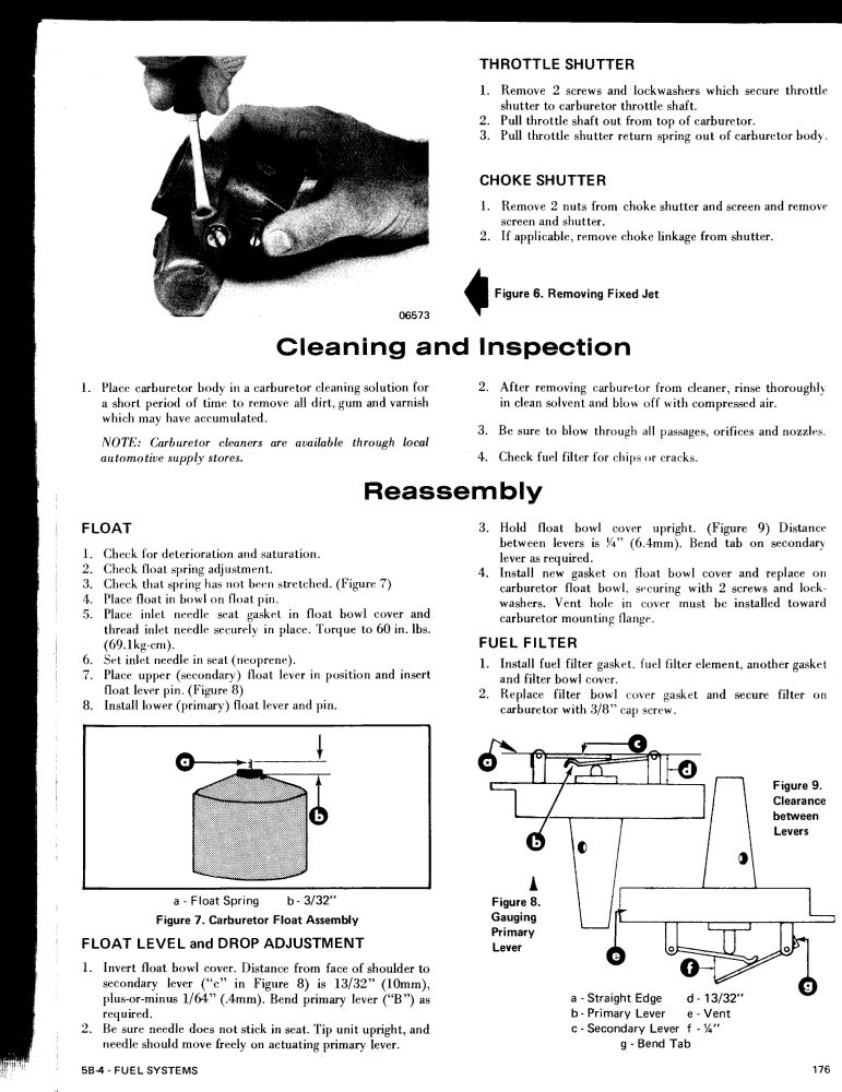

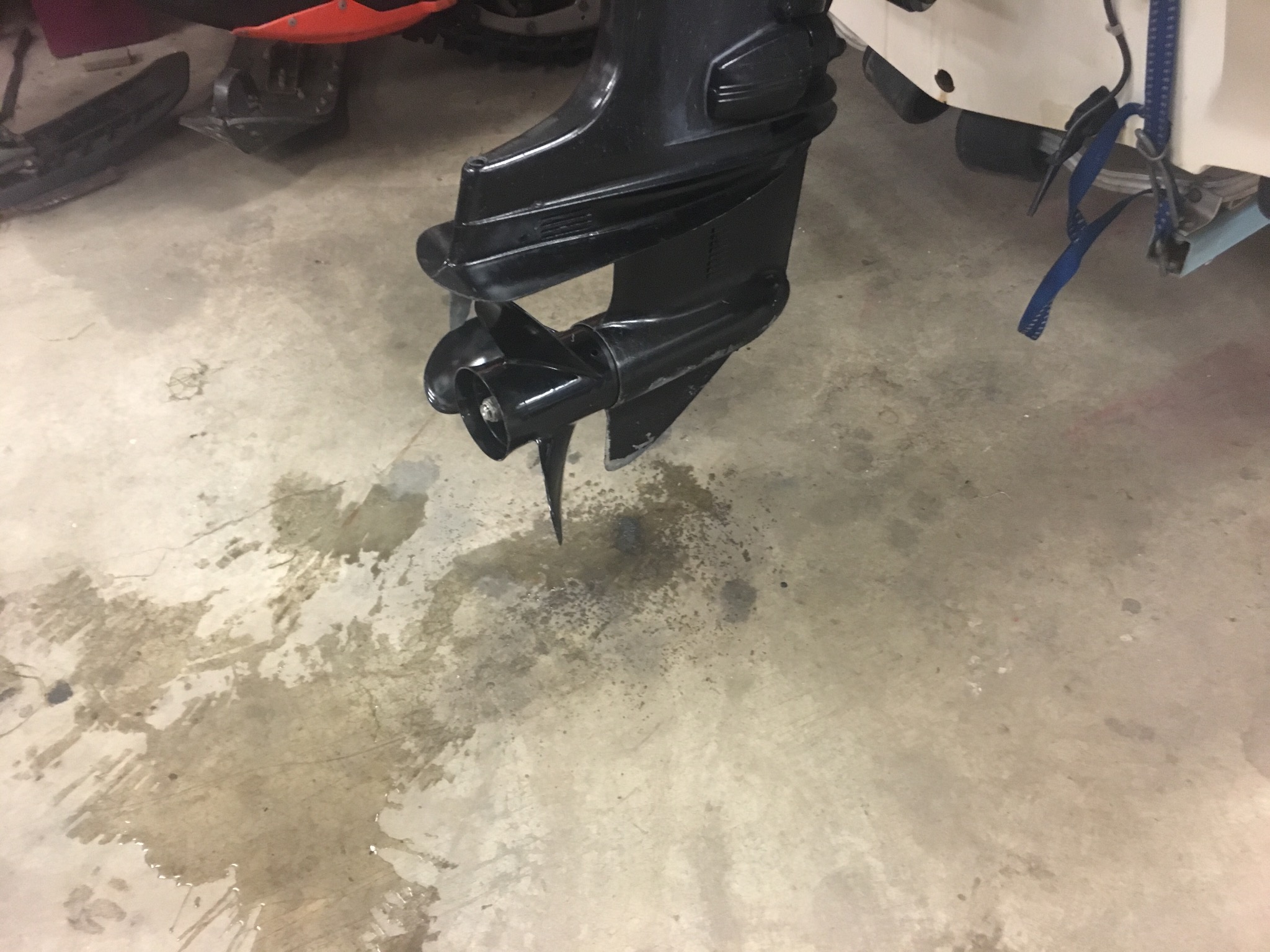

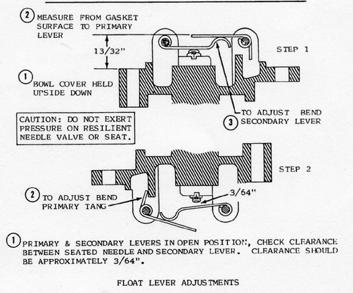

The drip might be caused by the wrong float level, or even a fuel-soaked float. Replacement floats are ethanol-resistant. Here's a carb breakdown with pics at marineengine.com:
www.marineengine.com/parts/mercury-outboard-parts/1250/2314956-thru-2839368/carburetor-assembly
Carb gasket/packing kit (which is usually all you need for carb work) on eBay for $9.79 shipped:
www.ebay .com/itm/Carburetor-Gasket-Kit-Mercury-3-9-135-HP-18-7006-1-Side-Bowl-Carb-1399-1717-/382045560573?epid=1223523448&hash=item58f3b09efd:g:Q6YAAOSwzqFY9G4J&vxp=mtr
This site parses eBay links, so copy, paste into browser, remove spaces and it'll work.
Also possible the needle/seat is leaking, you can get replacements for that too. See the carb parts list and then look up the part on eBay, it might have a cheaper shipped price. $7.95 flat-rate shipping at marineengine.com.
Some of the prices at marineengine.com are actually cheaper than what you'd find on eBay, and if you end up ordering a lot of parts you may wind up with a better deal paying the flat rate shipping charge. I find for just a single part, it's usually cheaper to order off ebay.

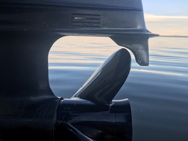

Any thoughts of how much clearance to the gear case housing the prop is suppose to have ? Should one drain the carbs for winter or is using fuel stabilizer OK?

The gap between prop body and gearcase shouldn't be so tight that it rubs. But actually the way it's supposed to work is that the turned-down portion of the prop body extends into the gearcase maybe 1/4" or even a bit more. You'll note that the inside of the gearcase has parallel grooves cast/machined into the i.d.
Those grooves and the close proximity of the hub to the grooves, form what's called a labyrinth seal. This effectively seals exhaust gasses from coming out of that area, without ever touching. The reed blocks are machined in a similar manner on their i.d.
en.wikipedia.org/wiki/Labyrinth_seal
Very common to see that type of seal on multi-cylinder 2-stroke engines, as it seals effectively and lasts a ton longer than a rubber crankshaft seal. You have to have some sort of sealing between cylinders, as the crankcase vacuum generated from one cylinder would otherwise effect the other.
Carl Kiekhaefer's engineers ingeniously designed their multi-cylinder engines to not only use the seal between cylinders, but to incorporate that into a reed block wrapped around the crankcase. A very novel design!
Anyway, so much for the labyrinth seal lesson! Let us know what you find down there...........ed

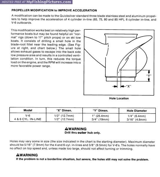

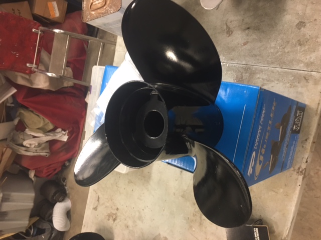

Dude, that's a HUGE ventilation hole I see in one of the pics, did the prop come with those?
What is that, about 3/8"? If so, WAY too big for an inline and likely your problem (along with prop fitment at the gearcase).
Did some rubber plugs come with the prop? Because I would plug those holes then see how it runs. As I was relating in previous post, when I drilled huge holes in the prop on my brother's Merc 1000, there was so much slippage it would never gain speed. Barely got on plane. Note that the Merc TSB recommends starting out with a 3/16" hole with a max of 5/16".
If the hole size is an Optical Contusion and they're actually smaller than 3/8", I would still plug them and see what that does.
BTW cupping does increase effective pitch, so in going from uncupped 19" pitch to cupped 21", you've increased pitch and then added cup; it should have a drastic effect on speed, providing the motor has enough hp to swing the prop at speed.
If you for example had bought a 19" cupped prop, it should be faster than your uncupped 19" prop, all things being equal. But should still have a good hole shot, because cupping has a minimal effect on the low-end. However at higher speeds the cup does have effect. A cup will also hold better in corners, with less ventilation.

Hello , those were the vent holes that came with the props, they were both the same. They are about 5/16", that is the prop listed for my motor, I will try the snap on sleeve and see if the prop still fits with out rubbing. I guess I could Steel epoxy over the holes and drill them out smaller to 1/4" and see if that helps. I am hoping the problem is the nylon snap on ring that goes on the back of the prop. Thanks for your thoughts...Brad

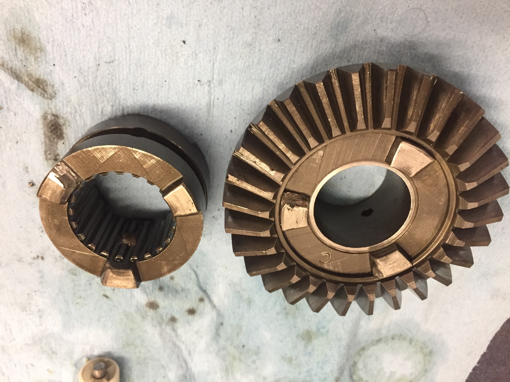

Mercury 1250 9 years 1 month ago #134015
  • Meteor
  • Meteor's Avatar Topic Author
  • Junior Boarder
  • Junior Boarder
  • Posts: 70
  • Karma: 4
Currently Neutral is at the back side of the Neutral gate, forward engages instantly going forward way before the throttle and the linkage is maxed out pushing the shift lever to the back of the slot. initially in reverse it wouldn't even try for reverse , only after I maxed out the shift linkage going backwards would it try to engage reverse. It worked fine before I changed the water pump so I think I must have something a skew.

Well Ed , I have checked out your suggestions and it looks like the prop clearance to the gear case housing must be the problem allowing constant air around the prop. I checked the gear ratio and it is 2:1 as it is supposed to be . The prop had allot of clearance as you noticed, I should have been smarter as when I compared the new prop to an old Merc prop it was much smaller diameter in that area. I snapped on the ring that came with the prop and problem solved even though my motor was not on their list that the ring should be used, obviously it needs it..Hopefully this pulls my RPM down and the speed up. I don't think the boat will hit the water again till next year now but thanks for your advice, knowledge and keen eye.. most likely problem solved... Brad
