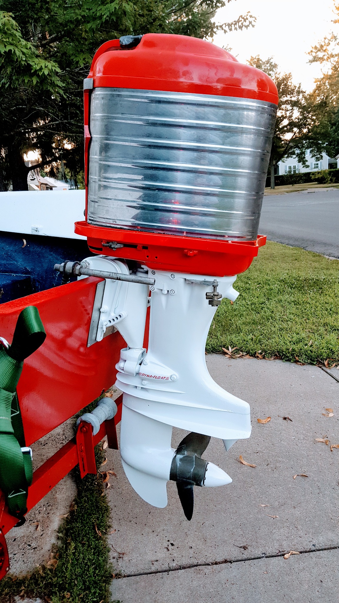

Ok still plugging along on this motor.. replaced timing belt, fuel pumps, plugs, lower end lube, impeller.
Pumps fuel and water. Turns over fine.
Starter button doesn't work and no spark on all cylinders. Are these related problems? I don't read power at the coils or resistors but there is continuity. I have power at the solenoids. Solenoids turn motor when hooked up directly to battery.
