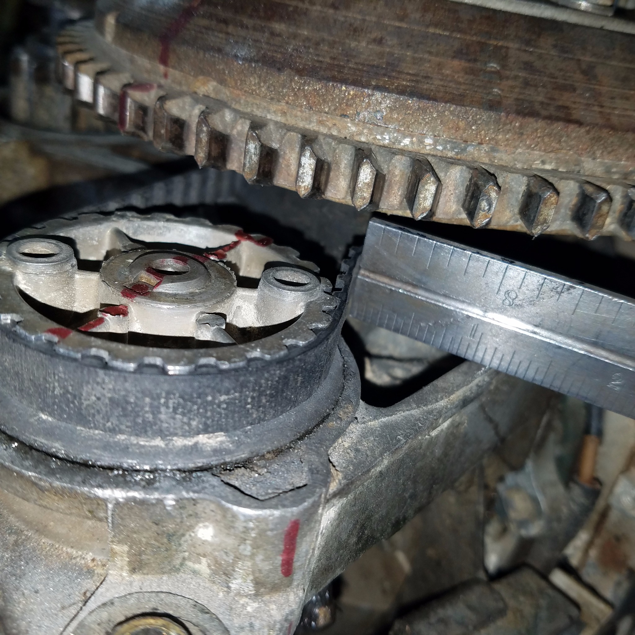

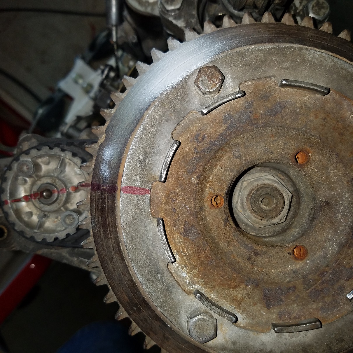

Decided to recheck former ignition settings. I am pretty certain
Crank to Distributor timing is off, I think the belt has slipped. Need 2nd opinion. The first pic is out of manual showing correct timing. 2nd pic is showing how it is currently set with timing marks aligned. 3rd pic shows what I think it should be if timing marks were in alignment and in alignment with center-line of crank and distributor as per factory pic. Pic 4 and 5 show how loose belt is. Pic 6 is belt part #. Motor sat for 10 years before I started it up. Maybe belt lost its elasticity or was installed wrong to begin with.
Larry Chase in Idaho

1958 Mercury Mark 78 won't rev past half throttle 9 years 3 months ago #133154
to install the belt just bring top cyl to top dead center. then aim the arrow on the did pulley at the crank don't worry about the marks. the arrow is hard to see but is on one of the webs.

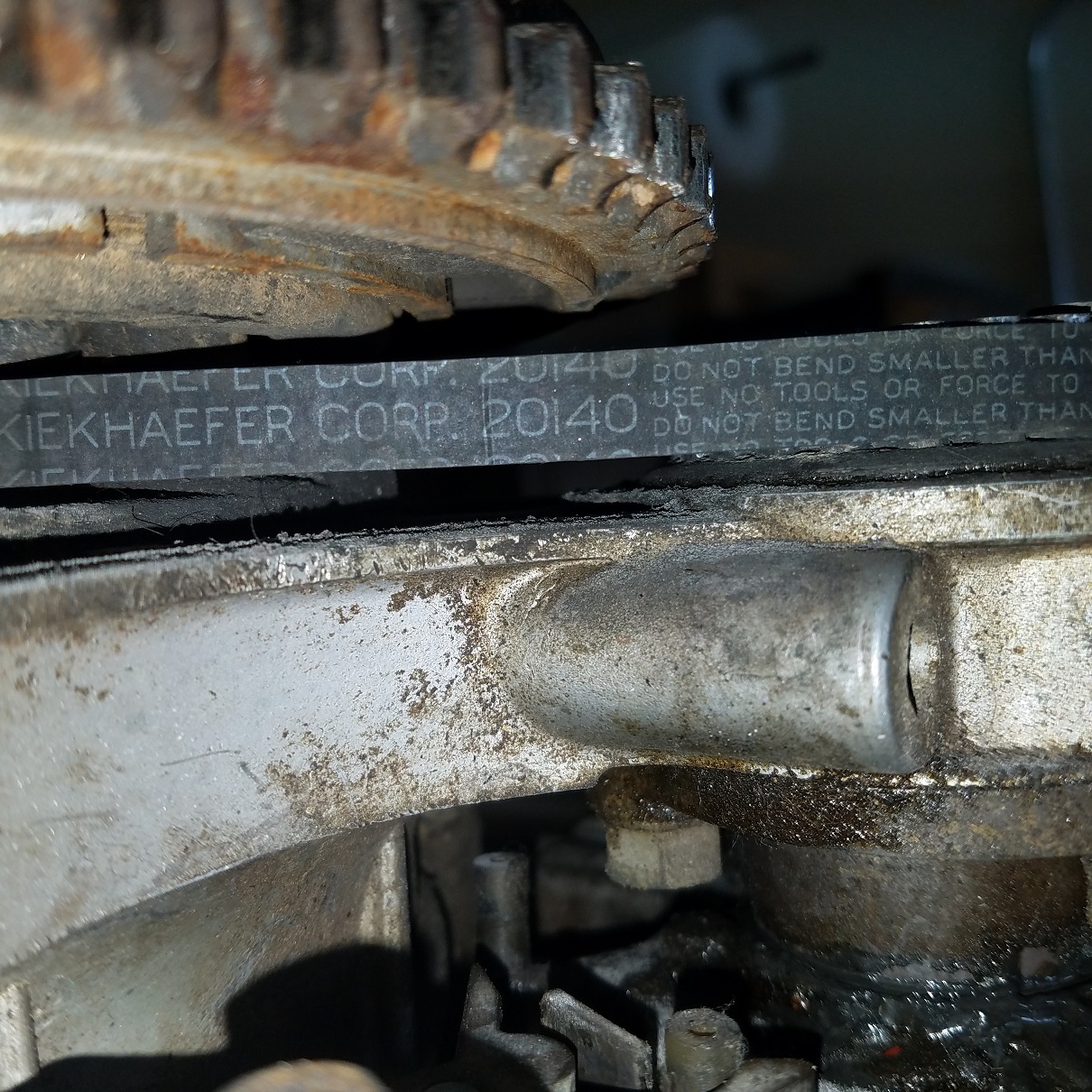

These are the pictures
1958 Mercury Mark 78 won't rev past half throttle 9 years 3 months ago #133172
It still looks to be one tooth off in the last picture, but it might be because the belt is so loose.
The belt is a lot looser than any I just checked.
Is there any sideways play to the flywheel or the top of the distributor?
doc

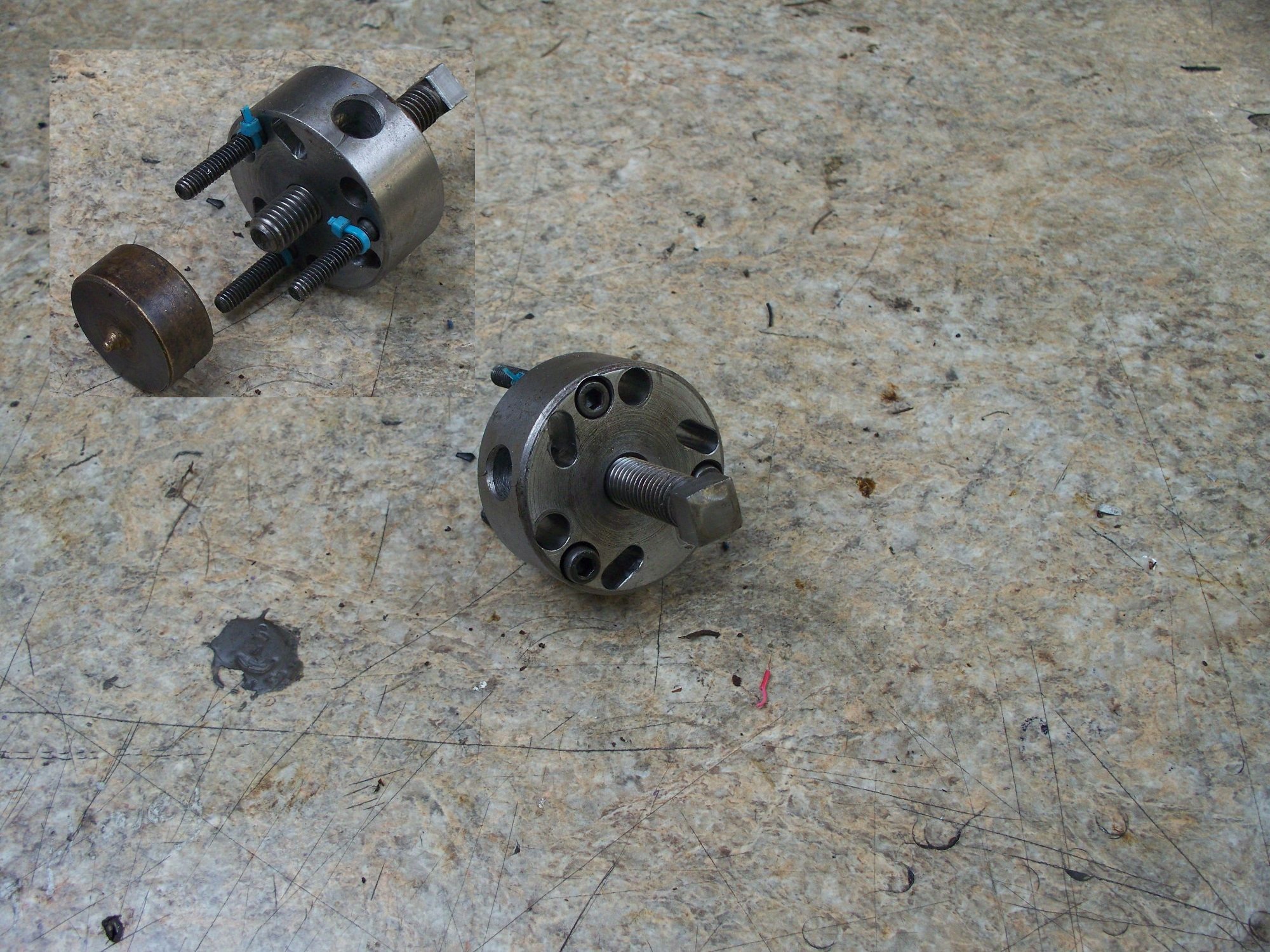

Thanks for the reply. We ordered a new belt and will set the timing correctly and see what happens.
The flywheel is on their TIGHT! we've tried a steering wheel puller. is there a trick? or just keep working at it?
1958 Mercury Mark 78 won't rev past half throttle 9 years 3 months ago #133183
Well,...Remember,...You asked :)
I'm a wee bit off the charts on some of my "techniques", so you may want to wait for further insight.
BUT,...I really load up the puller to the point that it surely will self-destruct.
I use grade 8 cap-screws, and I place a brass bunion between the end of the crankshaft & the puller.
When you would swear that something is going to bust,...The flywheel will surrender - sounding like a 30.06 going off.
I have been known to smack the puller's center bolt with a large hammer too, but that practice is commonly frowned upon.
It works though, but the concern is the risk of fracturing the crankshaft. I haven't yet, but that is the concern.
I've considered applying MAPP heat to the flywheel while the puller is loaded up, in an effort to expand it away from the tapered crankshaft, but haven't done that,...very often.

Thanks again for the continued help.
I finally got the flywheel to surrender this morning. I loaded the puller like you said and just kept at it till it popped. Now to wait for the new belt and hopefully we'll be on our way!
