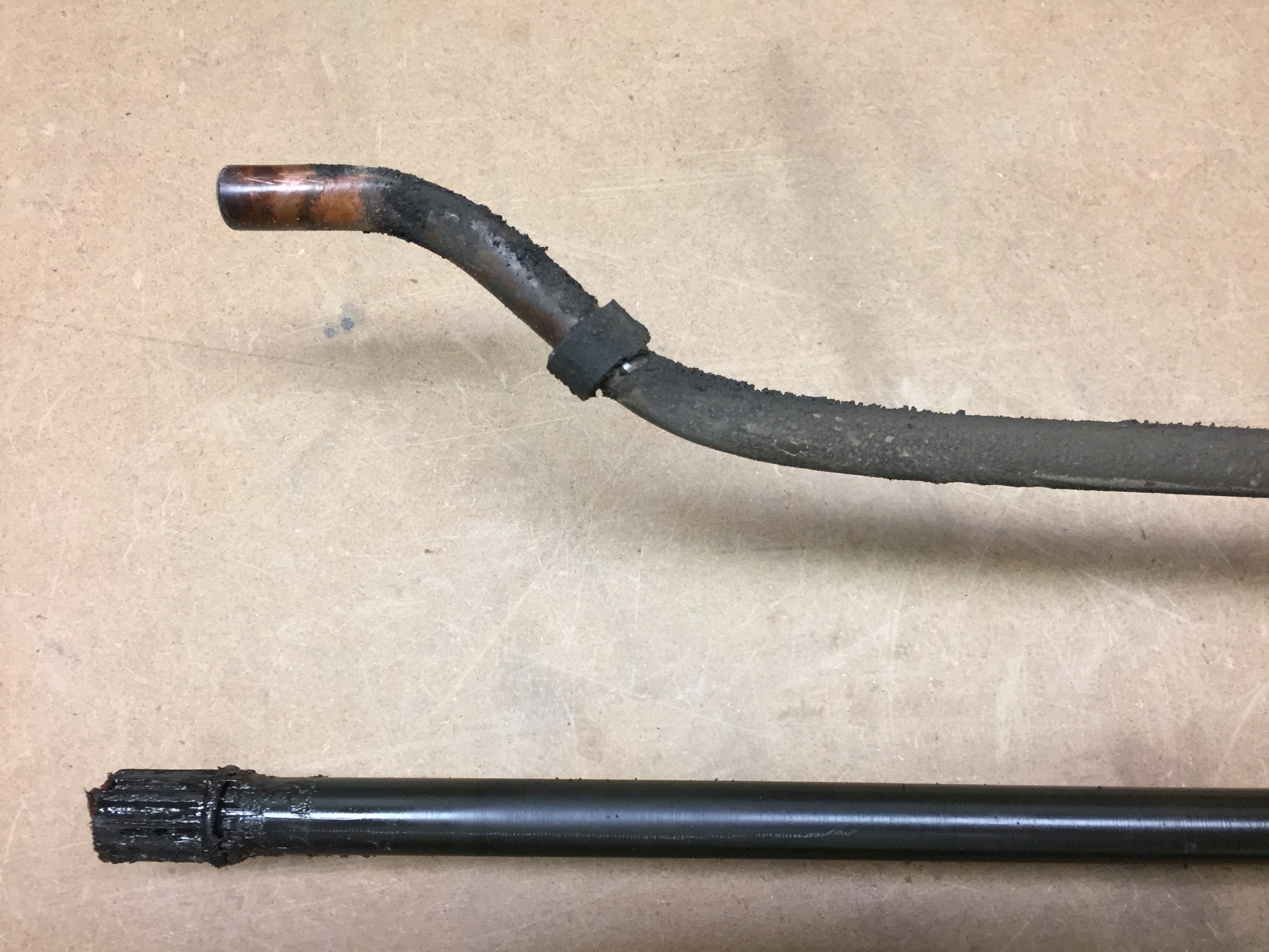

Just a quick question after removing my lower unit. What guides the water tube back into its socket in the power head when you reinstall the lower unit? Is there anything special I need to do? Also, that rubber sleeve that is down at the bend in the water tube - should that be up near the tip? (See picture.)
Quick Question: 1960 Merc 400 Lower Unit R&R 9 years 4 months ago #132505
take the tube out of the lower then install it in the powerhead. then install the lower.
Quick Question: 1960 Merc 400 Lower Unit R&R 9 years 4 months ago #132537
Dave,
Thanks for getting back to me. I did give the water tube a pretty good pull and it didn't seem to want to come out of the lower unit easily. It's just a press fit in that rubber bushing? Or if it doesn't want to come free, maybe I should just try to reinstall as is?
Also, I should be able to look up into the bottom of the power head and see the female receiver for the water tube? (Sorry, but my boat is up north and I can't just go out and take a look.)
Any thoughts on the position of that rubber bushing in the picture - I'm assuming it should be up near the top to seal the water tube into the power head?
Thanks,
Gadabout
Quick Question: 1960 Merc 400 Lower Unit R&R 9 years 4 months ago #132541
you must pull it out of the lower unit. and put it up in the power head. no way to install it the way it is. use a vice grip lightly on the tube and uwse wd40 to lube it . it will come out.
