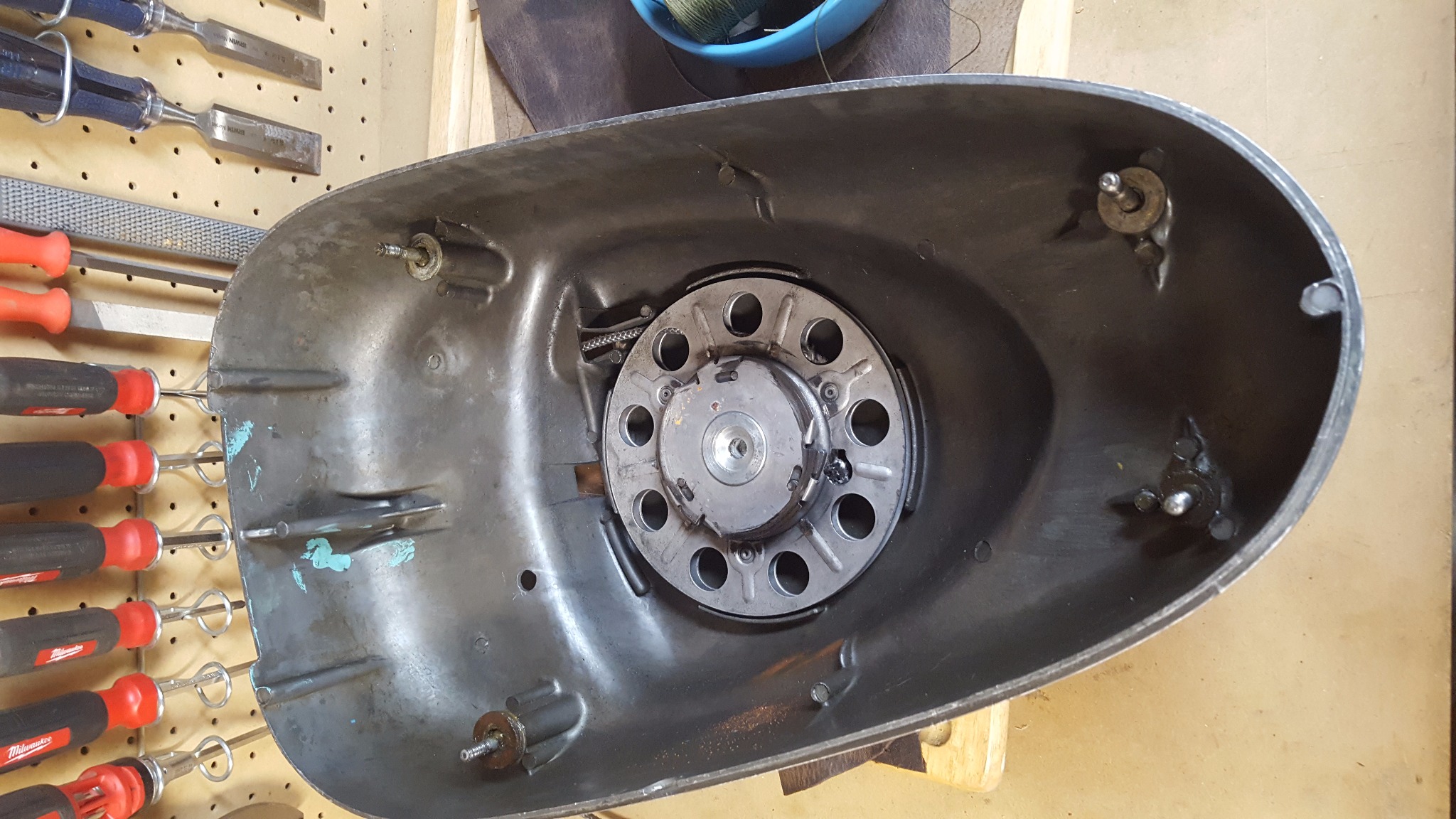

Thanks for the help guys. I have the top cowl off but don't see an easy access point to get into where the return spring would be. I have the assembly sheet printed out from this website .
Where should I be looking?

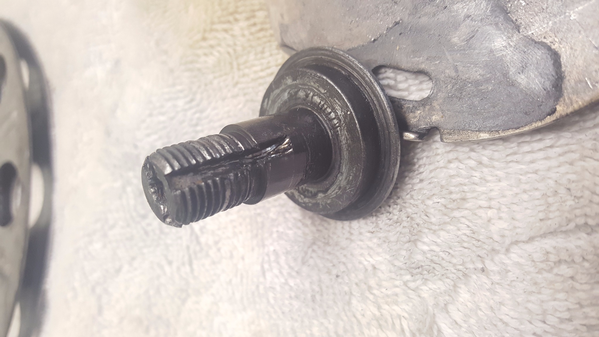

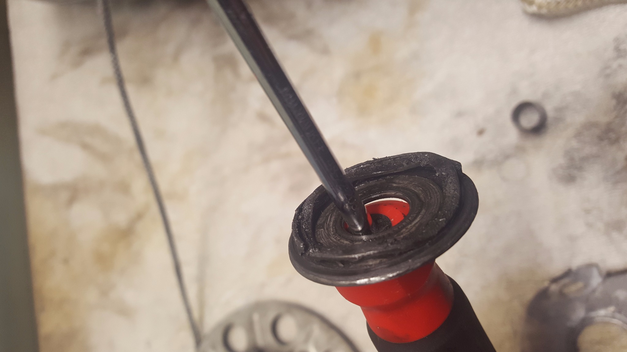

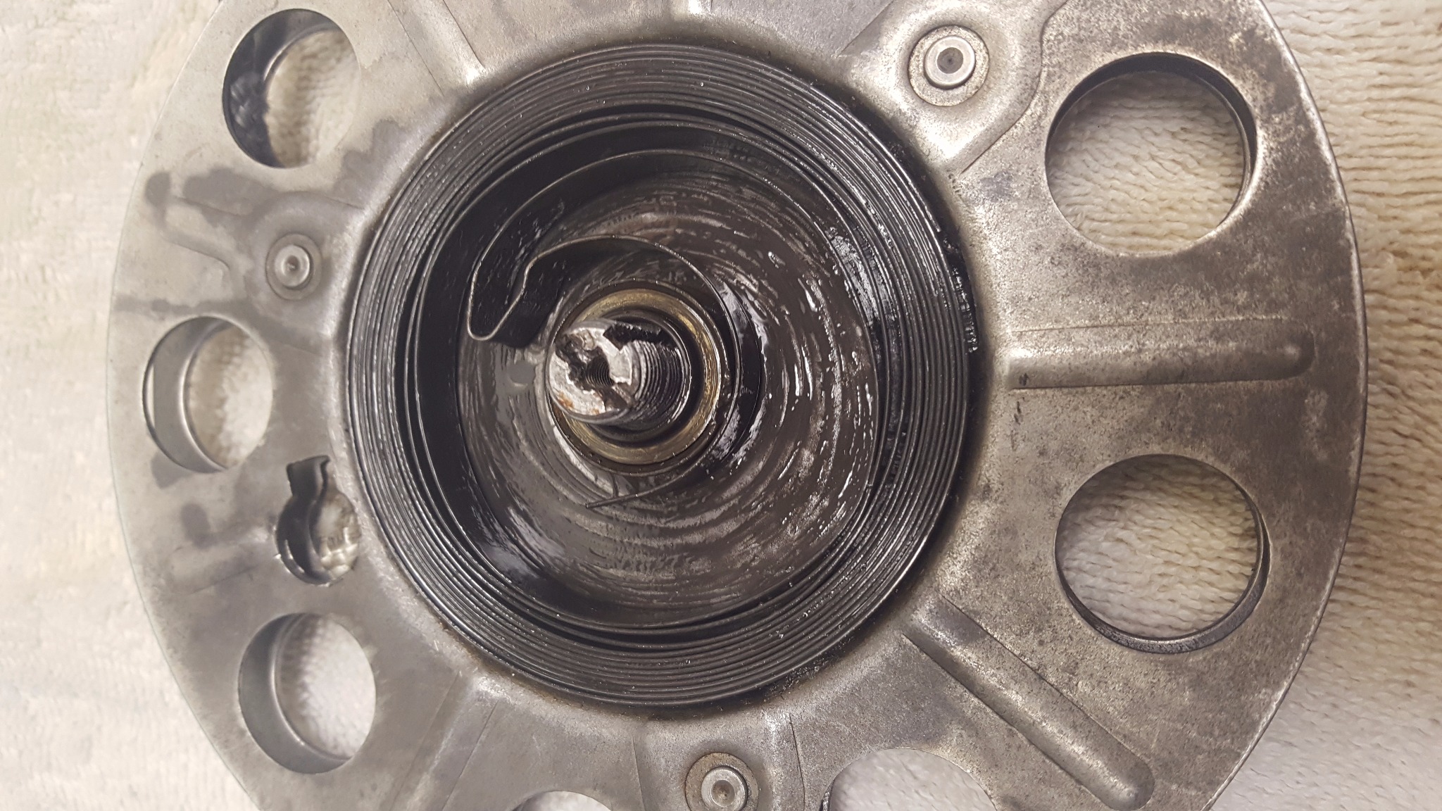

Thanks for the advice. I was able to get everything taken apart tonight and found a few issues. Click here for an album of some pictures I took but I've attached the ones I think may been causing problems.
Can you guys help me spot the culprit(s)?

I'm thinking new rewind spring like Dave mentioned.

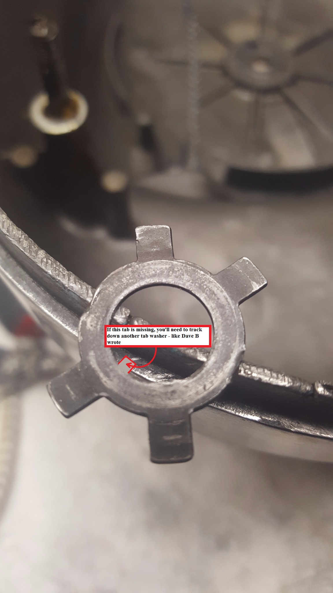

was there tension on the spring? if not the problem may be the tab washer under the nut. look at the center of the washer and see if the inner tab is broken off.
I just looked at the tab washer pic it is broken and you need a new one.
