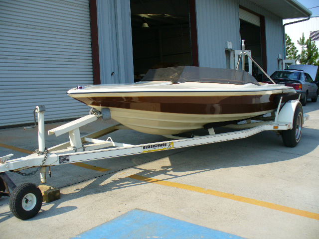

Hello,
It made me smile to read of the Cee Bee Avenger, as my family was a dealer for 30+ years. We have both a 16 foot and 16 foot, 7 inch The Avenger models ourselves. As to the compression and ignition testing, I would suggest that the internal engine wiring harness's red and white leads should be disconnected, and you should provide jumper wires directly from the battery (+) terminal directly to the red and white studs on the switchbox (ignition module) with the (very) rotten wiring pictured. Yes, one does need to know compression and ignition, but taking the risk to "blow" costly components when doing so should be avoided. Similarly, the two yellow AC voltage input wires to the (battery charging) rectifier should also be disconnected first, as the rectifier will very likely "blow" otherwise. The compact compression gauge mentioned is available if desired, but reasonable care when installing a compression tester which features a rubber hose can be utilized. Finally, we would be happy to quote parts, as we sold Merc 1350 models when new, and we were a Mercury dealership for 50+ years.

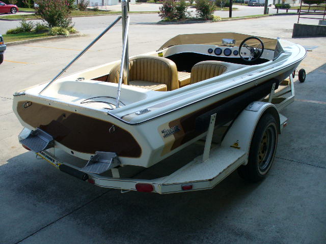

wow! thats a really nice boat! If I can get the motor restored and the hull checks out, I foresee us needing a towing pole like you have. My mom used to water ski behind the boat, but it has no towing tower, they must have used a rope with a V or something?
The only really obvious rotten place my inexperienced eyes see is the battery box mounting area. Even though some of the fiber glass in the floor is thin and obviously permeable, when poking it with a screwdriver it seems solid. Of course it hasn't been in the water in 30 some years, and only sometimes got wet from the rain. The upholstery is shot, as is the gold metal flake paint. The engine controls and steering will probably need as much work as the engine wiring harness...
My mom asked me to see if I could get it to run before she dies, but then shes only like 72... Hopefully I'll have some time to work on it this week and report back! Is there any easy way to get fuel to the carbs if the gas tank and lines are missing?
